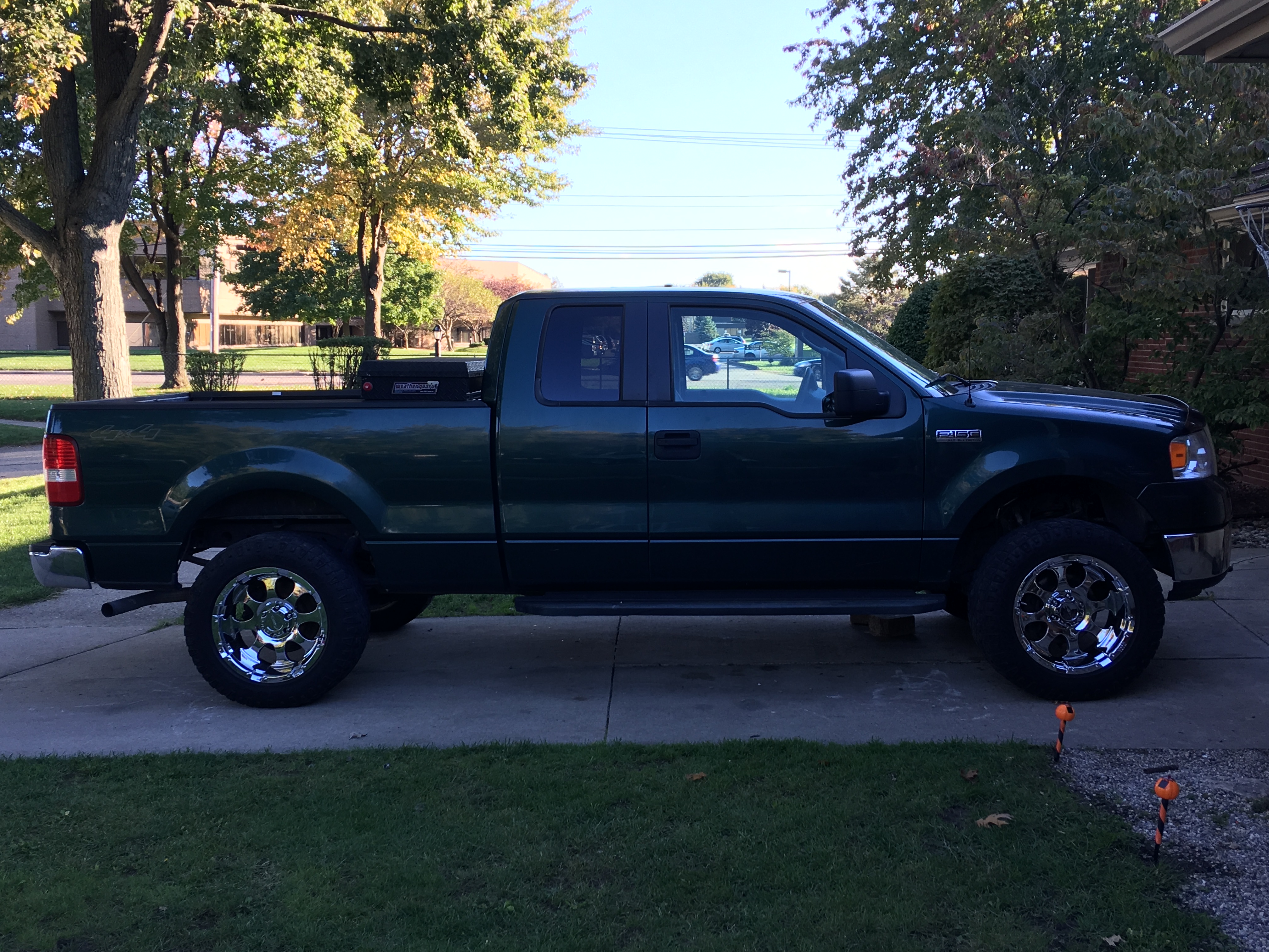

here's a pic of it with leveling kit and wheels from my 05
