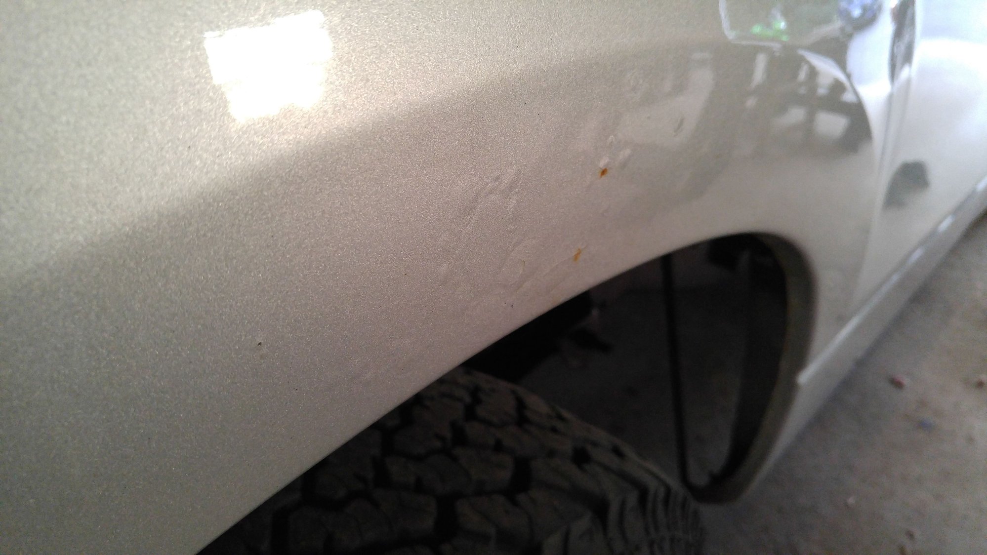

Those are small areas. The wheel wheels would need new metal. Those rot from the inside on the top of the wheel well arch. You have to spray up from under the rear bumper to clean that area out. There's a little gap in there.

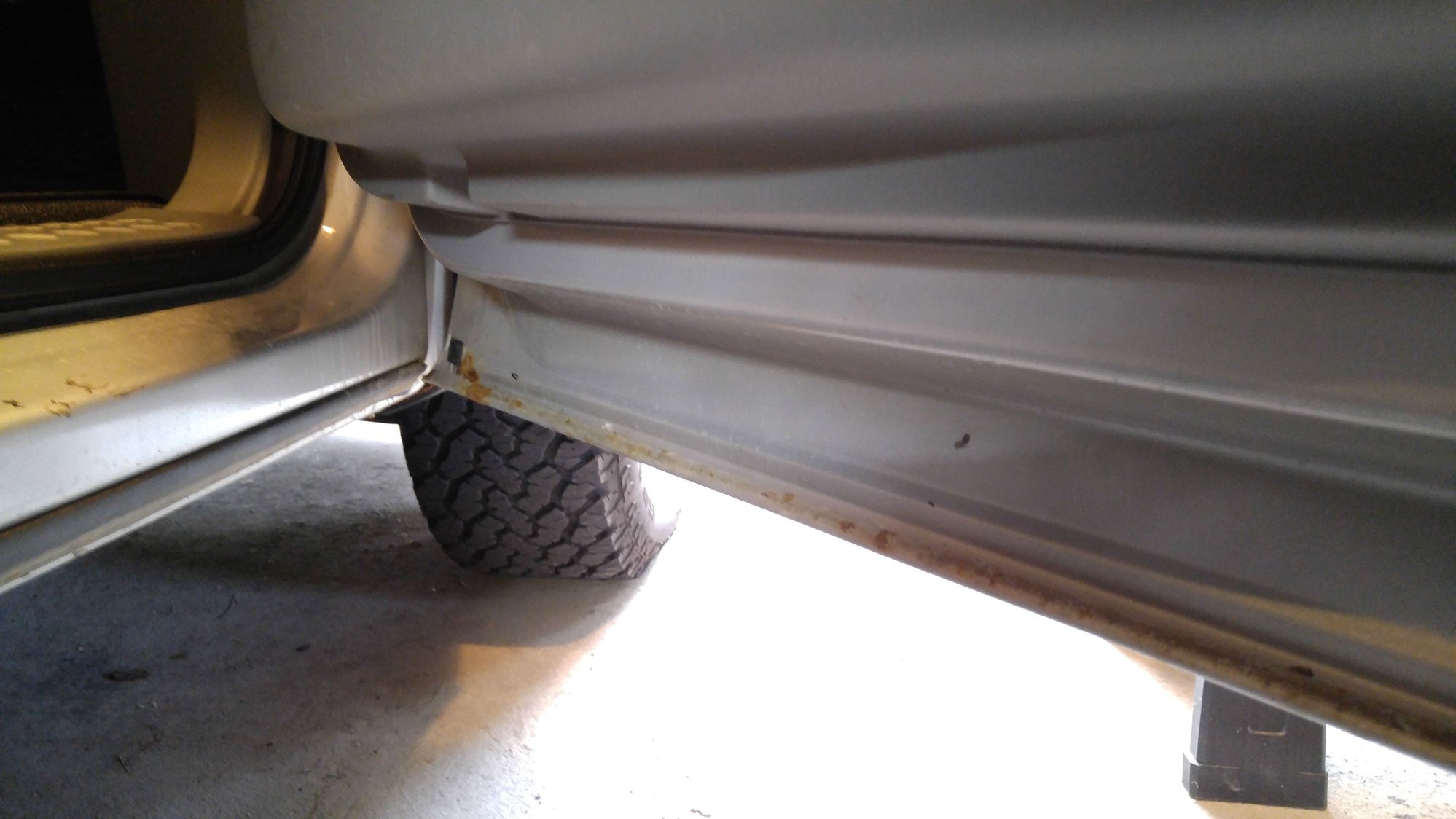

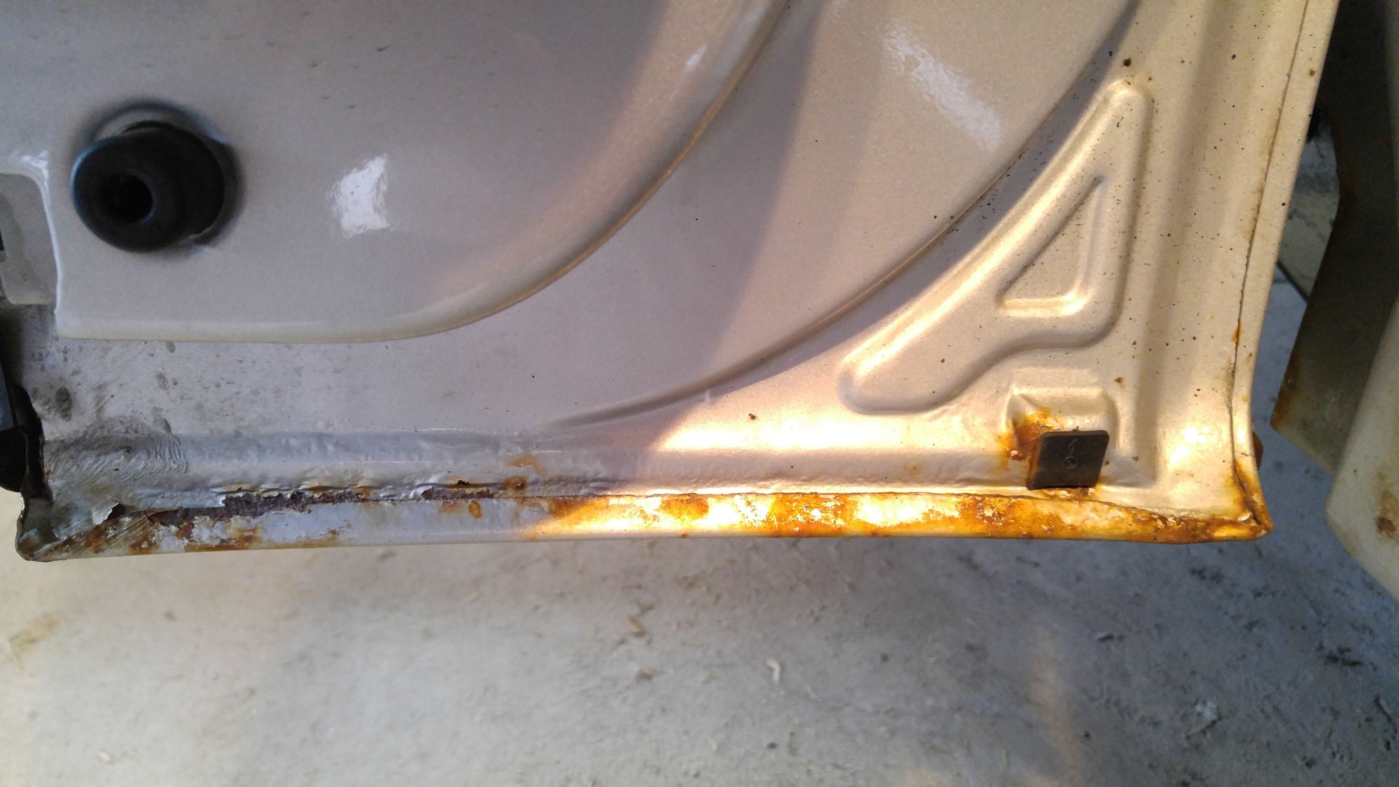

For the doors, blast that bottom seam with a high pressure hose all winter long. Spray some oil in them. Doing them has kept mine rust free.
For the front area, take off that bottom plastic piece that's held on by those two screws. You'll be surprised what you find behind there.

Above you can see the rust pictures. It is not too bad, but I can see in a couple years getting worse.

You asked for opinions, so I’m going to offer mine. I will note that I supervised the Paint Shop for a major manufacturing operation as one of my past jobs. So my opinions will be based on cold, hard facts as opposed to somebody’s personal experience.
First, the bad news. Basically, once rust starts on your vehicle, it’s very, very hard to stop it. Why? Two reasons. First, it’s very, very hard to remove all of the rust. You’ll never get all of it off by simple sanding. You’ll get more – but not all of it – off by media blasting. Even dipping the entire body in various chemical baths will not get to the rust that’s invariably in between the panels and seams. And any rust that you don’t remove will come back to bite you in short order. Make sense?
Second, most of your corrosion protection is achieved from coatings that come both from the steel mill on coils of steel and the electrodeposition primer applied by the vehicle manufacturer. Together, these coatings (and the pre-coating steps that clean and prepare the metal for the coatings) are impossible to replicate in any body shop. (The electrodeposition primer tank we used had five separate cleaning and pre-primer steps just to insure that the e-coat itself had a good base to stick to.) And once you sand, blast, chemically strip or otherwise remove this primer, you’re never going to achieve the same level of corrosion protection with a sprayed on primer that was preceded by a simple solvent wipe. (And that’s all you’re going to get at any body shop.)
Could you replace body panels such as whole doors or quarter panels and do better? Yes and no. If you buy a Ford OEM door, it will come with the same factory electrodeposition primer that I mentioned above – which is great. So will the quarter panel, but your body shop will grind right through that critical primer in order to get a surface that they can weld to. The door might end up lasting pretty well, but the quarter – wherever they removed the primer – will not.
One critical overall thing that will be missing from any body shop paint job – even if they did everything else just like the factory (which you now know they cannot) – is Process Control. One can argue that some OEM paint jobs should never have been allowed to leave the factory, but the level of Process Control they were a product of will never, ever be achieved by any body shop – period. Not gonna happen. So the variability of the processes used will be all over the map - and so will the results. So kid, are you feeling lucky?
One last note. Many body shops are capable of producing absolutely stellar looking paint jobs. There is however a huge difference between how a paint job looks and how it performs in terms of corrosion protection, chip and fade resistance, etc. I’ve seen some awesome looking paint jobs fall off in chunks of rusted metal a year or two after they were applied. Sure, some shops offer “lifetime” warranties on paint / collision work. Read the fine print though and you’ll find that their definition of lifetime doesn’t match yours at all.
So what’s my recommendation? Go ahead and paint it if you want, but it’s not going to last at all if you continue to drive it in the salt. I’d suggest applying that money to the down payment on a new truck. It’s a much better investment.
