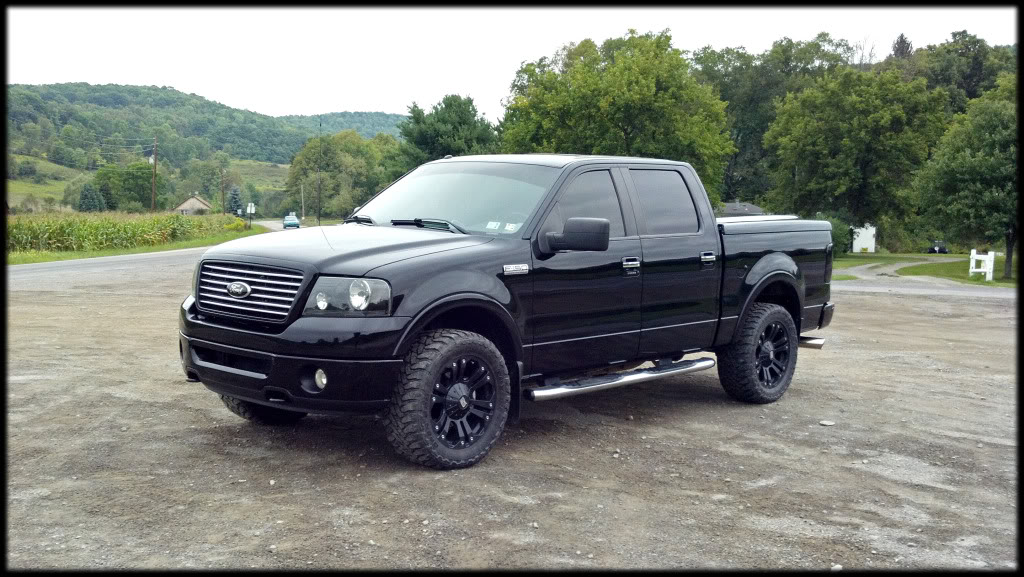

Here is my truck on 20x9, +18 5.71" backspace wheels with no leveling kit at all. It cleared perfectly fine with 33x12.5 Toyo M/Ts. No issues with the brake calipers.
