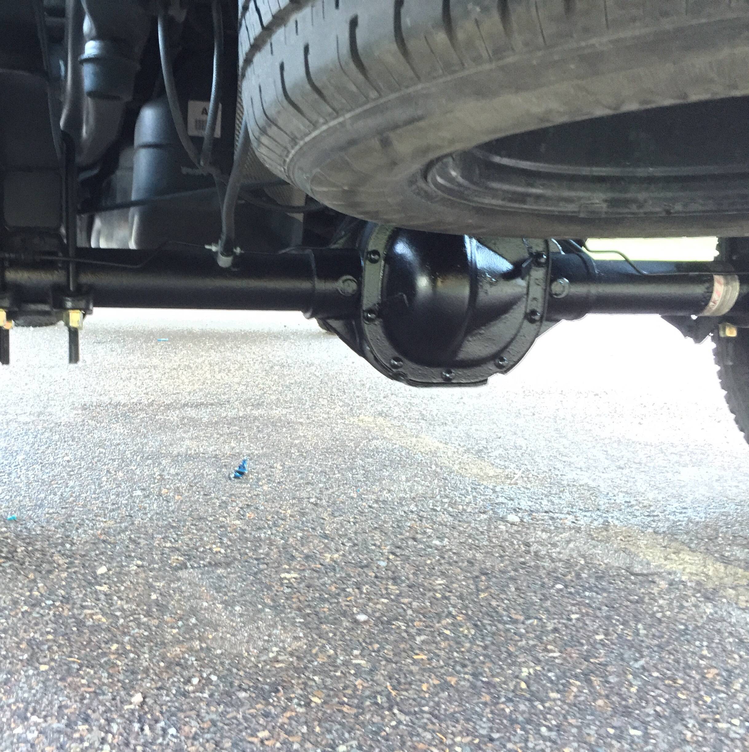

He had to ask how my undercarriage was so clean and freshly painted looking haha.
He was flashing his high beams for a couple miles, I thought there was something wrong withmy truck or he was being crazy. I eventually slowed down and he pulled up on the side of me and said:
"Sorry to pull you over in the middle of the road, I just have to know who paints your undercarriage or how it's done. That thing looks *******ing amazing."
I though he was going to pull a gun out at first. It was night time, we were on a main road and he'd been close behind me for 10 miles.
Figured this was the only place I could post it where anyone could understand. Ha
That's all, weird night. Guess my clean undercarriage stands out!

So what is the secret then to keeping the undercarriage so clean even after 6 winters?
Old Dec 29, 2014 | 10:38 PM
2008_XL's Avatar
Joined: Oct 2008
Posts: 3,121
From: Burlington, VT
I pressure wash the entire undercarriage weekly at the self serve carwash bays during the winter months (November - April). Every spring, I put a coat of Rustilium from a rattle can. Other areas I treat with white litheum grease in the winter and that prevents rust.
It actually not a crazy amount of work for how nice it keeps the truck looking.
