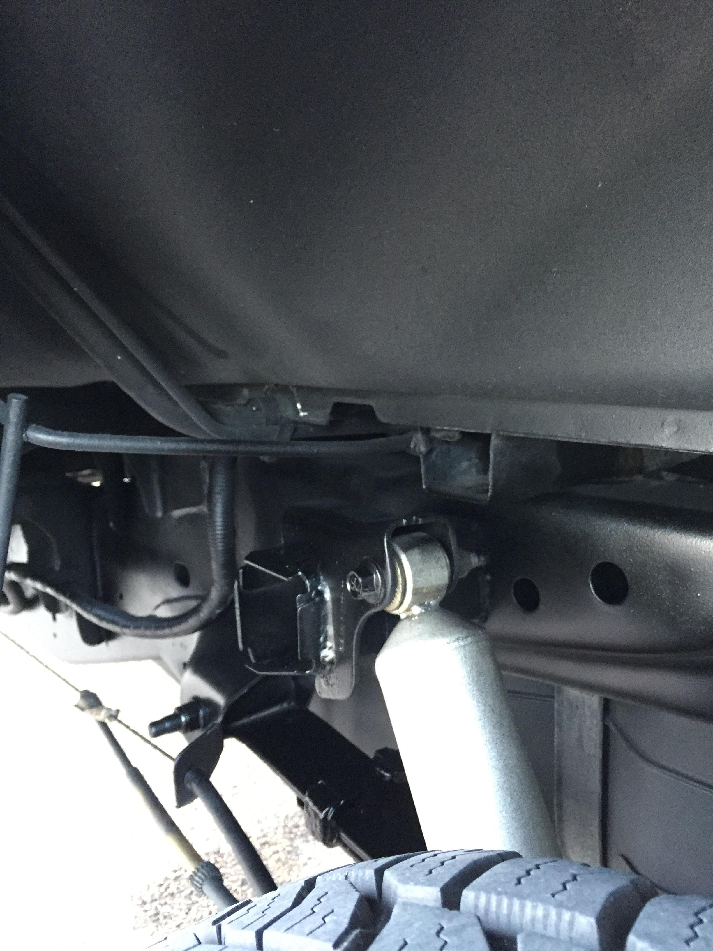

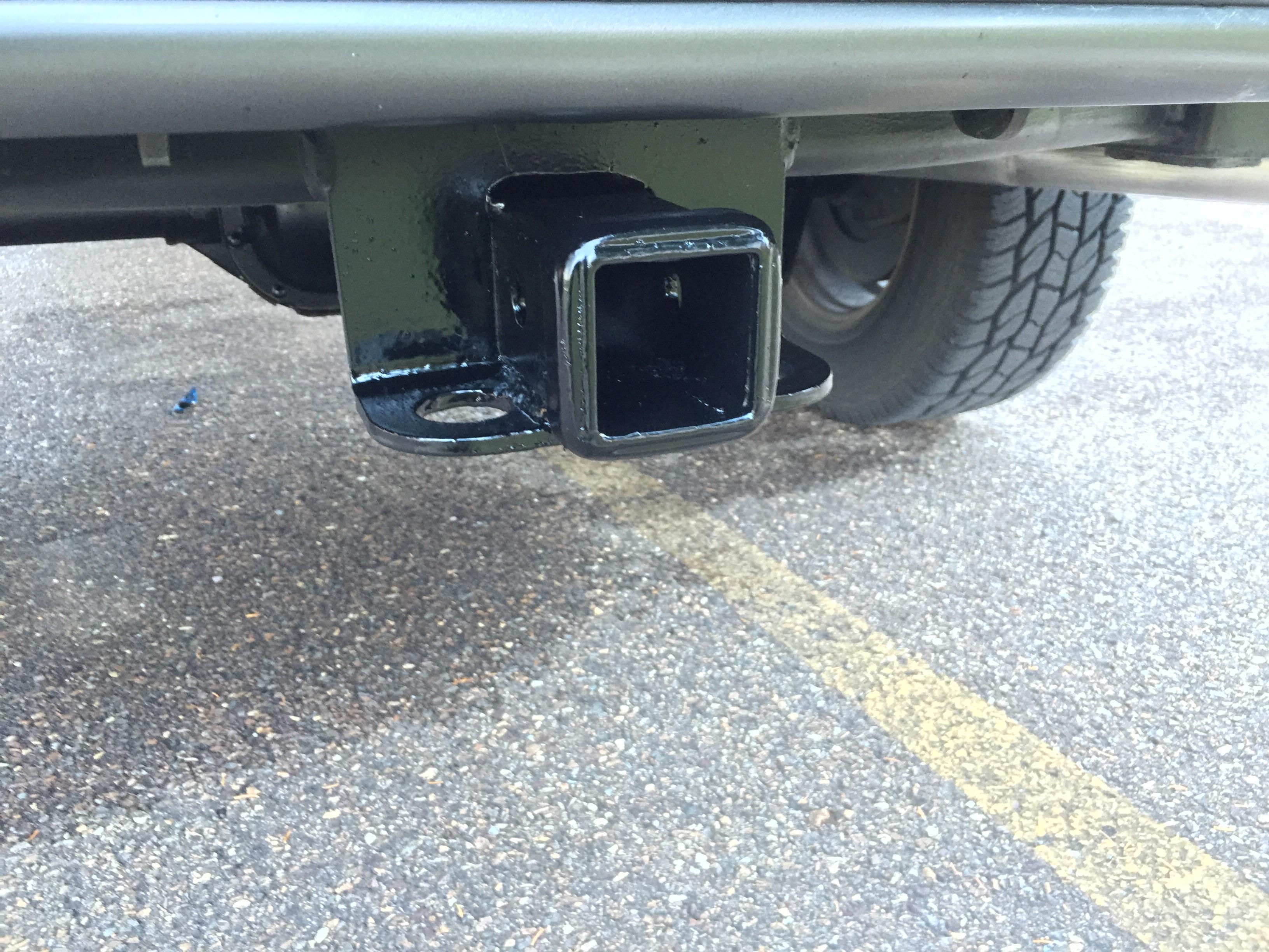

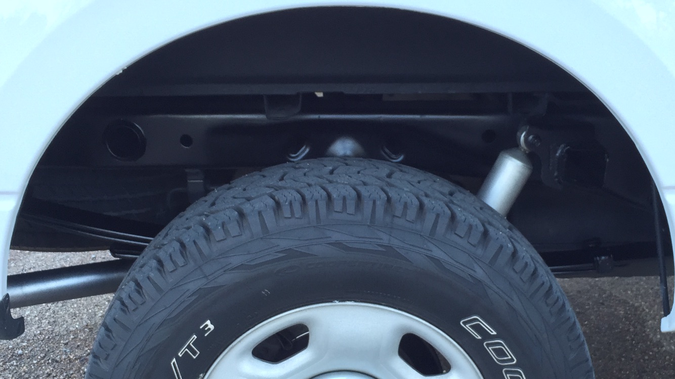

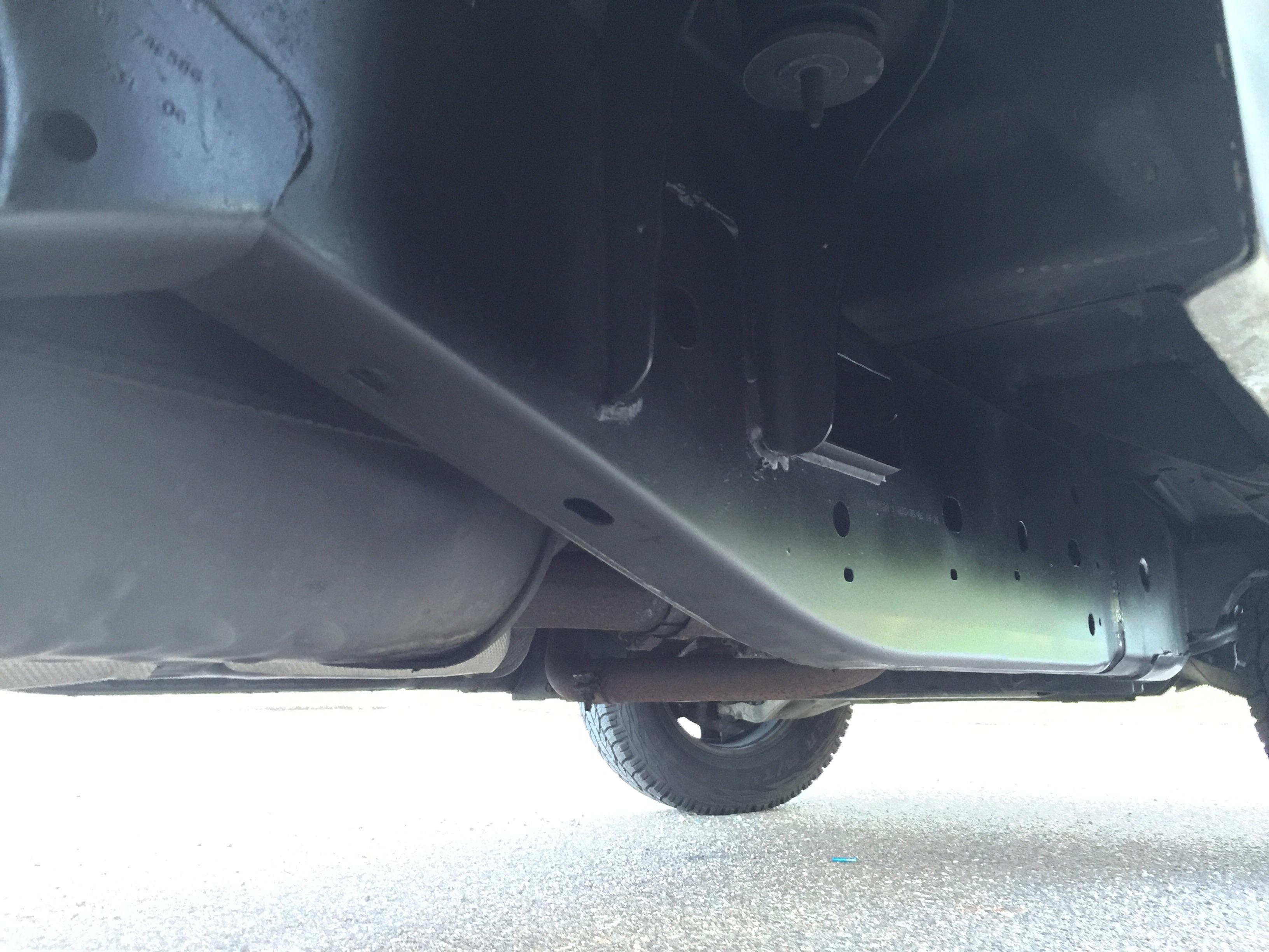

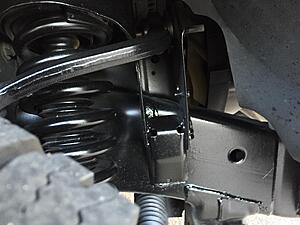

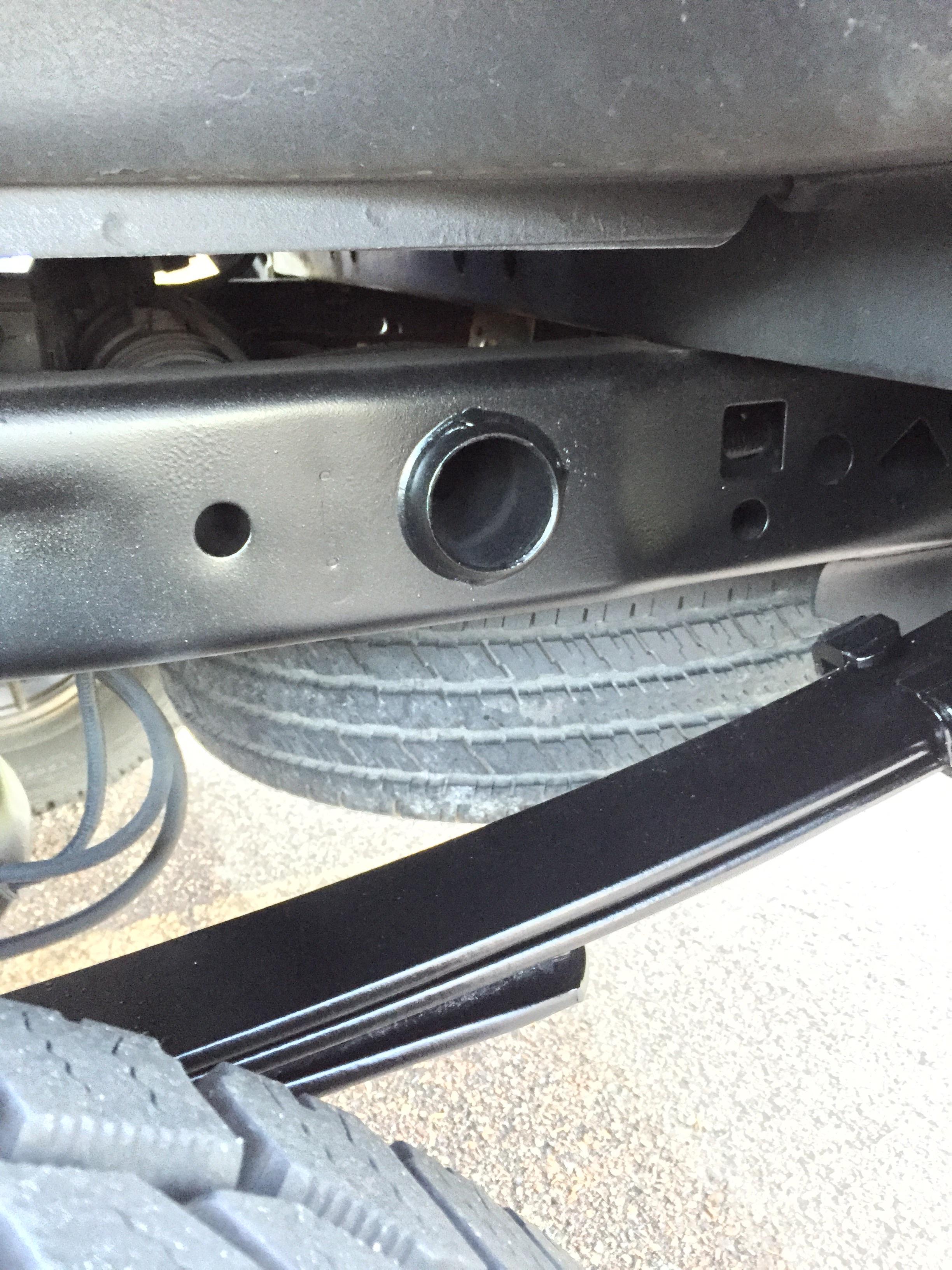

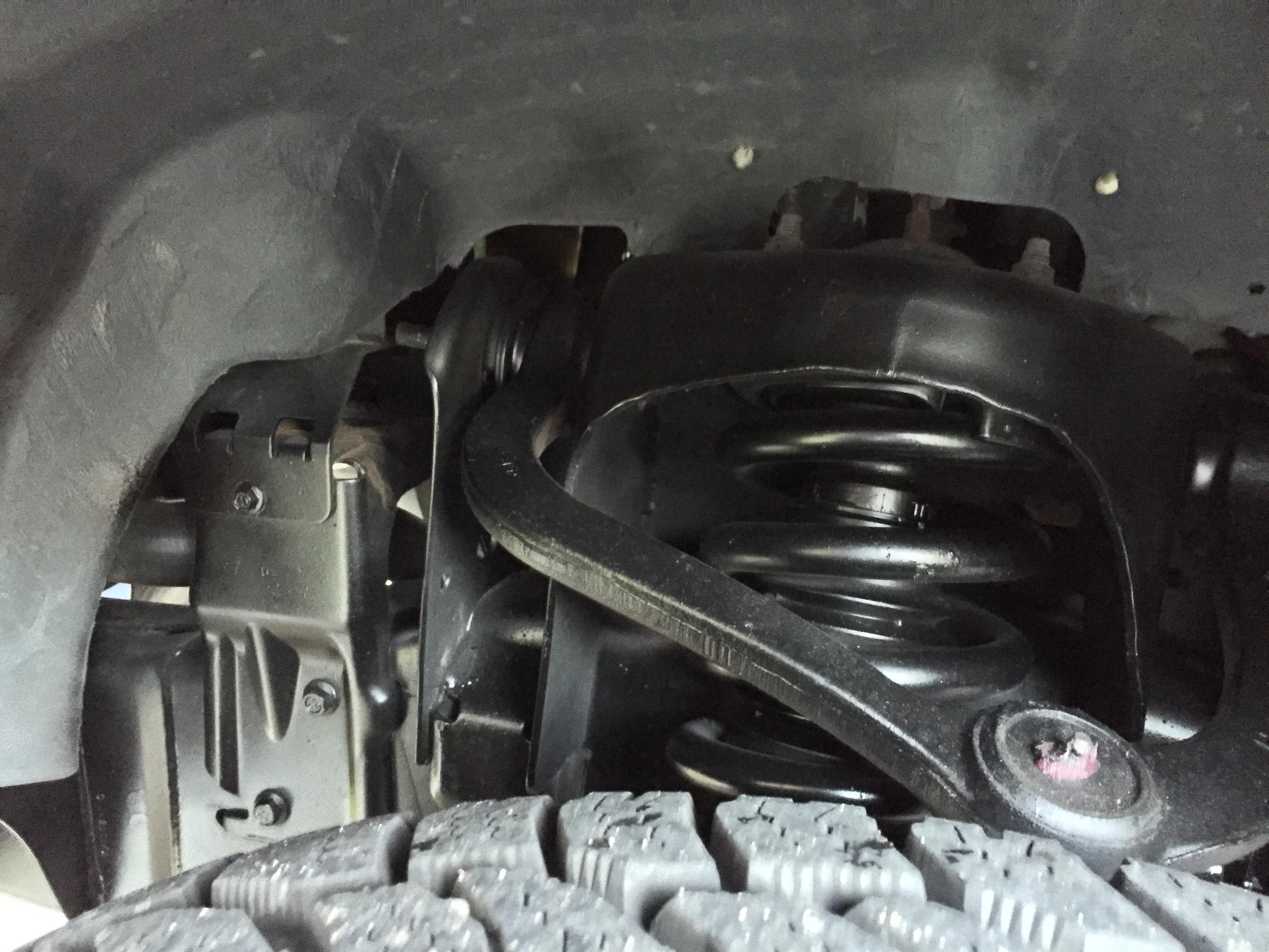

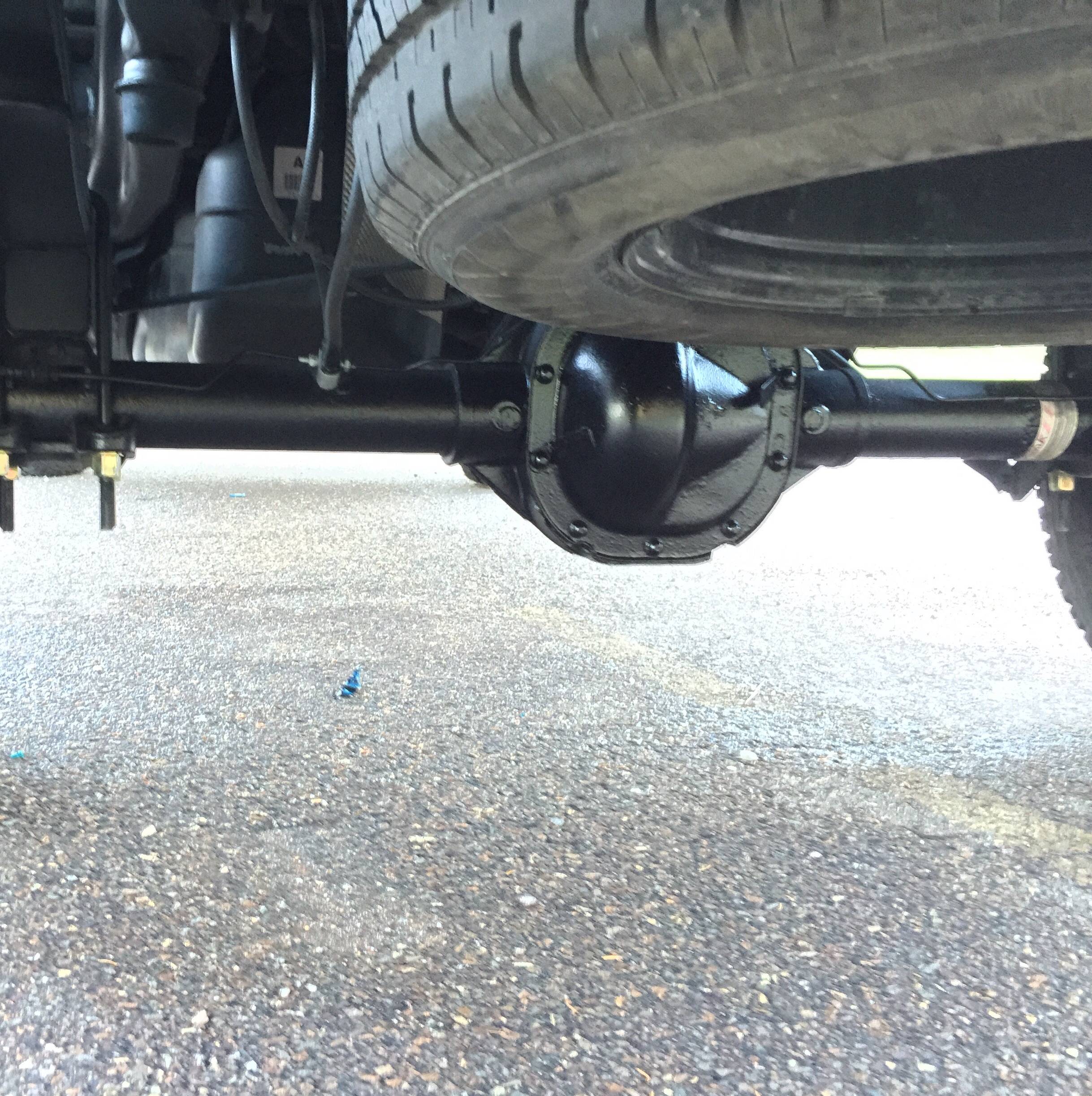

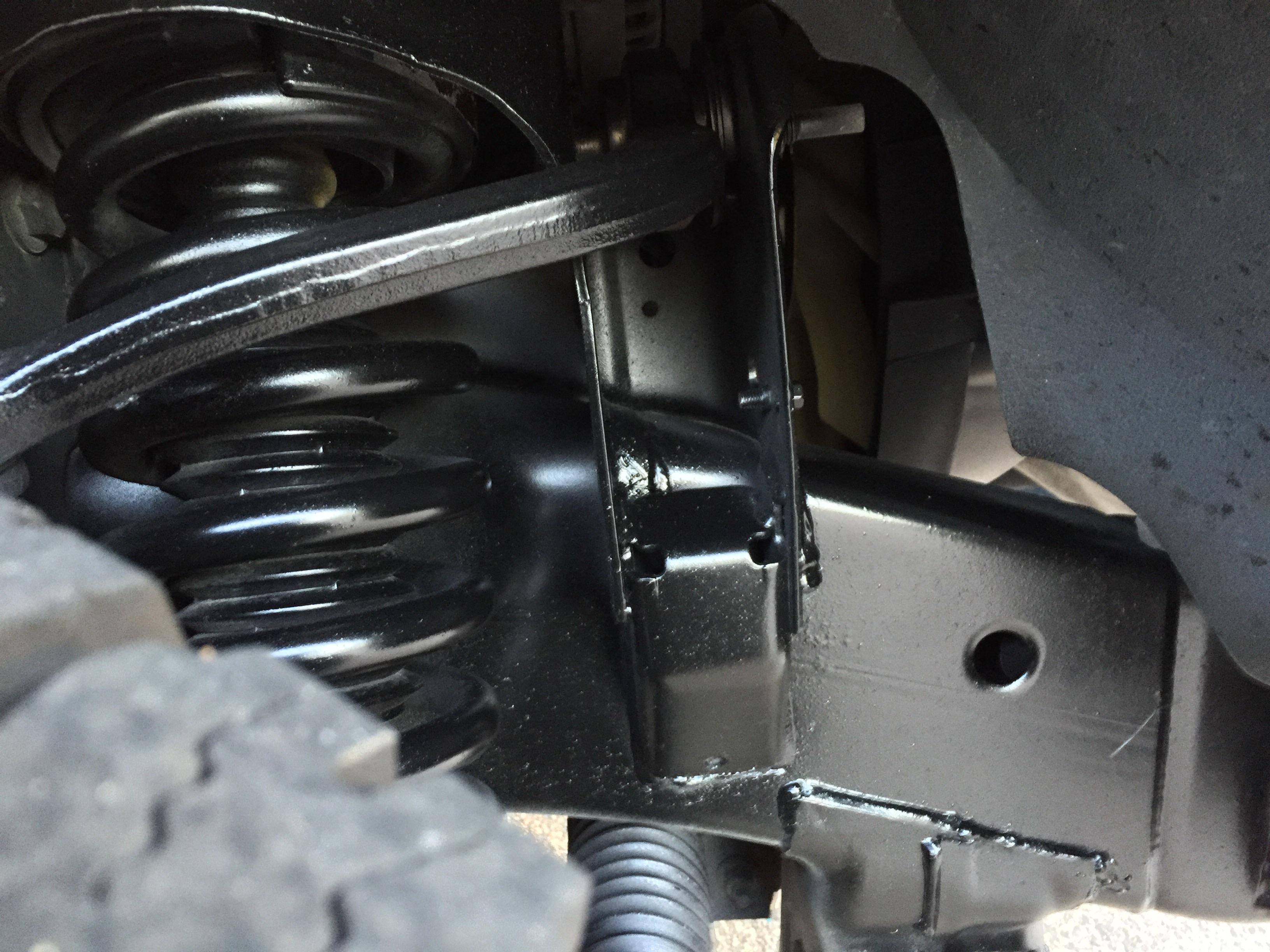

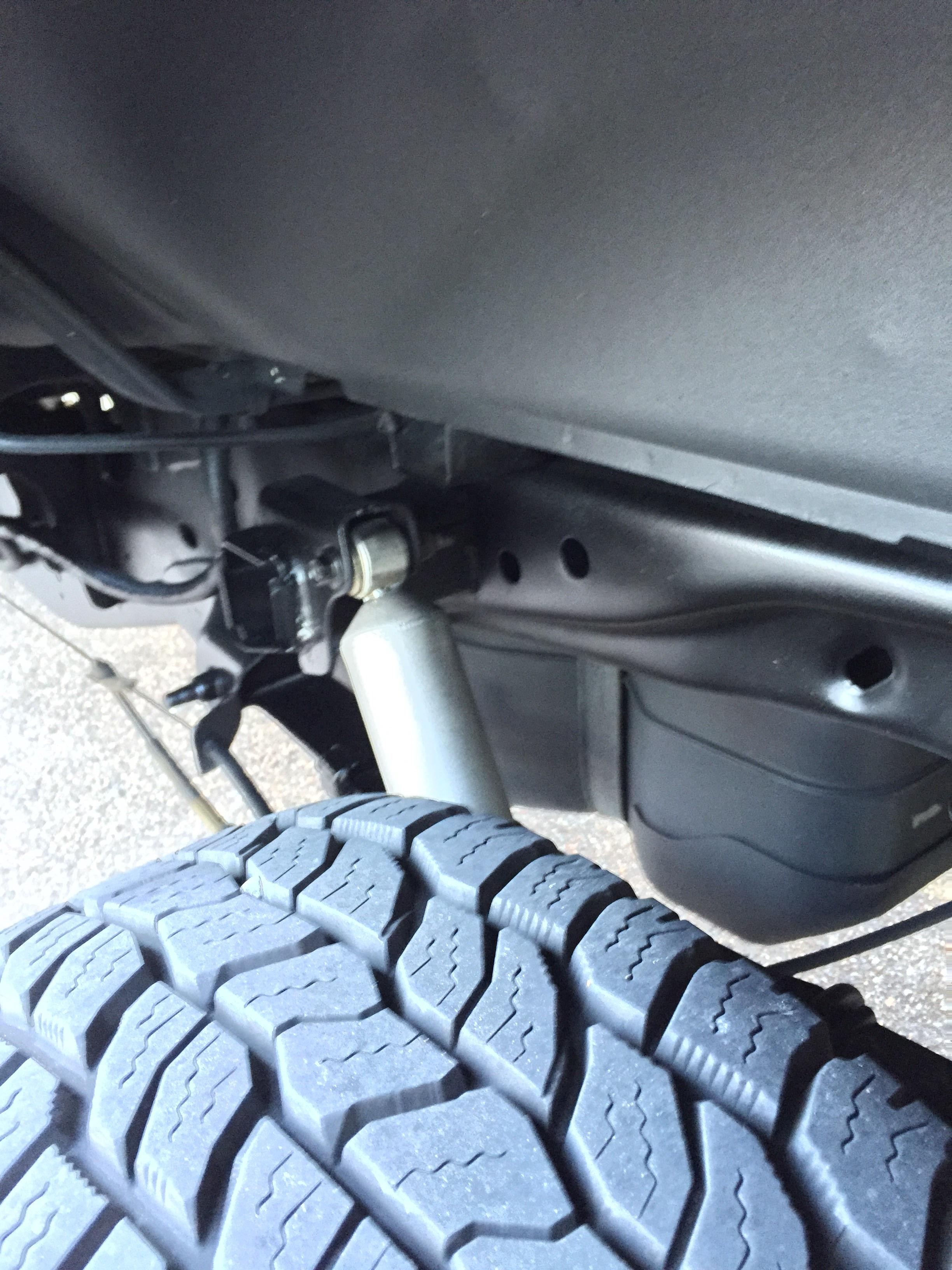

Ps here are some picture taken this past fall. I used semi gloss last time. This truck is driven through salt all winter for the past 7 years.

Ok those pictures helped a lot. I was unsure if you did leaf springs and u bolts but I have a better grasp of it now. May do it today since its a wonderful 72°F out today! May even wash the truck for the first time this year!
