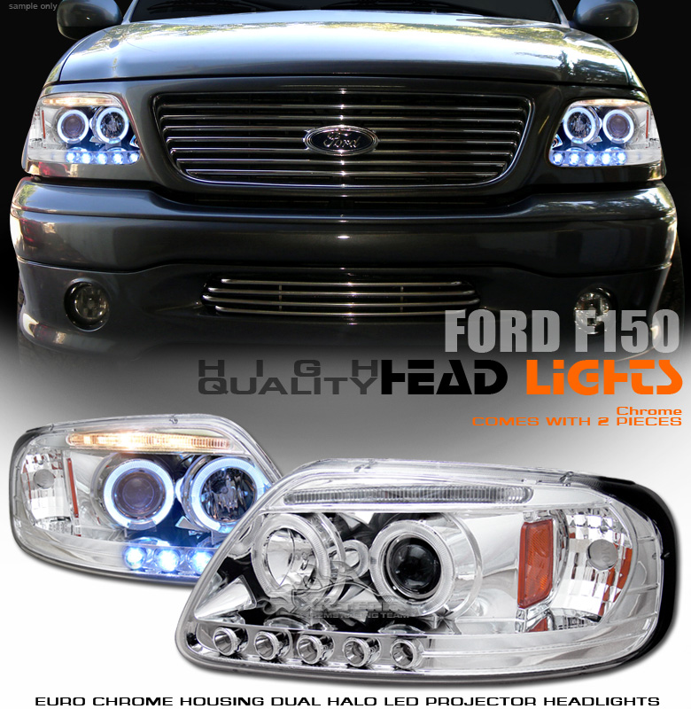

What do you guys think of these?
http://www.protuninglab.com/hid-pro-...004-hl-bk.html
Thanks
Old May 9, 2011 | 05:57 PM
  #206
Carolinaboy32's Avatar
Posts: 2,178
From: Bluffton, SC
PUKE!!!
NO, That's just my opinion
Old May 9, 2011 | 07:12 PM
  #207
crewster's Avatar
Joined: May 2011
Posts: 30
From: NC
How about these instead
http://www.protuninglab.com/fd15-039db.html
Crewster
Old May 9, 2011 | 11:42 PM
  #208
Ace_boy2099's Avatar
Joined: Dec 2009
Posts: 231
From: New Port Richey, Florida
Thanks
If you are trying to do a retrofit with these let me tell you now, It won't work, Trust me, I tried on a set for my 99. I had to trim away so much of the mounting tab thingy that when I tried to test install it the thing broke right off.
I was trying to make these work, Unfortunately like i said above it didn't. Would have definately been one of a kind if my plans had worked out.
Crewster
This may work for a retrofit but I don't know.
