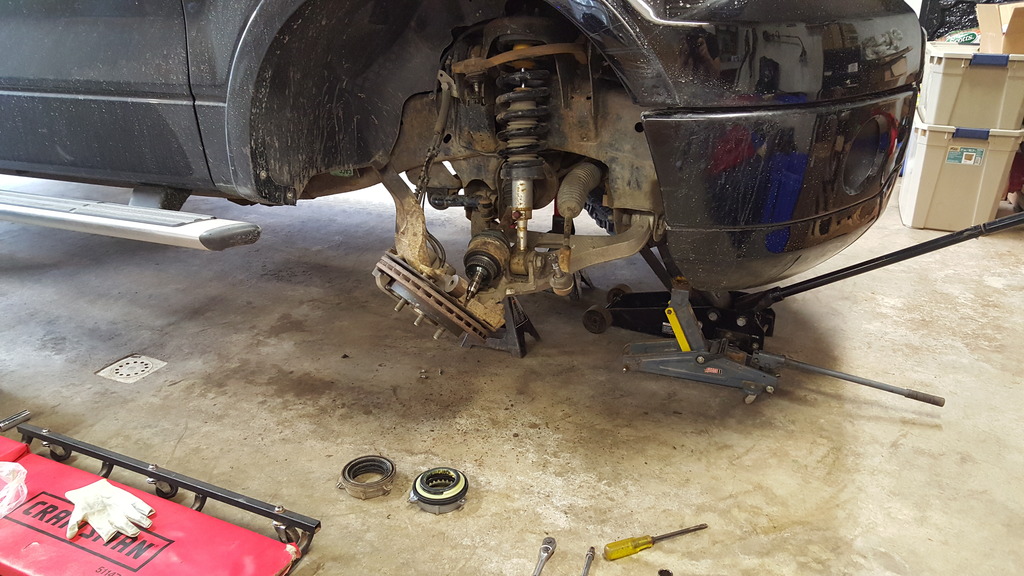

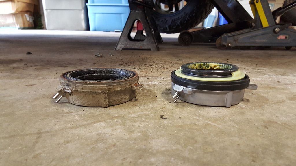

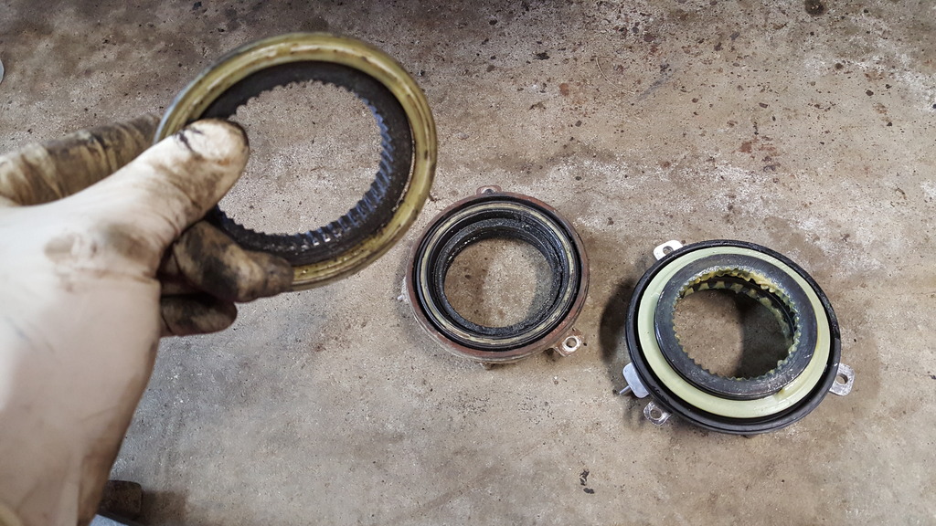

My DD car decided to puke it's water pump and lost all coolant, so i'm driving the truck daily as of now. I did a bulk order on Rock Auto for my DD, picked up an IWE for the truck as it needed a front right one. I changed it out today following FordTechMakuloco's video on YouTube. I couldn't believe what I pulled out, the gear ring separated from the actuator itself. Took it for a test drive, and replacing this with a new one resolved my 4wd snapping issue, steering wheel shake at higher speed, and clump sound on inclined angles. Glad I got this out of the way. Time for an alignment.

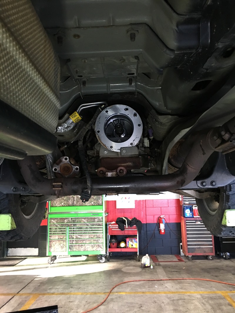

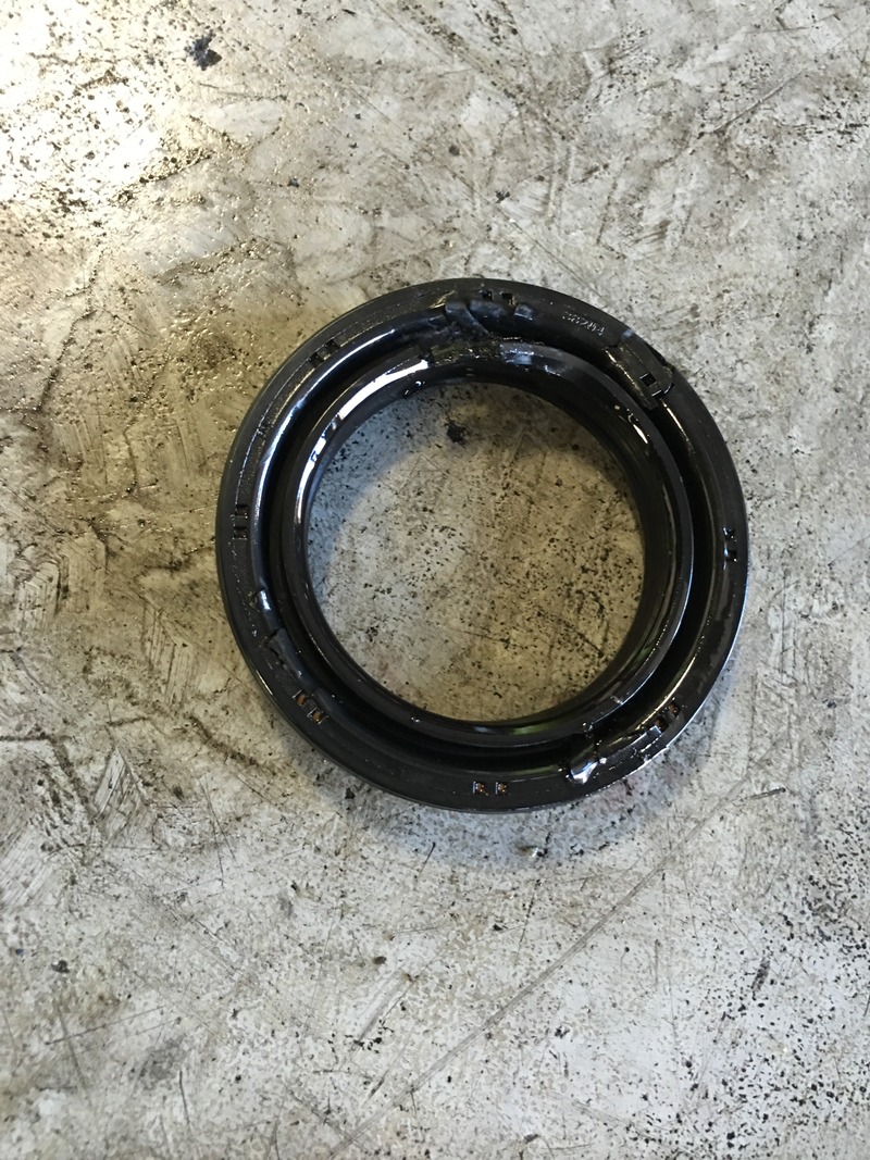

i pulled the transfer case this weekend and replaced the transfer case input shaft seal. my t-case was filling up with fluid slowly and draining the transmission slowly. not too bad of a job. getting the t-case skid plate and driveshafts down were cake, as was unhooking the actuator and vent tube. the 6 bolts that hold the transfer case to the transmission were a pain. there are 6, and the top two are miserable. i had just enough room to get a deep 13 mil socket on them, and i could only get one click out of the ratchet at a time (they are long bolts too) putting those two bolts in and out was the bulk of the time involved. also replaced the rear output shaft seal while i had it on the floor, and the front out put shaft seal looks like youd have to split the t-case to change it so i left it alone. going to wait a week and pull the tcase fill plug to see if that fixed it. there is no transmission output shaft seal, for whoever is interested. not a bad job really.
