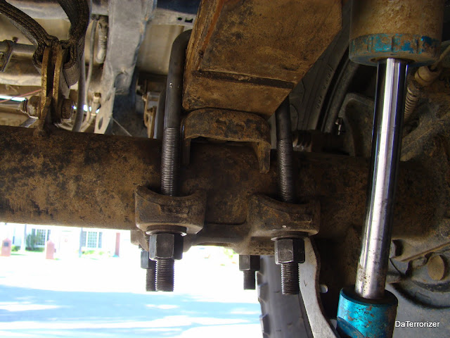

After installing my Rize Kit with the King Shocks, Limiting Straps and Bump stops, Refer to Thread http://www.truckmodcentral.com/forum...ead.php?t=2688 I've taken my truck on the trails countless times. I've been hearing my front passenger suspension bottoming out on me. So I took it back to Wicked Creations who took the front suspension apart to cycle it. He then send the shocks to King, who's business is right next door, who added a 2" spacer on the shocks, an extra rubber bump and re-valved them.
Results of bottoming out:
Before--------------------------------------------------------------After
Before spacer, Shock Set hight:
After spacer, shock set hight:

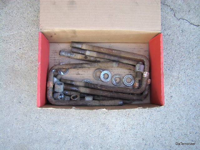

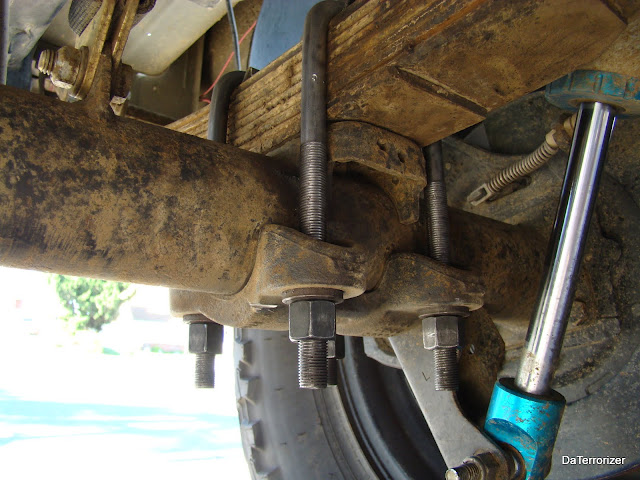

I also had them re-weld my winch/light bar support, refer to post https://www.f150online.com/forums/ot...t-bar-tlc.html
I had also picked up 4 new spring leaf U bolt from Deavers the other day and since Wicked Creations were working on the suspension I had them install it instead.
Old Set

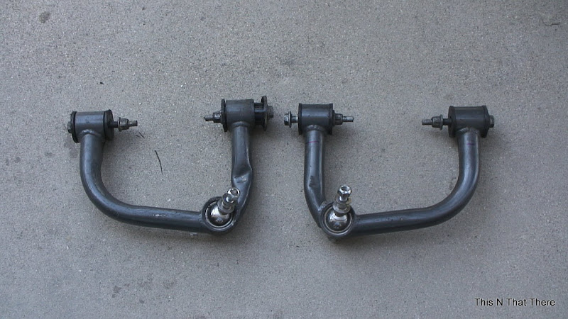

Looks like your UCA's took a beating too.
Yup it did, good thing it is stronger metal than the Camburgs' so it only dinged it not bent it.
Bent Camburgs

Same hight, spacer allows the shock to travel further up without bottoming out. Notice in the second 2 picture where the first shock is threaded down to the second is threaded up.
