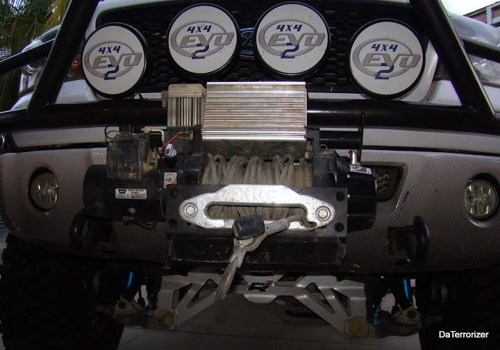

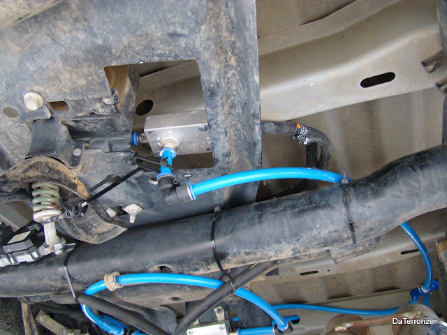

My Warn power plant winch has a built in compressor which I use to air up my tires cause I air down every time I go trail riding. So, I ran a line from the winch's compressor to my Two 2.0 galon Vair tanks I carry on board in the bed of my truck. Then I dropped back down from the tanks and supplied air lines to all four tires. Now I can connect my air source to all four tires at the same time and inflate them to the desired psi without having to air them one by one.
I know about the technological advances in air systems which exists out there but I preferred to make my own.
This is to keep the mud and dust from damaging the fittings.

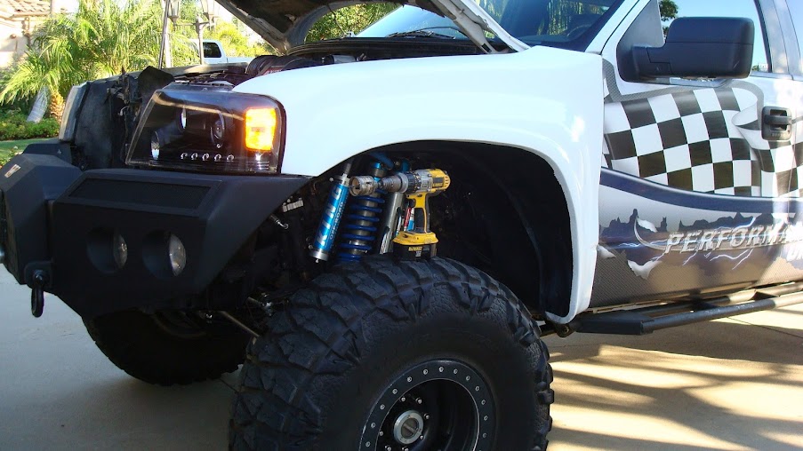

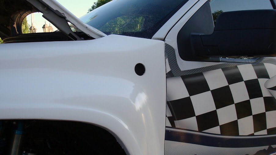

What is a drill with a hole saw doing so close to my truck?
OH....OH
