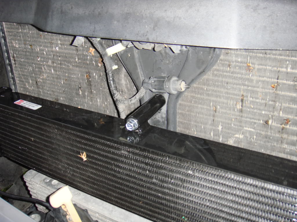

Relocation of air temp sensor

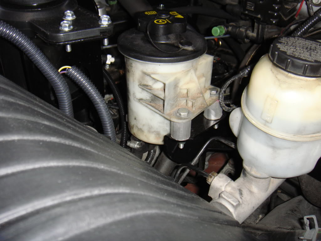

Spacers for Power Steering Reservoir

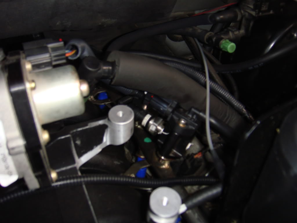

06 Up fuel Pressure Regulator

Wouldn't you want that air temp sensor after the intercooler? This is how I have setup all my blown mustangs in the past. Guessing the saleen does not have the room, I'm not sure. Seems like your air density difference in voltage from that location would be wayyyyy off.
No this is the sensor to read outside air, like for the display odometer etc.
