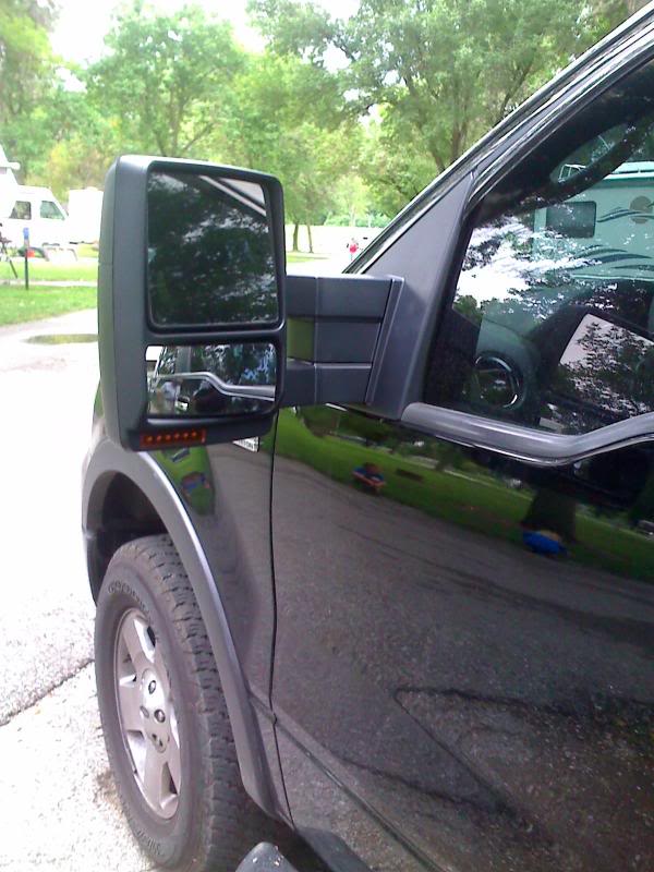

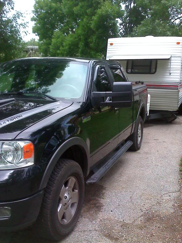

Old Aug 9, 2009 | 10:20 PM
  #358
Krohbar's Avatar
Joined: May 2005
Posts: 1,141
From: HUSKER COUNTRY, USA
Added!!
Put these one while we were on our camping trip. Moving the ground was EASY... I just didn't have the time to get the puddle lamps working, yet. I need to get a hold of some of the pins that go in the connector.
