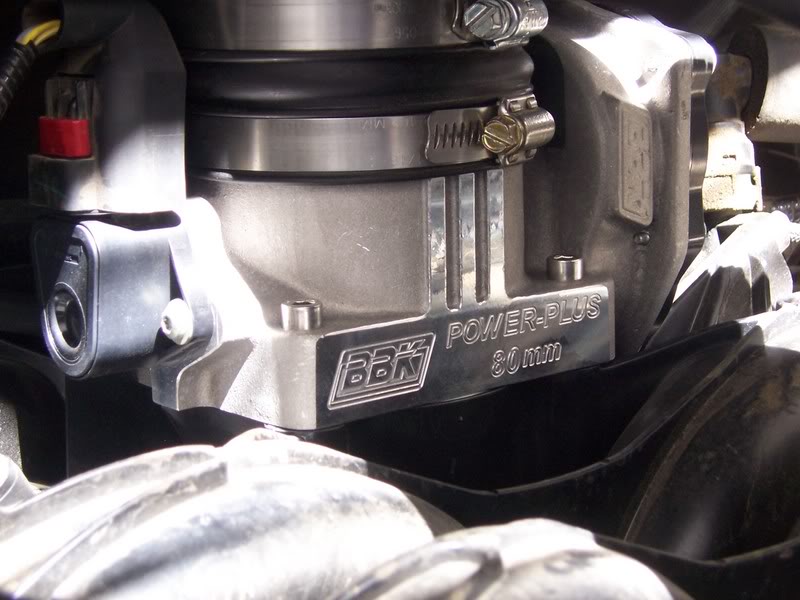

ok i finally got the TB and finally can put this myth to rest the bbk throttle body is actually 80mm!!!! not 75mm like stock. i havnt put it on yet i will in the morning. then im going to get ahold of my buddy with the dyno and see when we can do it and i will remove it a day or two before so that the truck will re learn to the stock tb for accurate readings of gains

What myth???
The 75mm is for the 4.6 and the 80mm is for the 5.4
BBK 1758* 75mm 4.6L throttle body 04-06 F Series/Exp.
BBK 1759* 80mm 5.4L throttle body 04-07 F Series/Exp

Picture of the tb!

The 80mm Throttle body dyno'd with gains of 7rwhp/11rwtq, on a completely stock truck.
