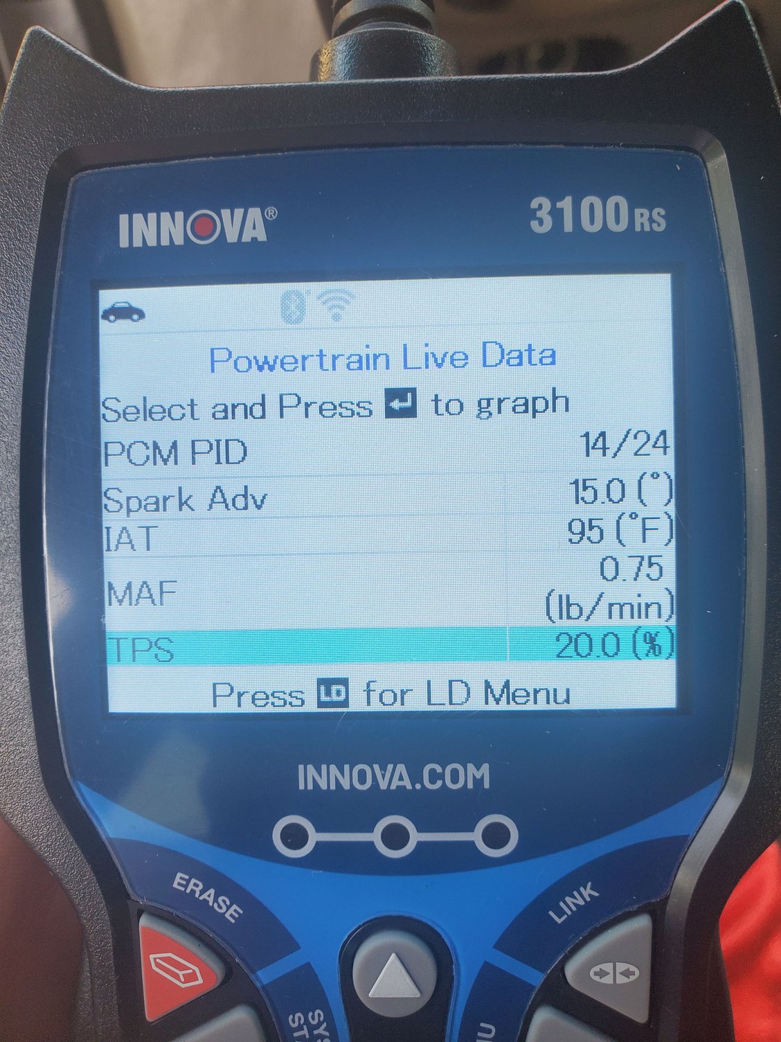

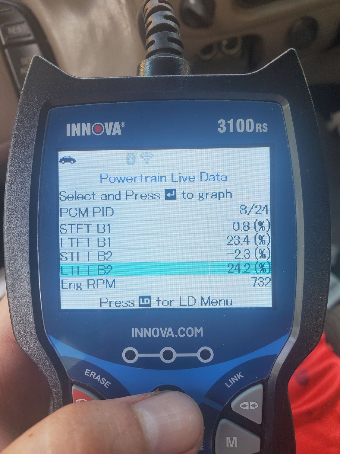

I was scared to hear that. I'm waiting on it to cool down so i can clean the maf its not been cleaned as far as I know possibly ever.. I did take some photos of it running on a live data scab
the truck does not crank any longer than it should to start it fires right up zero rough idle it can sit for 2 days and starts up like a new one

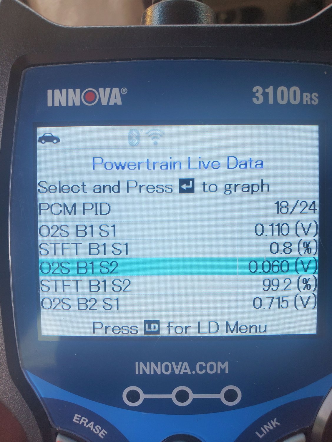

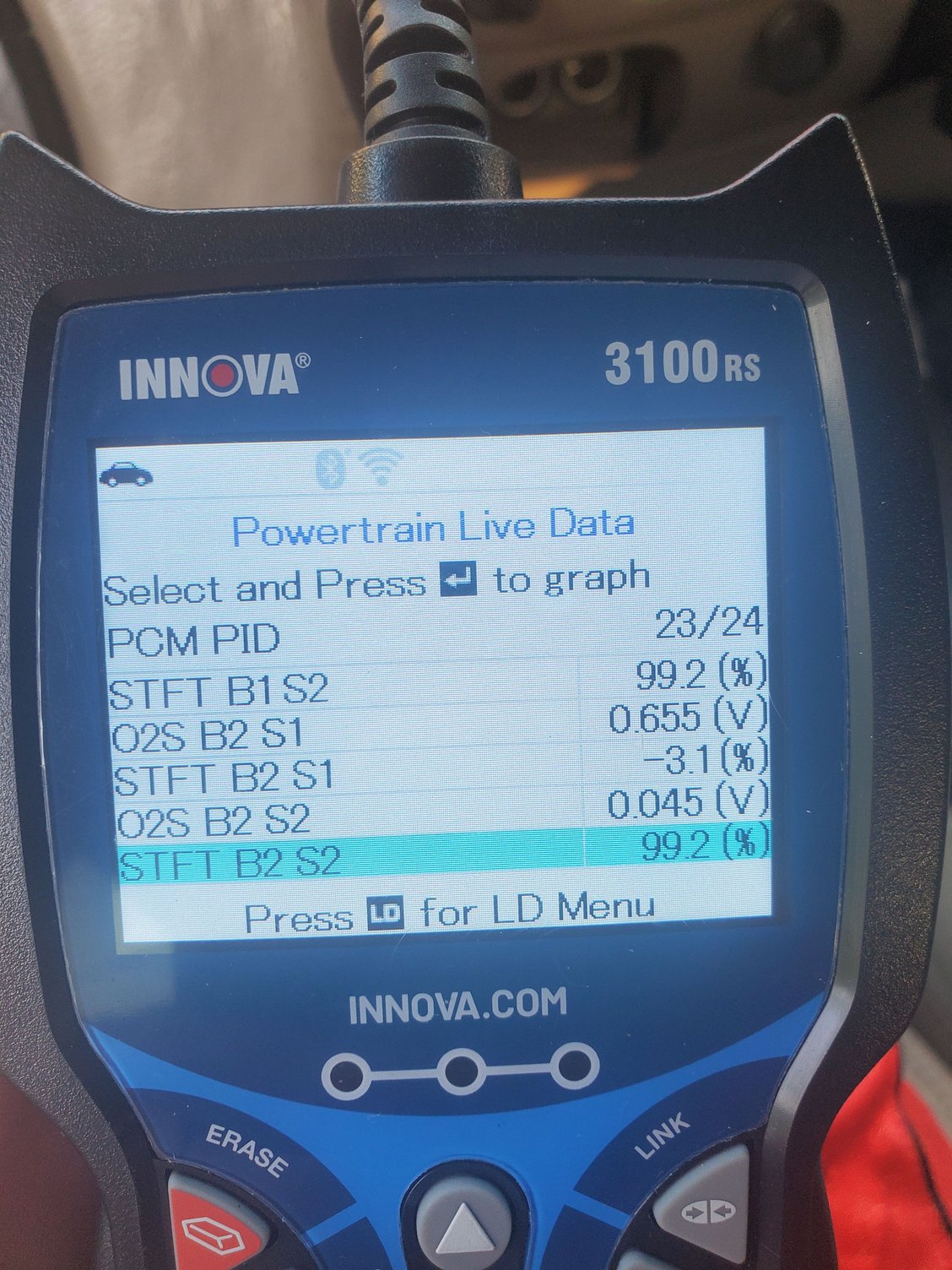

From what I gather the statement b1s2 and other one are the o2 sensors saying I'm burning most of the fuel and seem to be within range. What about the others? I know I can't base much off some baseline numbers without graphing it throughout the entire rpm range I just was curious. I think I'm going to have to test the rail pressure as mentioned above and previously suggested I just have to rent or buy a fuel pressure tester.

Your Scanner is showing you the basic fault.
LTFT 1 and 2 are shifted rich 23% and 24% almost to the point of setting codes 171/174 at 25%.
Find the Vacuum leaks.
Until you, do expect hot stalling, low rpm rough running and poor gas mileage from running to Rich..
Good luck.
