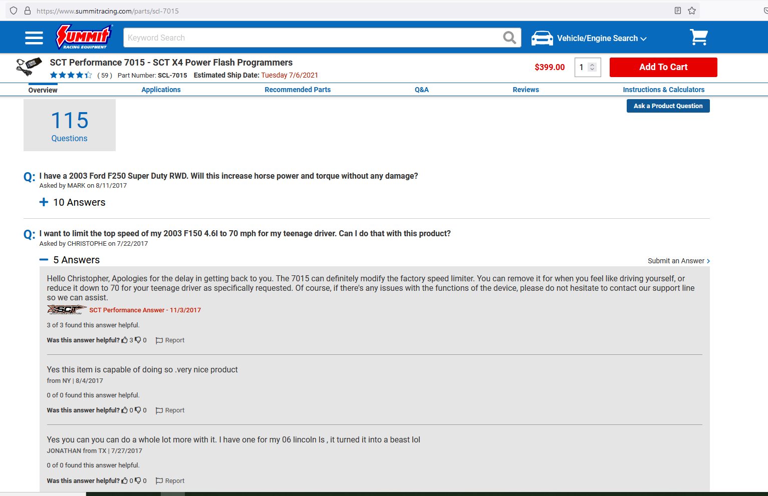

I can’t even find any place advertising a canned SCT device that advertises speed limiter removals, so good luck

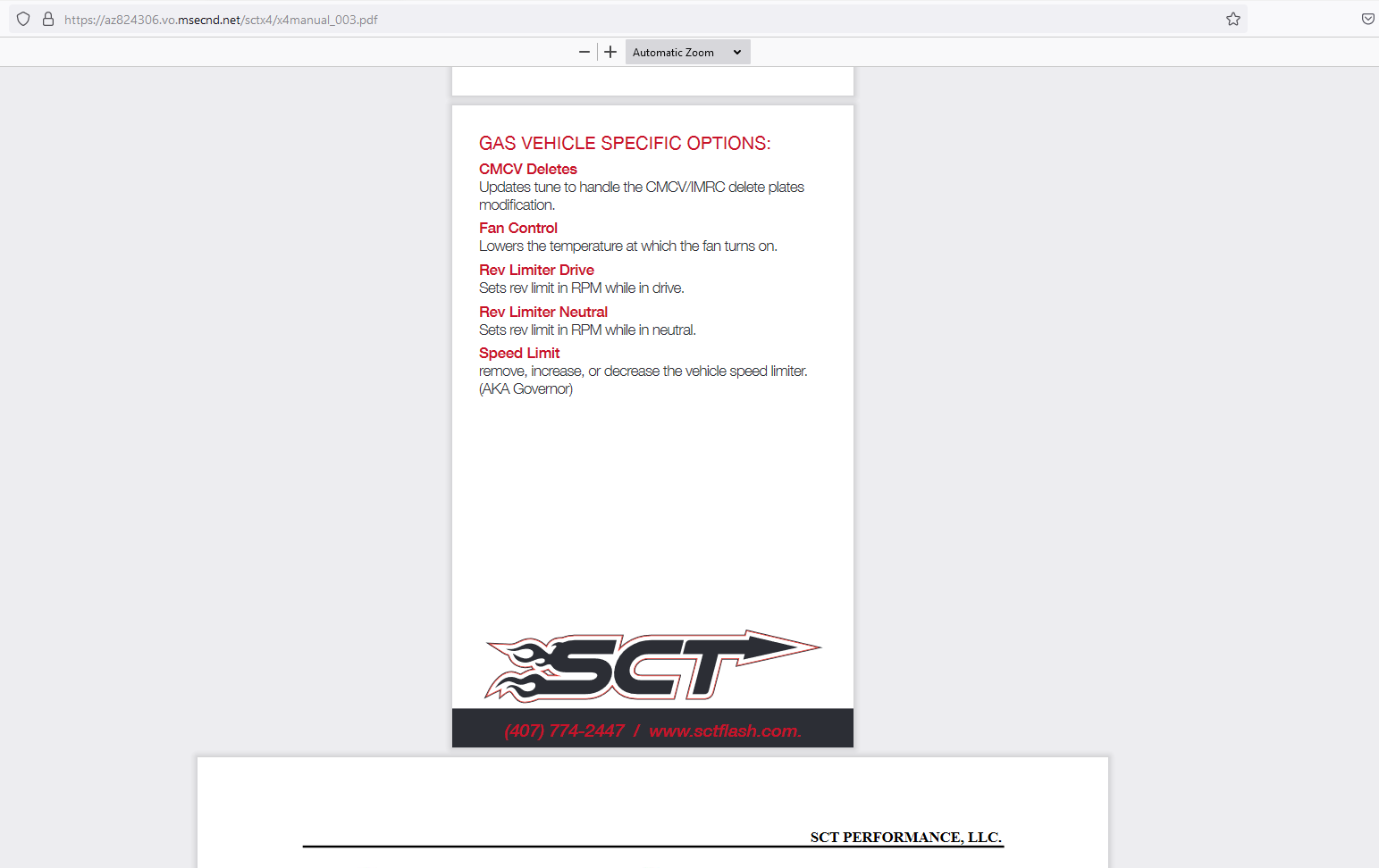

The last pic is a screen shot from the owner's manual for my tuner.
