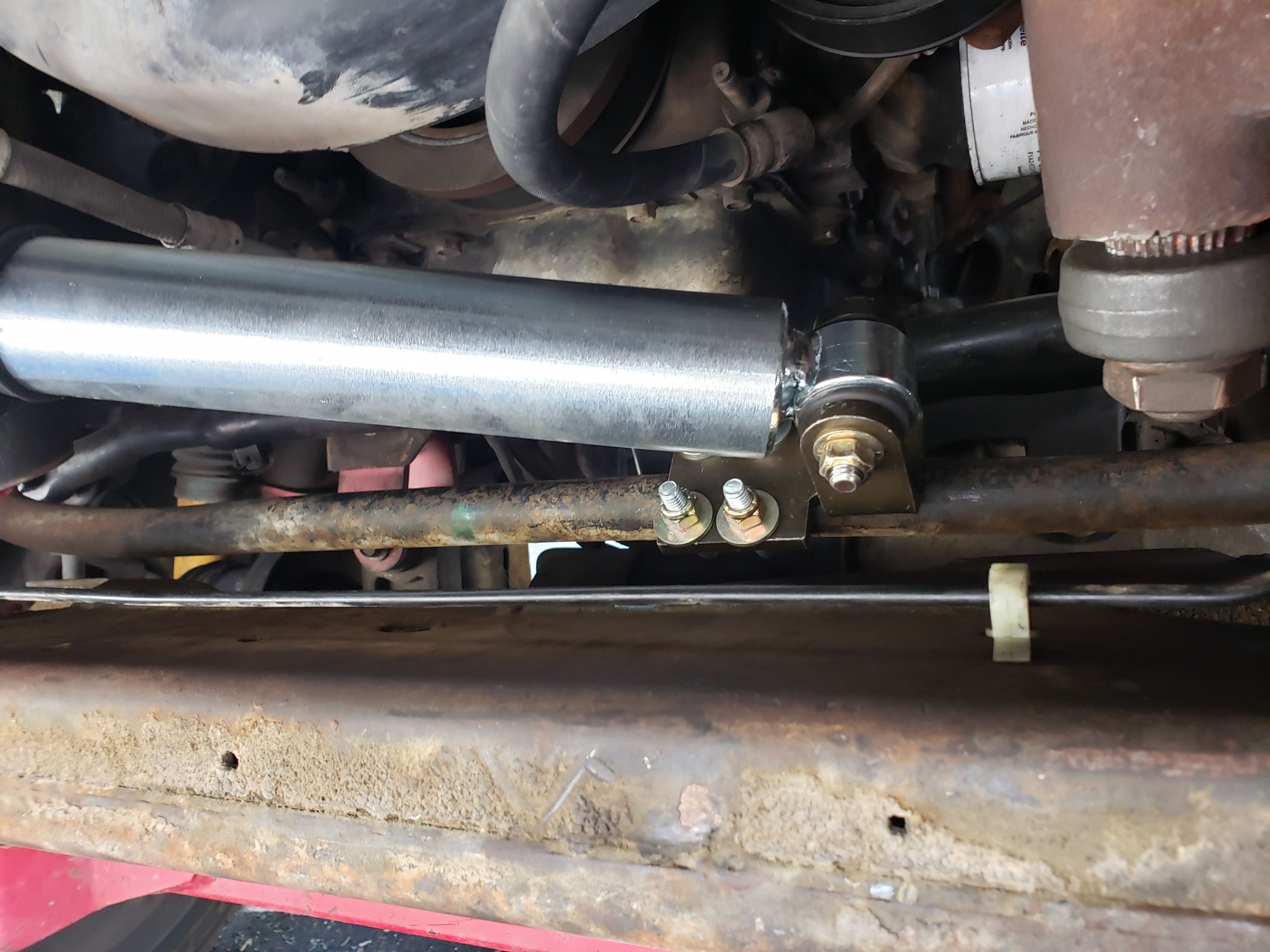

Got this bad boy on.....
and compressing it to 16" is a nightmare, especially trying to line up the other bracket.... so.... I used a big ziptie, 40" long with a 175 lb rating and held it to 16" center to center of the eyelet.

yes they can be a little difficult to squeeze BUT....it should STAY there as it is a neutral shock....
btw looking good
your end links should be readily available from most any TRUCK shop. Measure how long the spacer needs to be. It's just a bolt with a spacer and bushings...nothing very special or truck specific required.....just length!

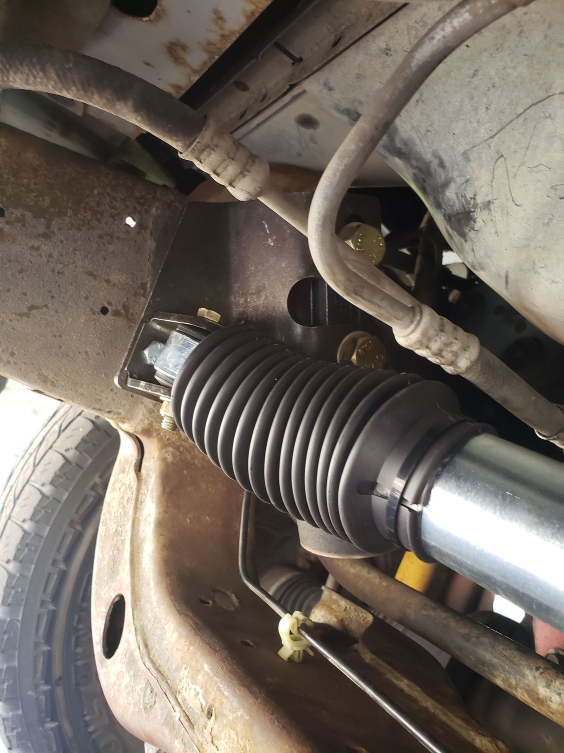

i wonder where the "other" stud - stud type mount on the frame???
