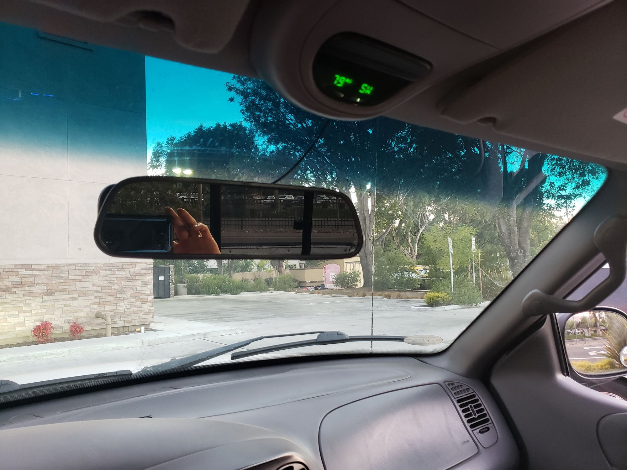

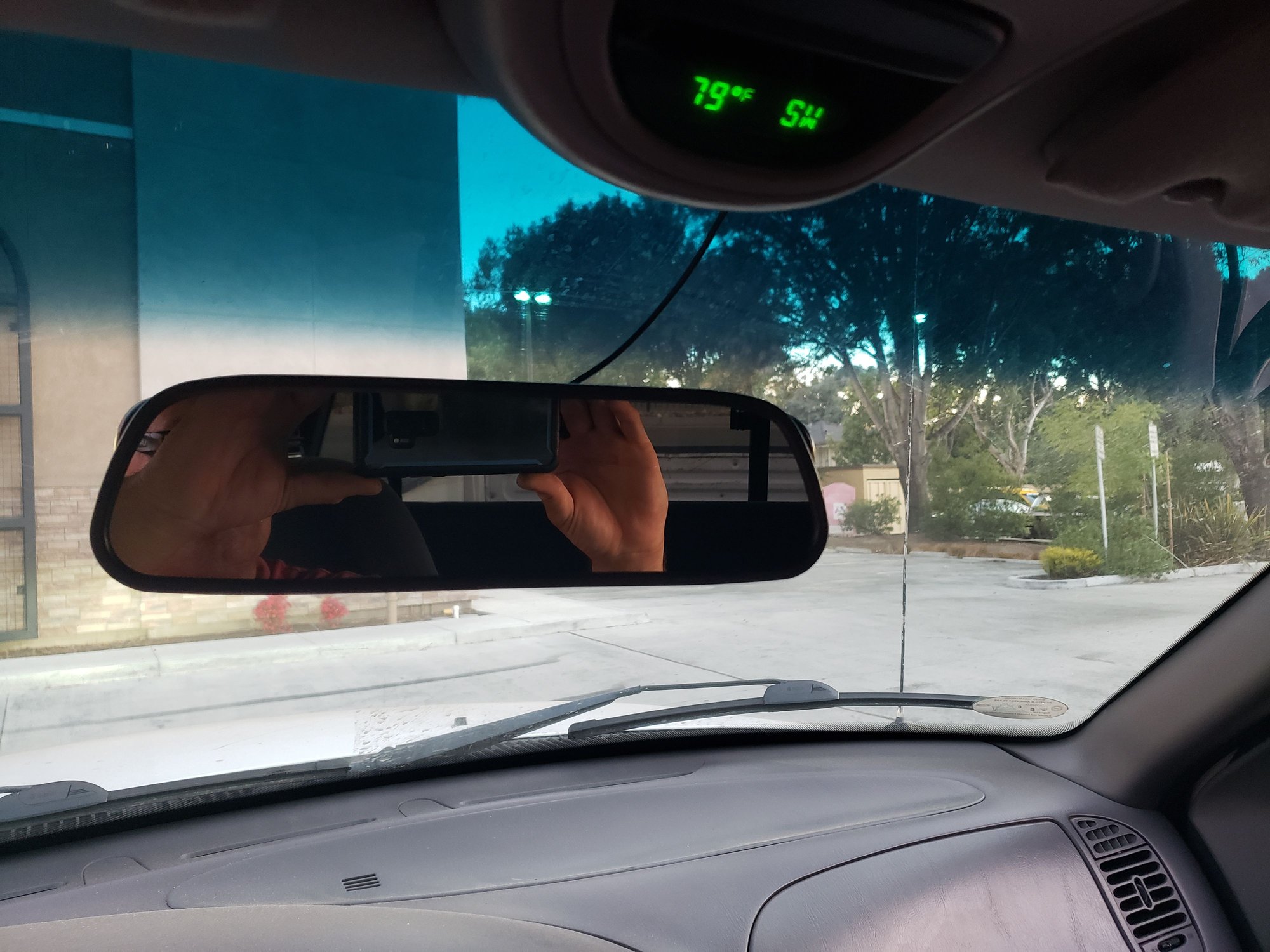

So I picked up a backup camera. Overall am happy. It was $50 off amazon. The monitor mirror clips onto the existing mirror. Has a 5" display. Is wireless to the camera. I tapped into the left rear reverse light for the camera. For the mirror, I goofed up. Tapped into my compass, but.... here is where I goofed, the camera only comes on if my headlights/parking are on. Honestly, I am ok with that. I really only need the camera so I don't back into a car in the parking lot. And I work early morning, when I have my headlights on. I typically drive with my lights on all the time anyways though. I am sure there is a way to wire it correctly, but I gave up for the night.

Found what I needed. Looks like I need light blue/white
EDIT: fixed it. Literally took less than 10 minutes.... man I hate scotch-locks, but oh well......
