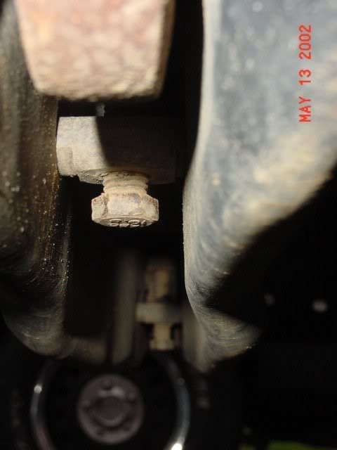

not to Hijack your thread, But I have a question about the bolts for the torsion bars. Mine are at different lengths is that something to worry about? From what I've been told that it is bad and from what I've tried searching and found is that nobody seems to mention anything about it. I did find a picture and nobody had anything to say about it.
Mine look like that but with more thread sticking out. (this was an image that i got from f150.net after someone cranked up there torsion keys)

it's fine

It's completely fine. Even beyond being completely fine, it's sometimes required. Most often noticed from the factory, they can be used to level your truck from side to side. As an example, a technique for gaining a few free inches of lift on the front is to crank these bolts full to the stop (you've probably at least heard of this). With my truck, this left the truck higher on the drivers side by a solid 1/4". I simply backed off the drivers side bolt until the desired height was achieved paying no mind to the position of the bolt. 100% trouble free.
Now back to your regularly scheduled program already in progress...

Without drifting from my original topic, I can tell you my RH adjustment bolt was 3/16" longer (less threaded) than left, but the torque on the RH bar was way more than that on the LH (almost turned by hand after initial release), yet the truck appeared balanced and aligned.
