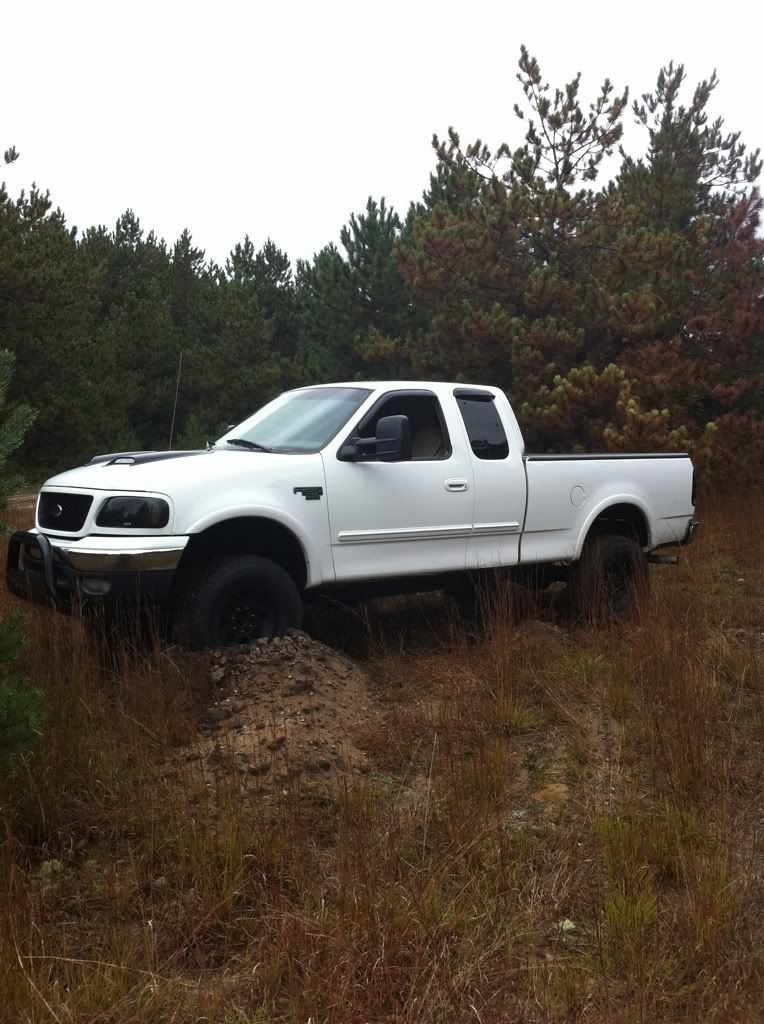

well so far this is what i would like to do.
1. 17x9 Cragar or Pro Comp wheels
2. Nitto Trail Grapplers, 35x12.5R17
3. 3" PA body lift
3. Rhino bull bar with LED lights
4. Remove toolbar/brush guard.
5. Tint front windows darker
6. smoked headlights/taillights
7. bushwacker fender flares
8. Plasti-Dip spraying the remaining chrome on the bumpers.
wanna make it look closer to this one (is a member here, but i didn't pay attention to who).
