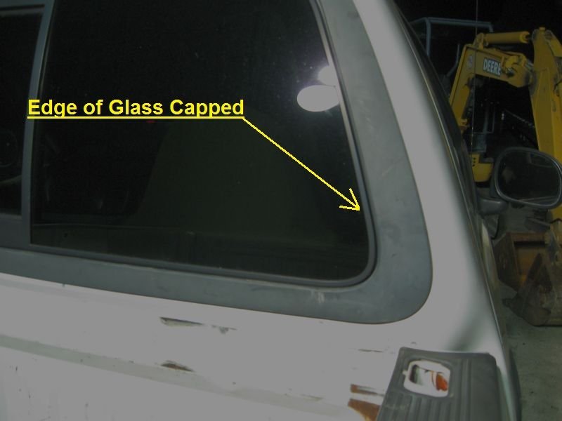

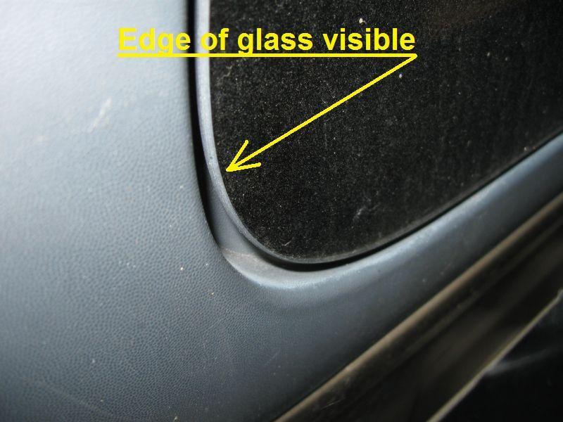

If you get a used slider, make sure you get the newer type with the frame around the glass ... the older type will leak on you (the frames crack).
3M Windo-Weld (3/8") works well to seal the window when you install it. The install is not hard, just tedious. There are several good write-ups covering installation on the forum ...
Old type ... usually leak due to internal cracks in the frame
New type ... this is the type to get

I know what you are going through and yes you have to replace the whole thing as single sides not offered anywhere I checked around. I came out to find this on mine Tuesday and have no clue how it broke as I have a ARE Z series cap on the back and its glass is still fine. Ended up getting another new sliding Ford window put in to replace it with the capped edge as recommended. .
