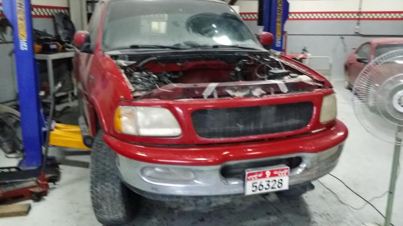

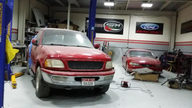

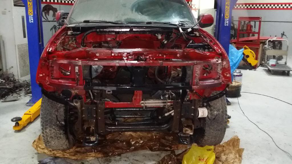

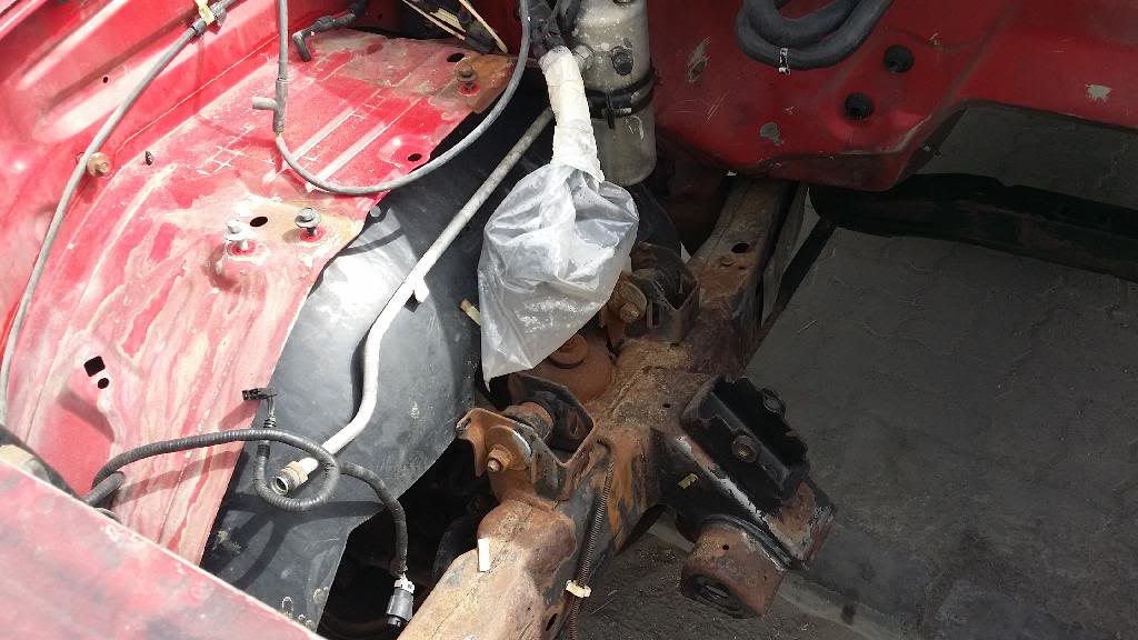

Ok so here goes the first week of the build
How she sat
Engine & trans out
Dirty Engine bay
Degreaser sprayed on all of the body after stripping out the harness
Tank before
After its being steam washed. Notice all the rust.
I cleaned and restored the Hydrobooster, fuel tank is cleaned and painted black as well.. today Im spraying the Frame and going to start with the engine work by tomorrow.

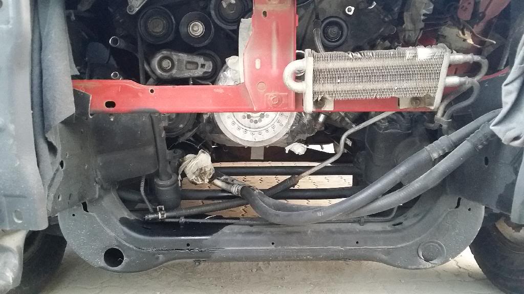

Update ***
She sits, Yes.. Fits so easily,No issues.
Had to hammer the wall a bit for that perfect clearance.

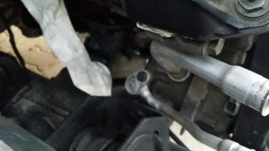

No issues with the sweet AC

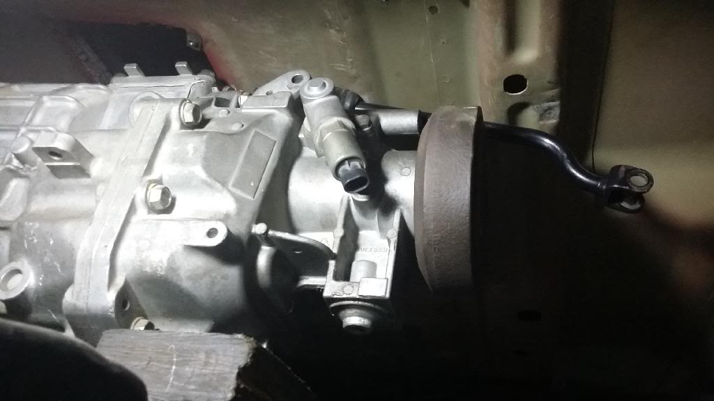

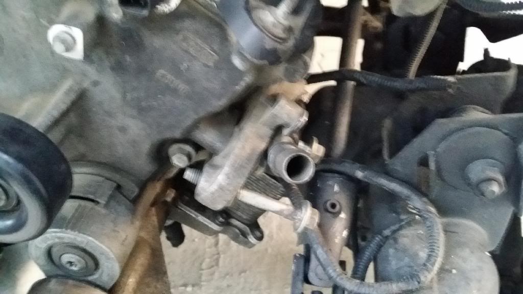

AN issue with the alternator as it has to be relocated due to the steering rod.
Accepting any ideas for that easy relocation.
MMMMMMMMMMMmmmmmmmmmmmm..... The Donut Space ( Turbo )

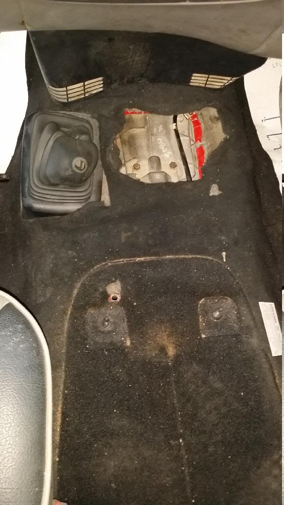

Look where the TR6060 Shifter reaches.. Lol. Might get that Shifter relocation kit I saw somewhere on the INTERNET . http://www.core-shifters.com/servlet...Shifter/Detail
Not the two studs, Thats where the Shifter meets.. Too close for my taste.. Im not gonna do any cutting for this one.
I am thinking of swapping in a Mustang steering wheel as well.. Will have to custom make the adapter for it.
Trans Crossmember will be fabbed this week,
radiator and all the belongings as well such as E.fans and its wiring.
Might keep the stock booster for now till Im sure everything works.
I give it a 3 week to start.. 2 weeks giving all the connections and fabbing and the last week for complete wiring.
I am accepting any ideas while on this build.. I am also thinking of swapping those RAYCARO seats for the sweet sporty touch rather than the sofas.
