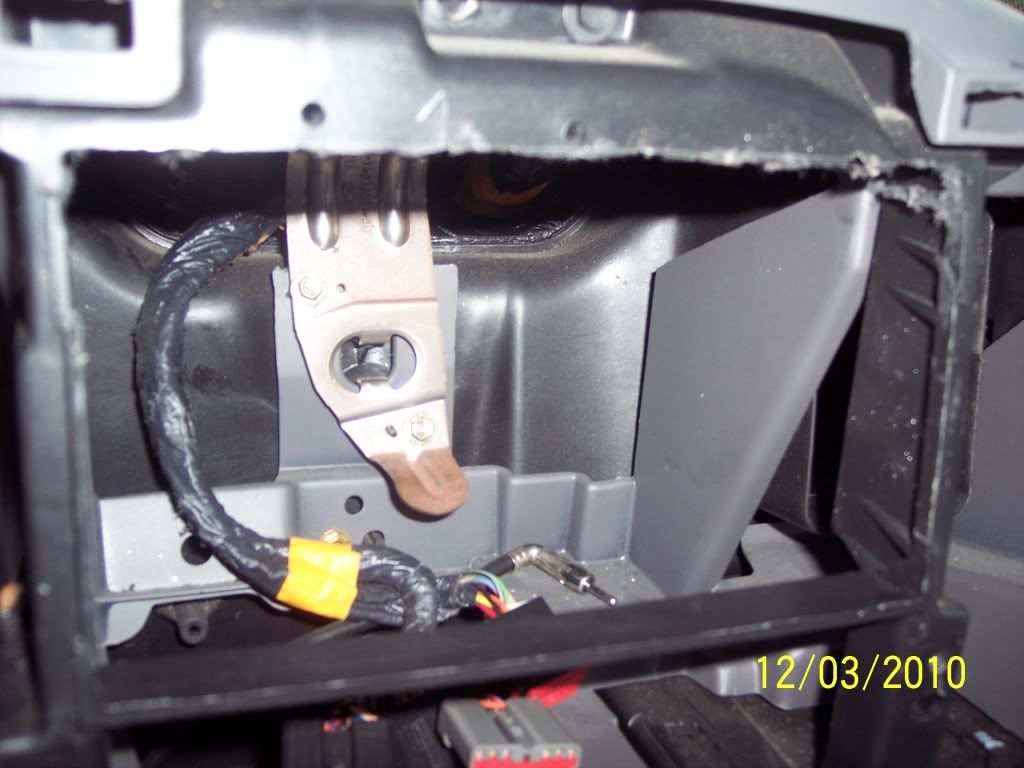

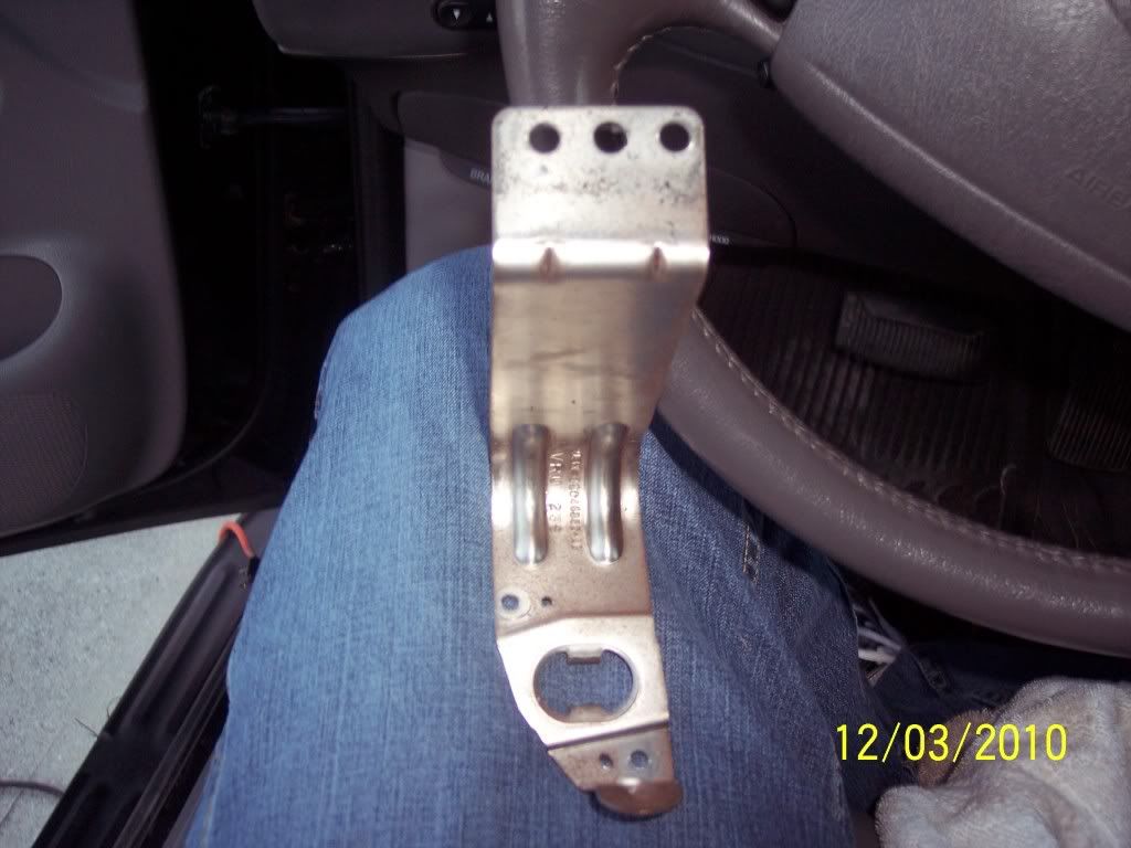

I had to remove this factory bracket that's held in with a few 10mm bolts.
Click the image to open in full size.
Now, you will have to loosen a few dash screws to get that bracket out.

Soo how does the DD secure in the back then? Am I missing somthing? LOOKS GOOD! I want a DD w/ nav for my 02 screw. I am tired of having the Garmin stuck to the widshield and having the power cord draped across my dash! And yes I know that I could probbably wire the Garmin up directly but I would rather have nav in a head unit instead!!

My Pioneer unit is NOT secured in the back. I believe that bracket I removed is what held the factory deck a bit. The mounting kit you get has the brackets you screw into the sides. I think it pretty tight, then you have the dash tight on top on that. I'm sure you could probably cut that bracket in half and reinstall the lower half for extra support if you wanted. But you need the top of the bracket removed for clearance. I personally didn't think that was necessary so I left the bracket out.-----DirtySCREW
