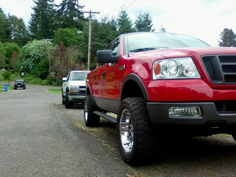

my truck is leveled 2 inches, with 12.5 inch wide tires, but my wheels are 10 inches wide and have a -12 offset. so mine stick out 25mm more than those would, which is one inch

You will need more lift to fit a 35x12.50 on a 9 inch wide wheel. Or you can go with 33's like jdeacon.
