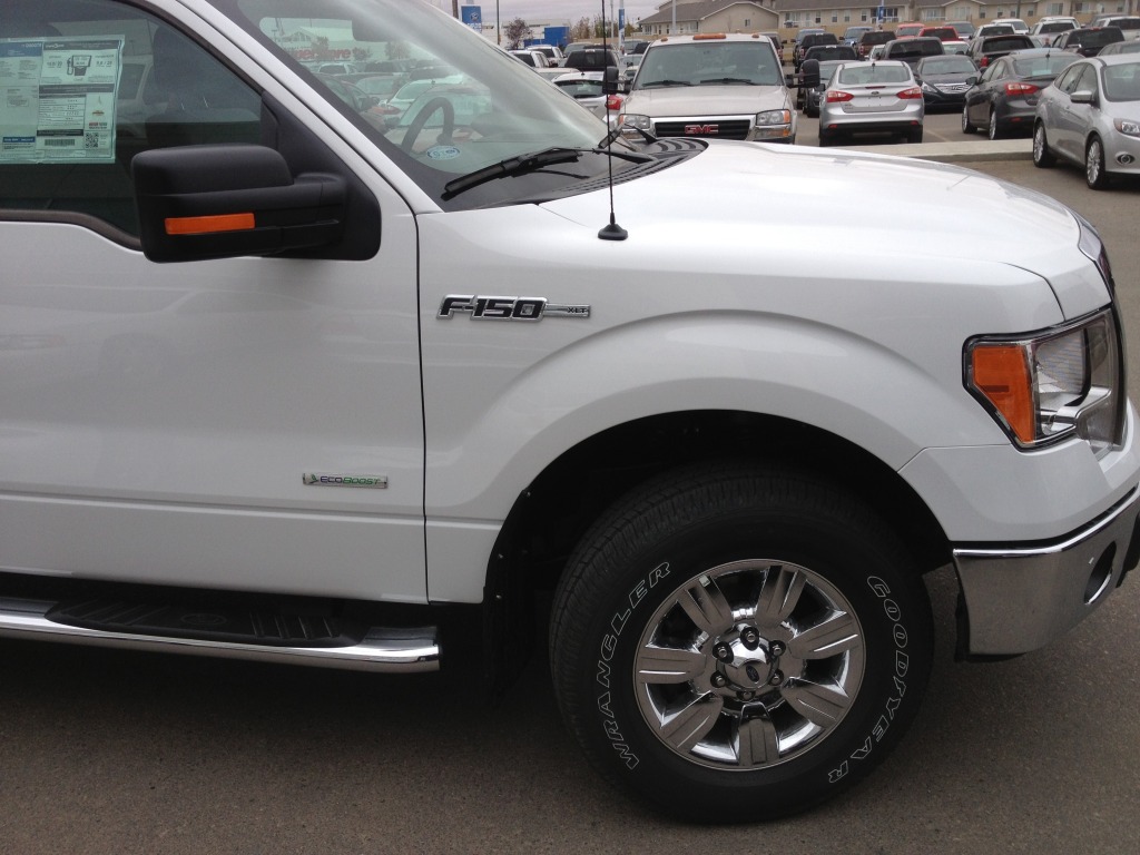

In the near future I'll be switching out the GY P-metrics for some LT C or E load. Does anyone know with certainty the maximum PSI rating on the factory 18" wheels?

They will handle anything the tire will. Just make sure it is the proper pressure for the tire. For a LR C probably around 40-45. For a LR E, depending upon the tire, anywhere from 40 (for high load carrying ability of around 4000lbs per tire) to 50 (for normal LR E load carrying ability of 3200 to 3400lbs per tire).

Max on a load E is 80psi which is over kill for my axle but I need to know what the safe limits are for the wheel. Will they take 65psi if I need for towing?

They will take anything the tire will take, including 80. And 65 would be overkill, even for towing.
