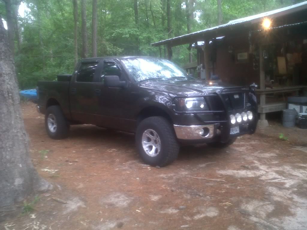

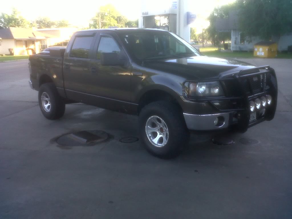

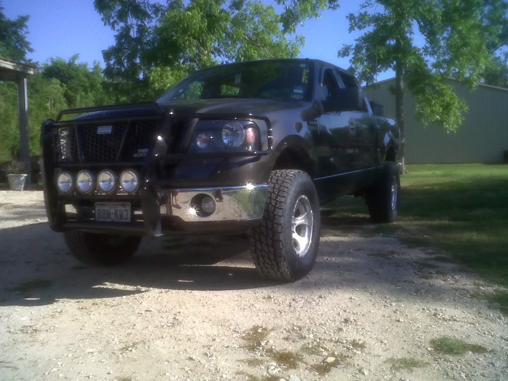

305 70 17 with a 2.5 level kit and dc1's
