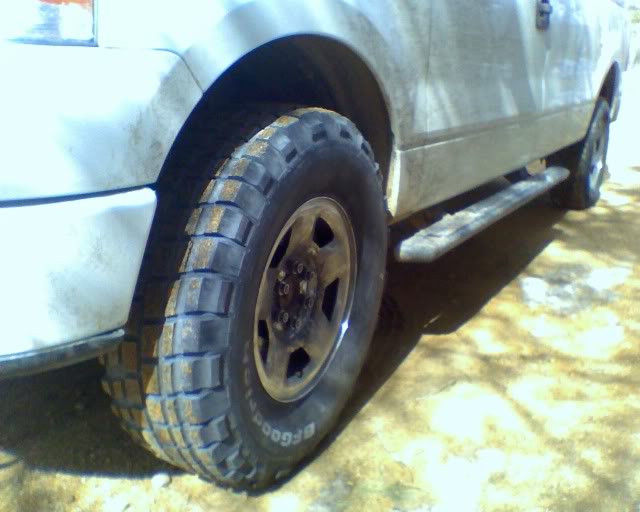

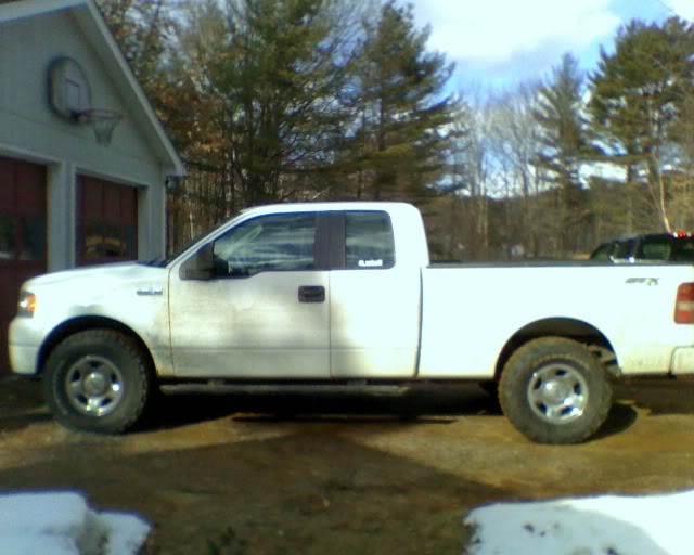

No lift on 35s. Barely rubs at full lock.
