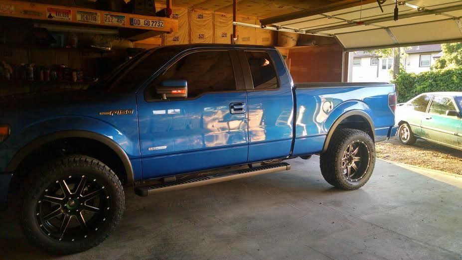

Old Jul 20, 2015 | 11:30 PM
Boosted512's Avatar
Joined: Jul 2015
here in my 14, with 325/50/R22 toyo at2s, with 2 1/2 inch level kit with block in the rear wheels have a -24 off set and they do rub. <br/>
