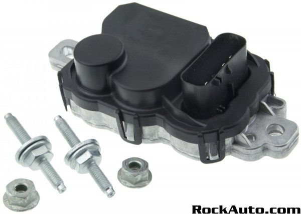

mmm yes also i removed connector and hose from pressure sensor and nothing changes.. and what is this on my attached picture?

Picture is not quite big enough to see what you are talking about. Instead of using an attachment, click the image icon and upload the full size picture. I'm thinking it's part of the evaporative emission system.
aha youre raight its Vapor Canister Purge Valve and if you know, removing hose and connector from pressure sensor must change rpm or fuel pressure and etc?
