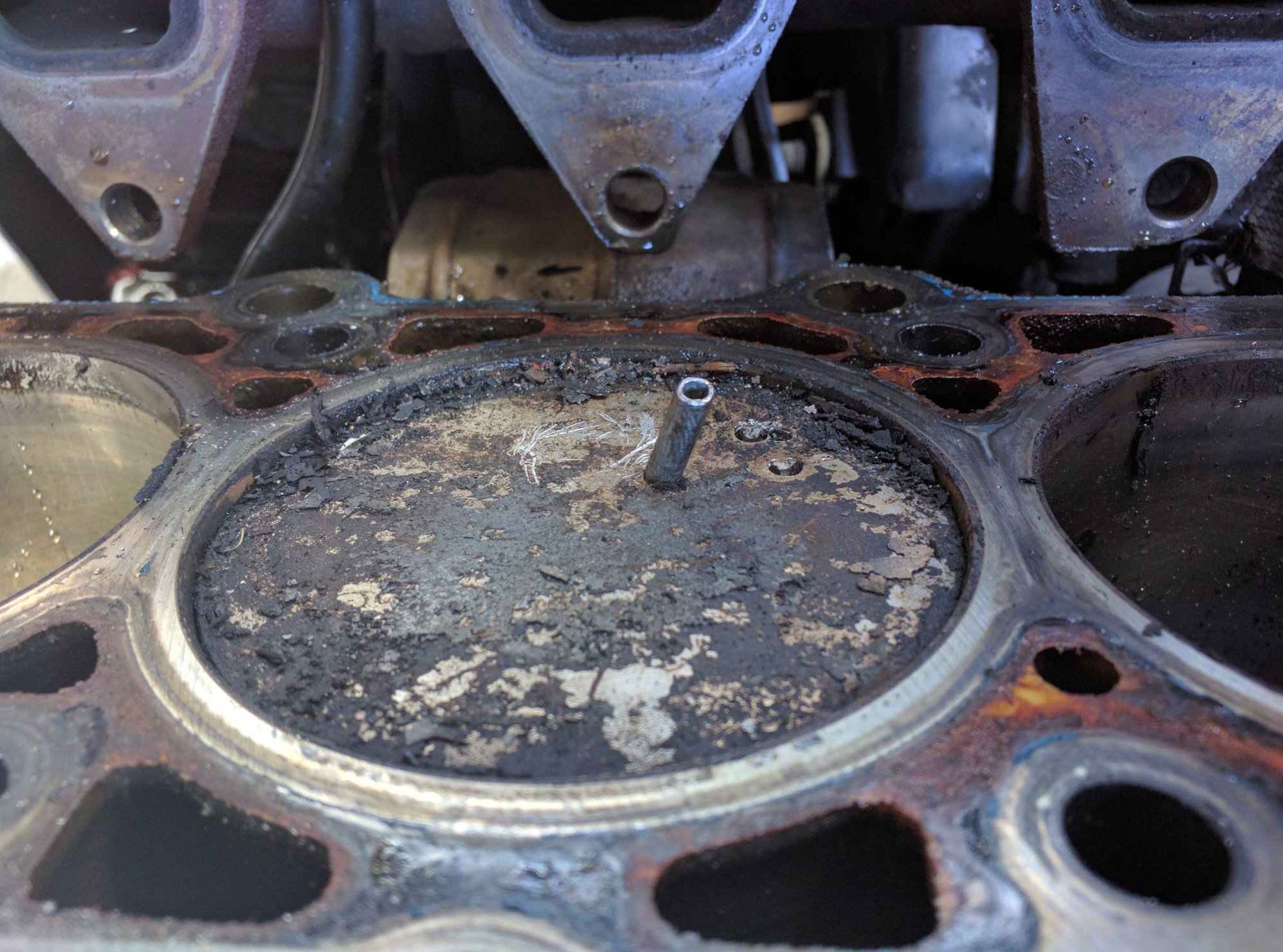

I'm guessing there is no cylinder damage. But, you may need a new/rebuilt head. One piston, rings, rod and bearings for that one cylinder and you should be good.

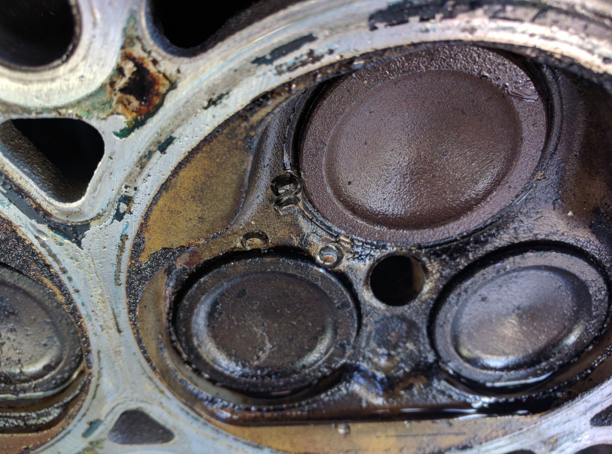

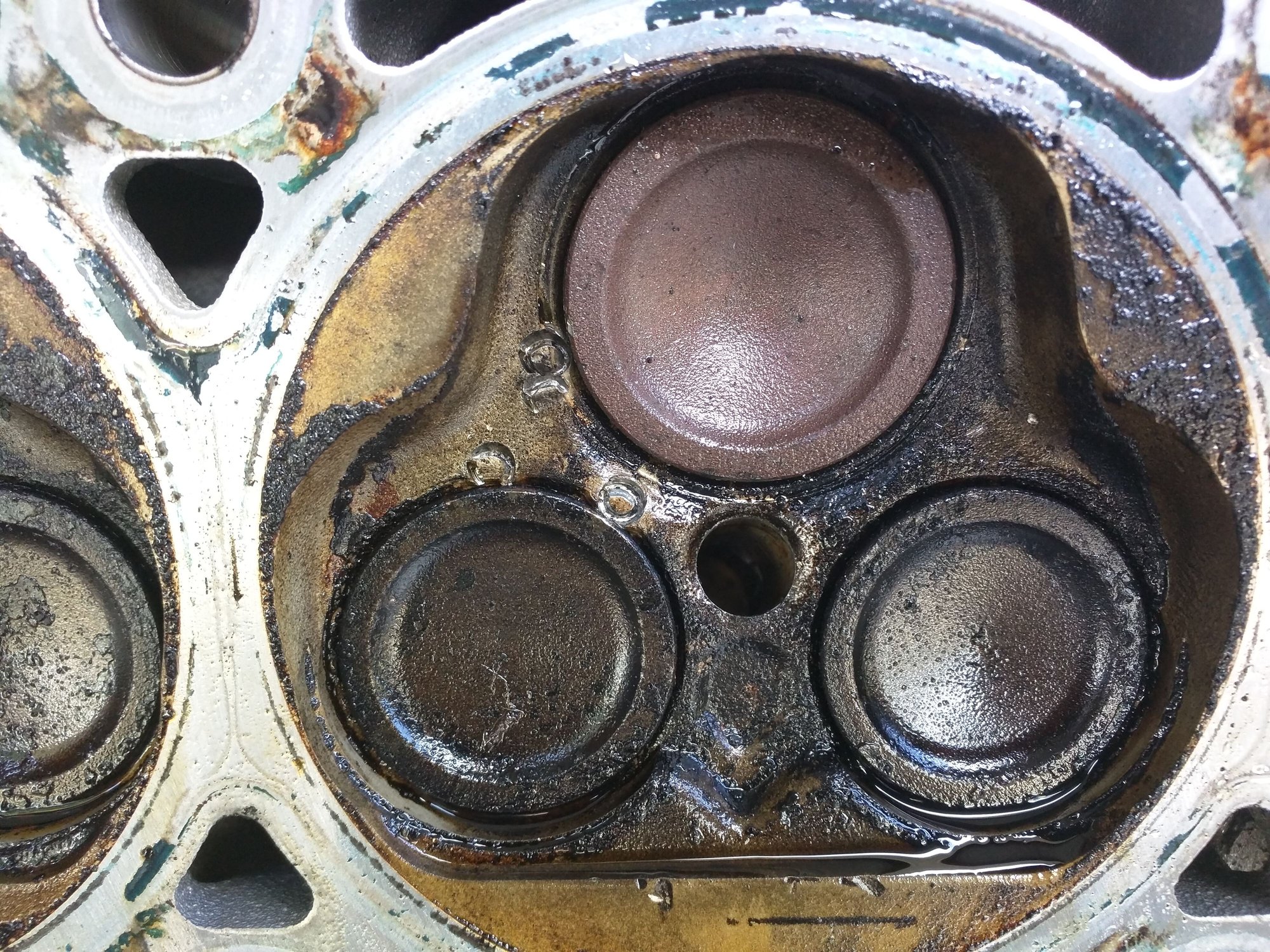

The damage to the cyl head is not good obviously and I see at least one crack in the exhaust valve seat. So you need to have the cyl head checked out for obvious reasons. The head gasket is not a factory gasket so the heads have been off before and that is probably how that roll pin found its way into the combustion chamber as debris. You need a new piston as well. Head may be repairable. But for sure the exhaust valve seat is damaged and needs to be replaced. Good luck.
The cylinder looks very good. No damage can be seen, just normal wear for about 113k miles. I can actually still faintly see the factory cross hatch from when it was new.

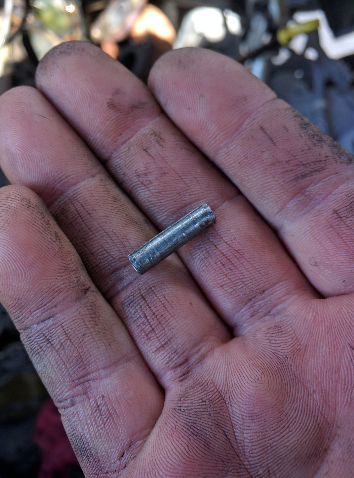

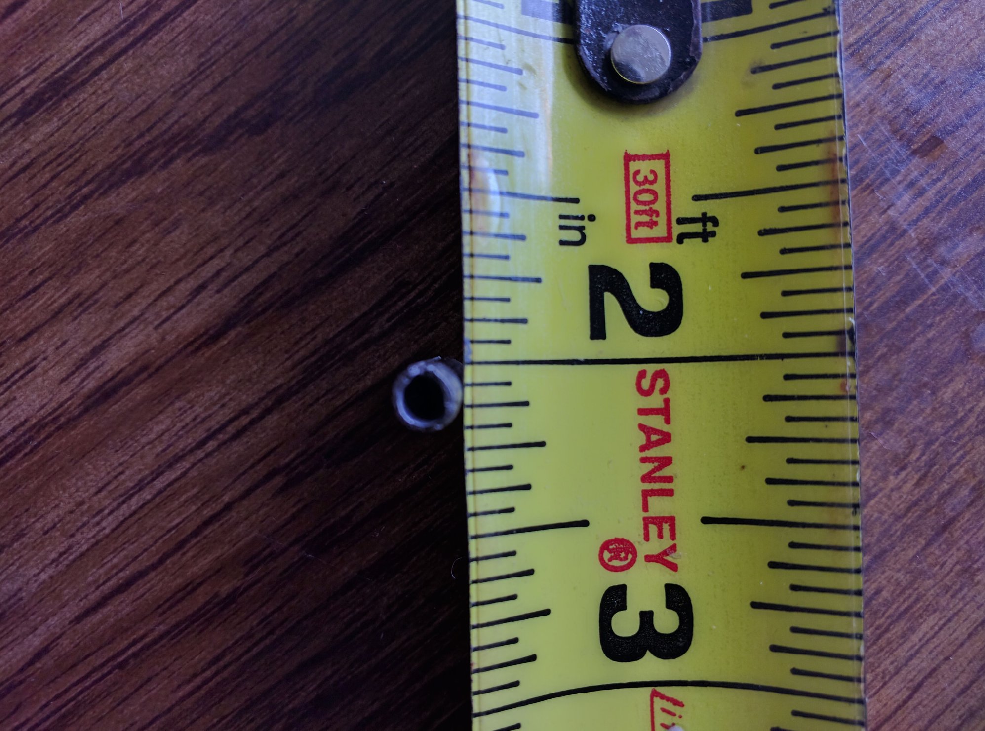

The head gaskets are factory. I purchased this truck brand new in December of 2006. I can assure you that it has never had the head off before. Nothing on the engine was replaced except for spark plugs, thermostat, and alternator.
I have a idea of how the roll pin got there. Many miles ago, I replaced the sparkplugs at the same time as I replaced the alternator. I pulled the COP's and changed the plugs, then changed out the alternator before reinstalling the COP. While changing the alternator, I was using a Milwaukee cordless impact and I also had a 3/8" drive universal joint between the impact and the socket. The universal joint broke under the force of the impact. Pieces went flying around from the universal joint. Now, I'm pretty sure the roll pin from the universal joint settled down the spark plug well and sat for many miles without problems next to the spark plug, but I never knew it was there....fast forward to this go around of changing spark plugs...I pulled the spark plug and the roll pin fell in the cylinder, but i didn't know it. Replaced the spark plugs and fired it up....BANG BANG BANG BANG!!!.......AH ****!
