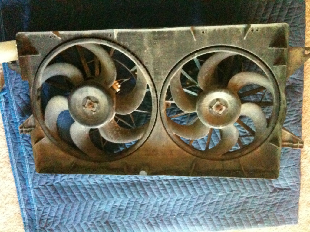

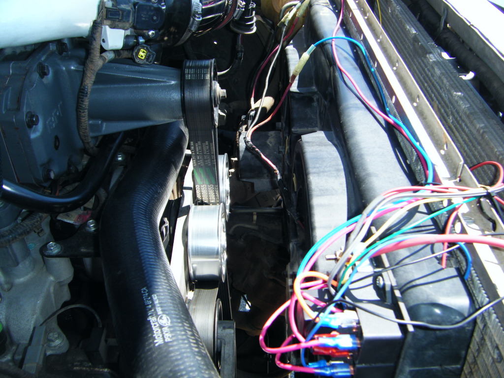

i wouldnt say they are worth $600. but i picked up some fans off a ford windstar for $60
and bought a controller for $140. you can even do it alot cheaper than that too!
Is the 2nd picture what your final setup looks like? What keeps your wiring out of the serpentine belt, or chaffing on the radiator?

that was right after i got done with it.
the wire isnt close to the SC belt, and there is tubing around the wires now.
