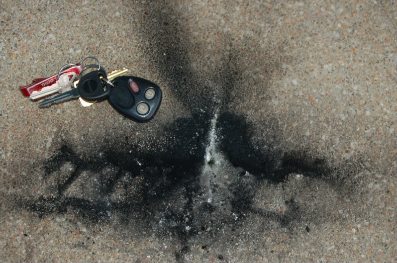

I called the wife out to turn the key over so I could get under/over the truck to locate the source of the sound. As she's walking out to me, we both notice a strange smudge on the driveway. We walk over to check it out and after staring at it for a second, it clicked in my head. My truck was hit by LIGHTNING while I was gone on vacation. Further inspection of the truck shows that the lightning entered at the radio antenna and exited at the front passenger side rim. Sooooo....the root of the issue is now at rest. Lightning.

BTW, here's a picture of the lightnings point of entry into my concrete driveway with the keys for size reference. The hole appears to go all the way through the concrete.
Oh yea it happens. Lightning nailed a tree next to me and stripped the bark off it, just the bark everywhere, weird as hell looking. Then about 5 seconds later it struck a concrete curb about 15' in front of me. Blew about a 2' section and over half the of the curbs thickness off, - all the way down to the re-rod, then stopped clean lol.
