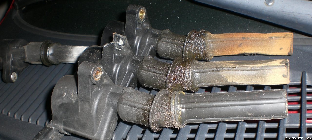

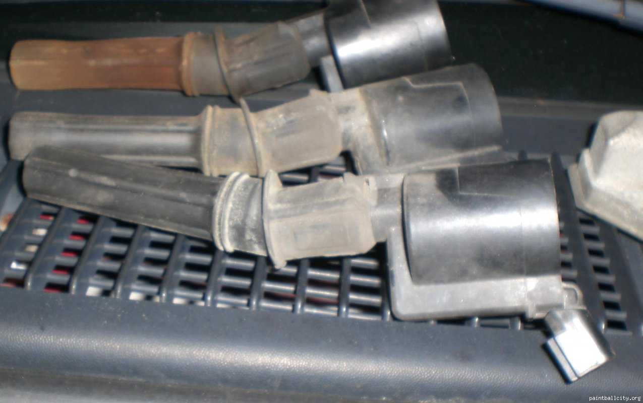

So today I got into this motor some more. I found that the boots were extremely dirty. Here's a photo of what I'm talking about:

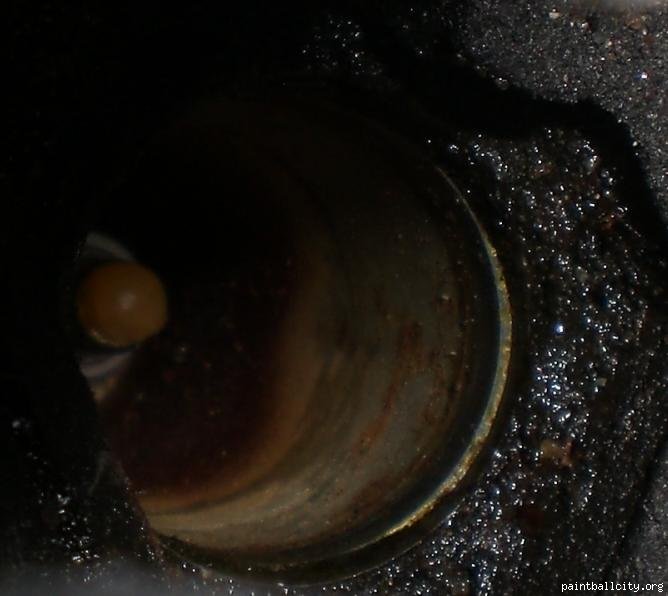

The 2nd photo, it's white from where you can see, to the bottom. And looks to be some rust in the 3 cylinder.
Here's the best part, when taking off cylinder 1s spark plug, it had 5 foot lbs torque.

Looks like you just dodged a bullet on cylinder 1, sounds like it was about to blow out. Cylinder 3 is getting moisture in it somehow. Looks to be moisture (along with a ton of gunk) around that cylinder. Make sure there is no heater hose leaking above or anything else. When you re install the cop's, make sure and put dielectric grease inside each boot (remove them from the cop) and clean the spring ends off real well after the boot goes back on so no dielectric grease stays on the spring. Also, when you have the boots off, look up into the cop where the post is and make sure theres no build corrosion, like this...
If so, clean them real well with electrical cleaner (possibly light sand paper) and a q tip.

Where is all that oil build up coming from? Are the valve cover gaskets leaking? If your going to clean all that up, make sure and leave the plugs in. Vacuum out the wells before you pull the plugs.

The cylinders are dirty/damp looking from some of the coolant leaking when I took off the TB. I'll have my air compressor fired up and cleaning out those cylinders and all that gunk before removing all the SPs.
