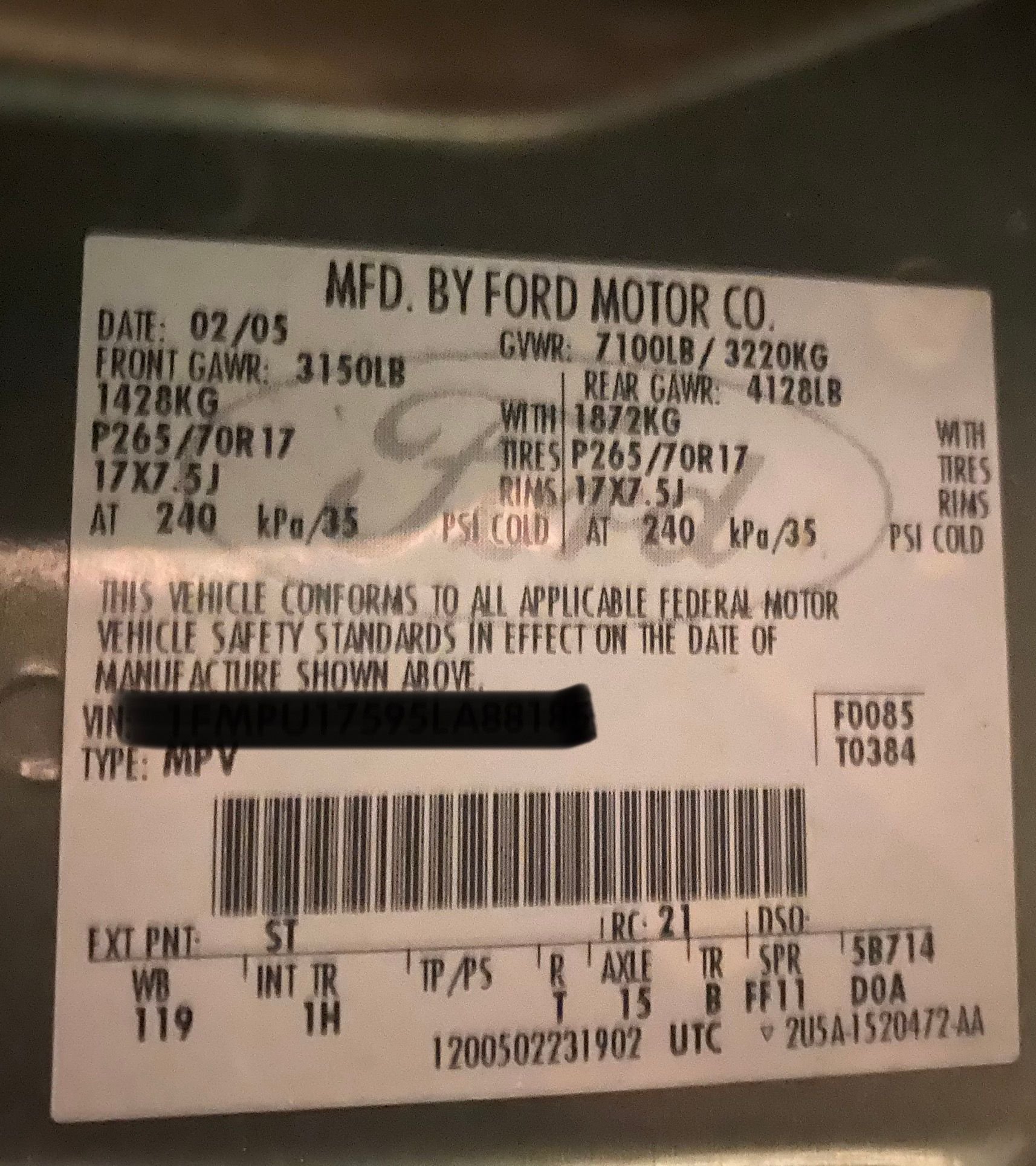

Hi
I have a 2005 Expedition 2wd. The O/D isn’t working and I was looking to get a used one due to covid I
don’t want to spend the money now to get it rebuilt. I found a 2007 f150 4R75E. I have heard conflicting things that it may not work because the connectors changed. Does anyone know if the 05 and 07 are the same before I purchase it. Thank you for the help

Are they both 2wd or both 4wd? If not, they are definitely not interchangeable.

They are both 2wd
