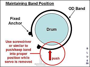

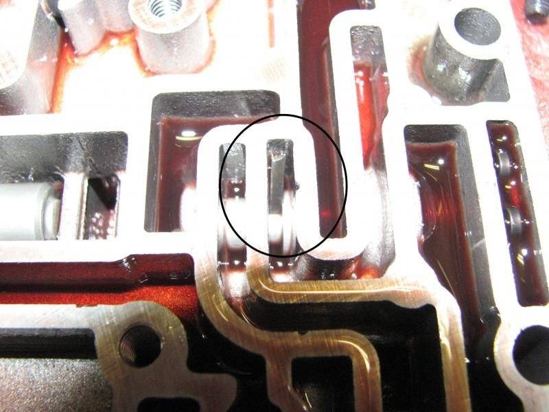

did you remove the separator plate and make sure there was no snap ring debris jammed in the OD servo regulator control valve?
Also, you need make sure the OD servo pin makes contact with the OD band. I use a old hack saw blade and push the band up into position.
Attached Thumbnails Help!  Changed broken snap ring and STILL slipping to neutral-push_zpsfrtrdg43.jpg   Help!  Changed broken snap ring and STILL slipping to neutral-picture_php_pictureid_175492_1bd0ef193947fca049a232e58d4579bced965796_zpsuz8bq6cu.jpg

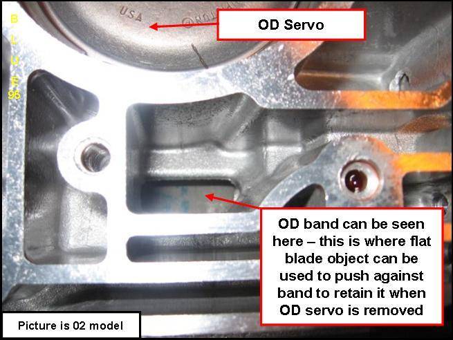

forgot this picture too...
Attached Thumbnails Help!  Changed broken snap ring and STILL slipping to neutral-blade_zpsug6kdutq.jpg

Thanks the pics and explanation are really helpful. i did remove the separator plate and found one small piece, i pretty much put together all the pieces of the band from what i could tell...when i open up again i'll check that area that you circled to be sure there's no more.
I think I'm going to play it safe and order the 4l60e detent roller since i've never done this before...i just have to figure out why some of them on ebay have a bolt and others don't. I'm planning to open up in a week and a half, hopefully properly placing the servo will take care of it.
