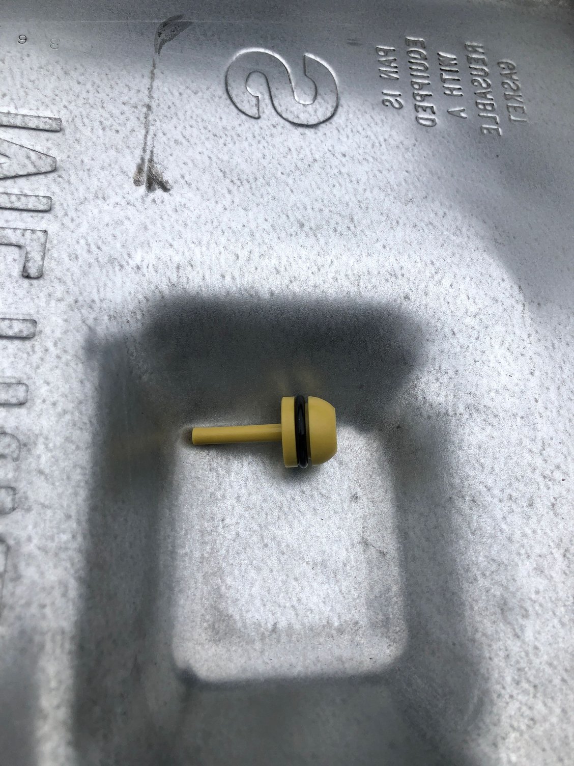

They put that in there to let you know if the pan was ever removed to service the filter unless the guy put it back in there thinking it needs to be in there. LOL Great pc to had if you are removing a trans to plug up the hole.
Old May 27, 2015 | 09:33 AM
  #77
Posts: 43,535
No, that's a dust plug which gets knocked out when the dipstick tube is installed at the factory.

You right, Great to have if you are removing the trans and want to plug up the dip stick tube hole. is what I should have said!
Old May 28, 2015 | 03:45 PM
  #81
Posts: 43,535
Now THAT makes a lot of sense! LOL! That's where it came from to begin with!

Here is Yellow plunger in tranny pan
Folks asking what it looks like, this is mine from my 2006 F150, guess it makes me the cherry pan popper of my truck lol
