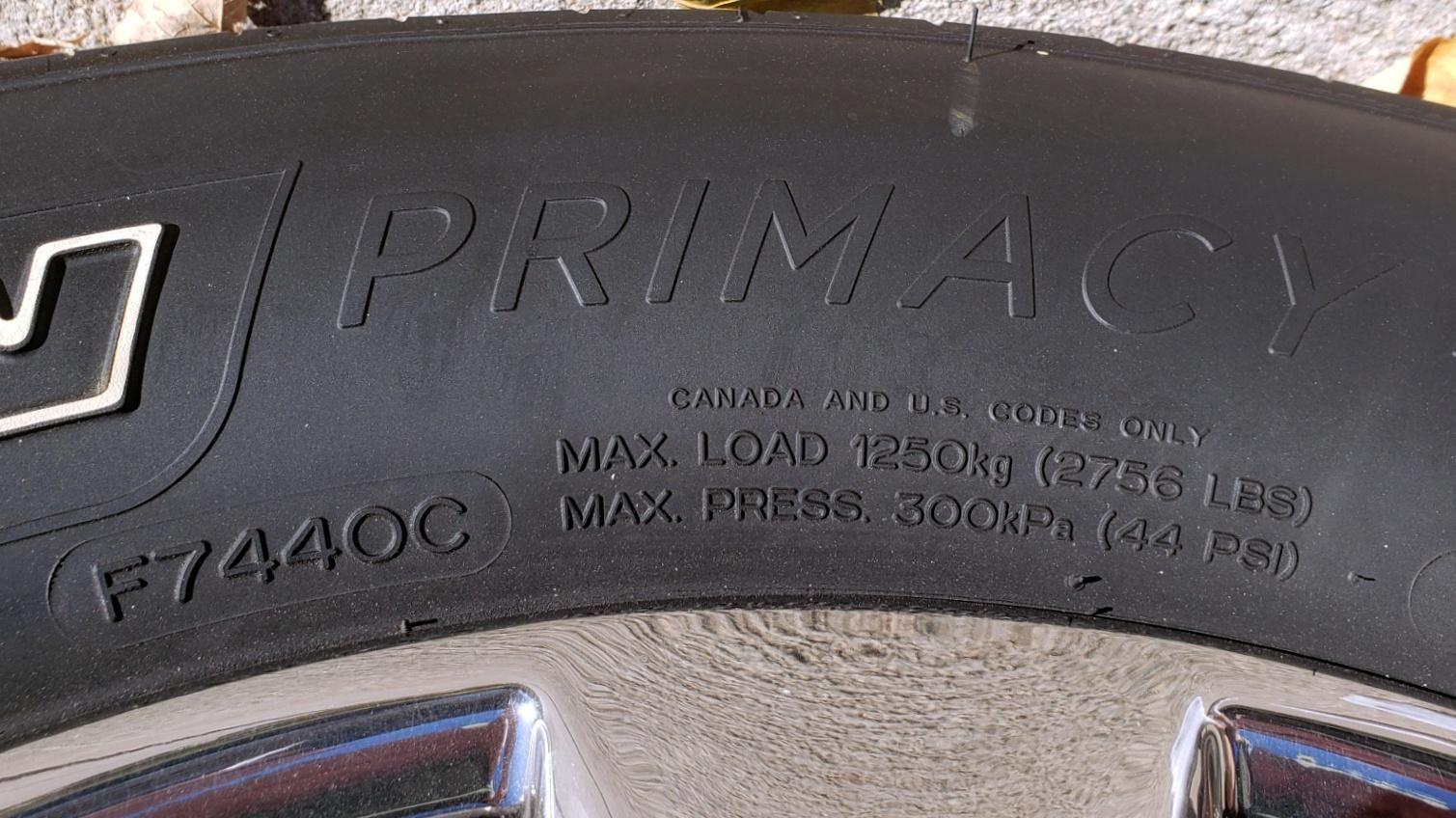

I expected to see "Load Rating" on the sidewall. This is what I found:
https://imgur.com/gallery/5Ar0Dqh
Is E-2 a load rating?
Old Nov 8, 2020 | 09:48 PM
Posts: 43,542
Likes: 819

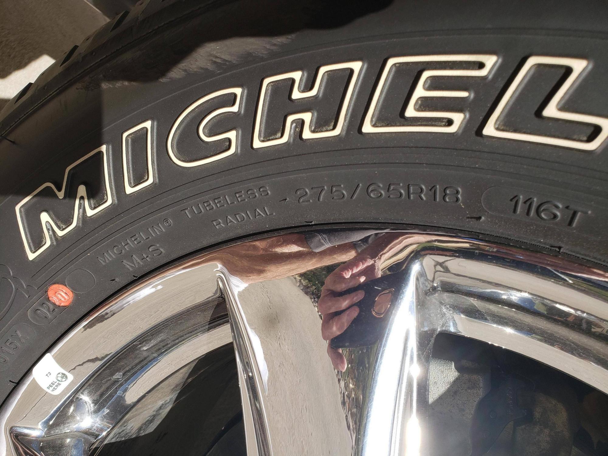

No. What is the exact brand, model, and complete size designation? Maximum pressure marked on the sidewall and what pressure are you running?
Examples:
P275/65R18
275/65R18
275/65R18XL
275/65R18LT
If it's LT, there will be a LR C, D, or E on there somewhere.

275/65R18 116T

Come on, would you please answer all the questions?
What model Michelin? What is the max pressure on the sidewall and what pressure are you using?

Michelin Primacy XC
Max Load 2756 lbs
Tire pressure at 35 lbs
https://imgur.com/gallery/8G1QlA5
Old Nov 9, 2020 | 12:25 PM
Posts: 43,542
Likes: 819
Those should be good to go, but I think I'd increase the pressure when you are towing. That load rating is at 44 psi.
