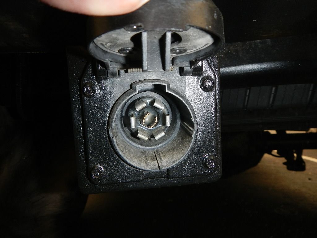

This Kit has both the Controller and that plug-in wiring adaptor that is "Plug & Play" kind of?
My truck is already wired for lights to the trailer (see attached)
So if my current truck to trailer wiring at the rear bumper is installed correctly... All I would need is this: Tekonsha Prodigy P3 Trailer Brake Controller & Tekonsha Plug-In Wiring Adapter for Electric Brake Controller installed?
Also... is my Trailer Electrical Connector a 6 pin or 7 pin? Does the Center one count as the 7th?

You need exactly what I linked. The adapter cable plugs in between the controller and the socket under the dash. Plug and play, you may need to install trailer tow relays and fuses. Yes, that's a standard 7 pin.
