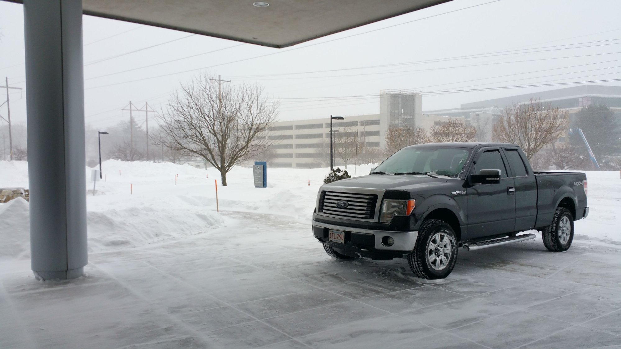

I have a 2012 XLT 4x4 Supercab and am looking to do a level/buy new tires. I have the 18 inch stock rims and tires on it now but want to do the highest level possible with the biggest tires possible. What would be good combos using that 18 inch rim?
Here is a pic of it currently. Thanks!

Anything larger than a 2.5" level will wear out front end components much faster. Also, if you want it level and not nose high, you need to measure from the center of the center cap on the wheel to the fender arch and determine how much higher the rear is. Your truck doesn't appear to have too much rake so a 1" or 1.5" level may be all you'll need to make it sit level.

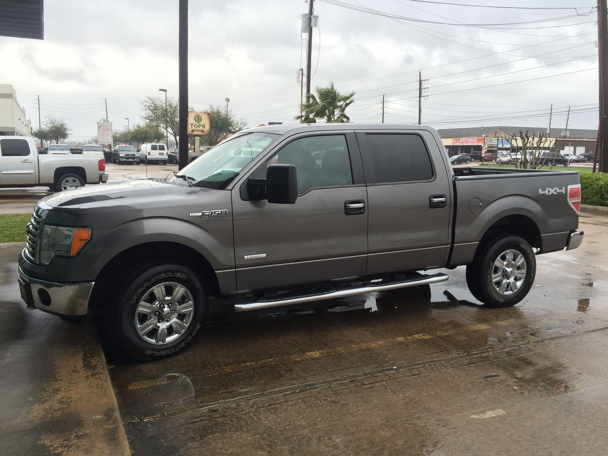

Nice truck! Your truck looks like it already has a level kit, maybe it's just the amgle of the picture. I just bought me a 2012 4x4 super crew. I have the procomp 2" spacers coming in. Should put my front about 1/4-1/2 lower than the rear. Also remember that tire size effects how high your front will go when you put in spacers. Bigger the tire the higher it's going to be. I'm am going to run 275-70-18s to keep tire weight and cost down.

Hey thanks I like your truck too. It's on a slight upward incline so that's why it looks like that. I am gonna get the same tire size by Nitto Trail Grapplers, what are you getting?

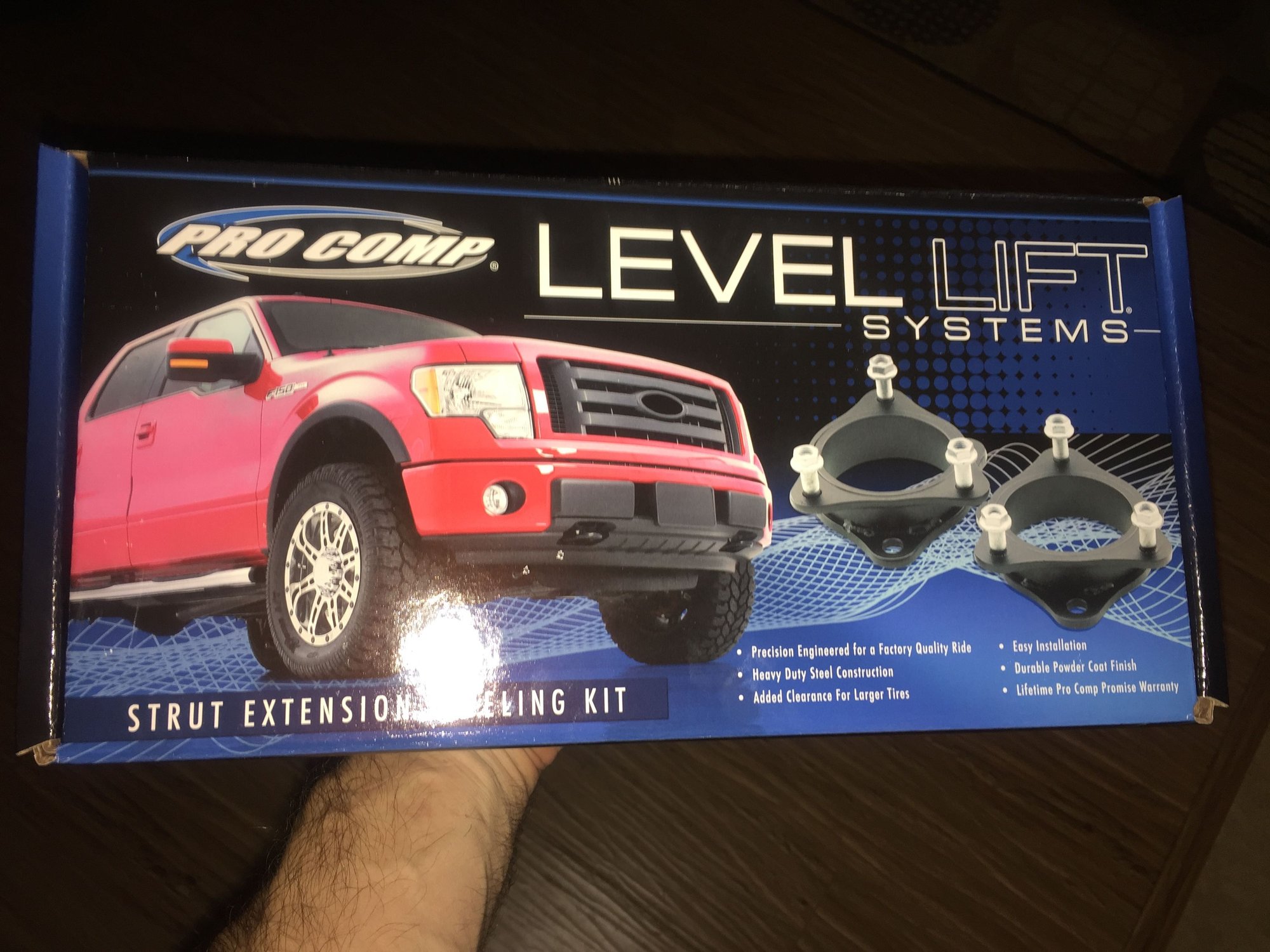

Posts: 15
Goodies came in today!

Old Mar 11, 2016 | 11:38 AM
Those will work great with some 33 or 34's on. Best thing you can do to change the stock appearance of these trucks.

I will be installing them tomorrow. If I didn't have new tires that came on the truck I would put on some tired tomorrow as well. I'm going to go with BFGs 275-70 18s. Wouldn't mind going up a hair more but I belive that the 275 70 is like a 33.4 height which is fine with me.
