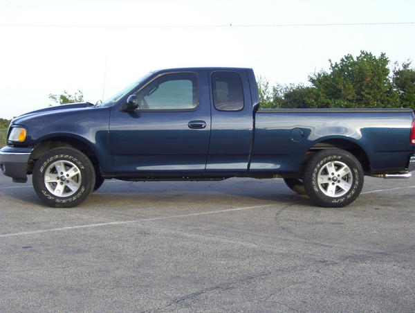

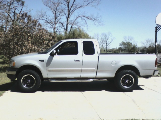

97-03 4x2
Leveled - Courtesy of 1clean42

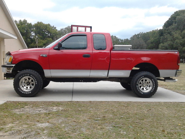

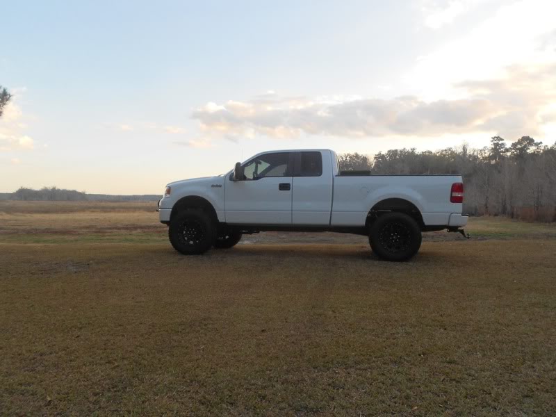

5" on 33's - Courtesy of GaNole07

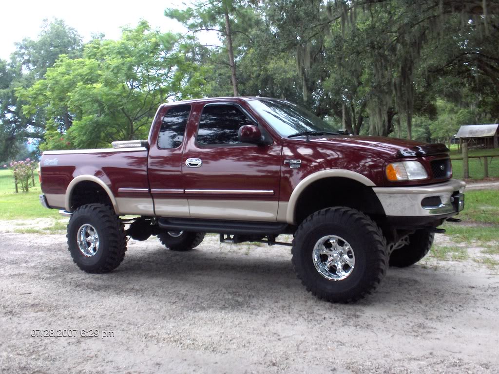

12" on 37's - Courtesy of GATOR CREW

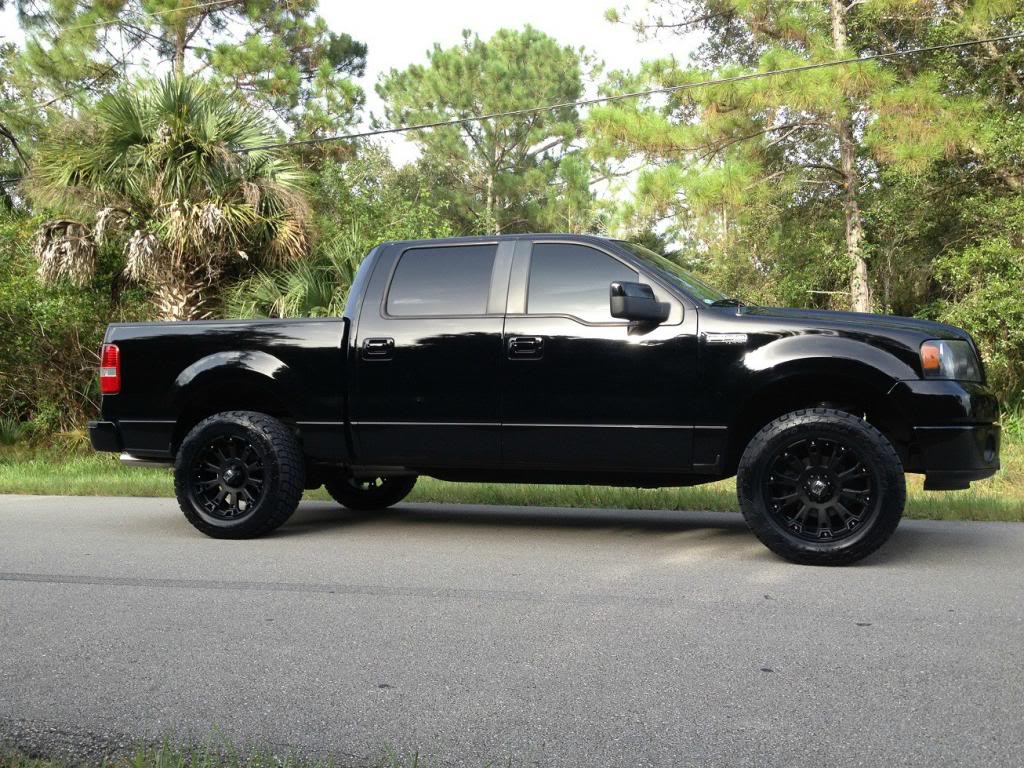

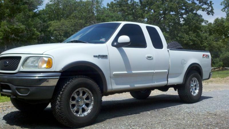

97-03 4x4
Leveled on 35's - Courtesy of woopigsooie

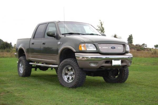

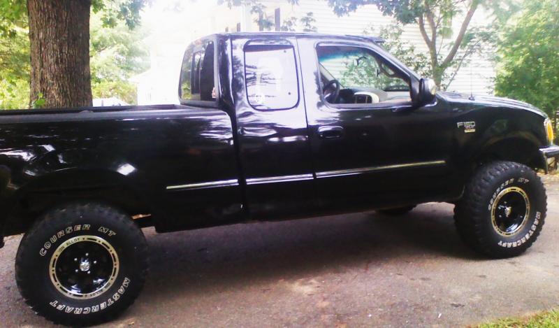

6" on 35's - Courtesy of 03KingRanch03

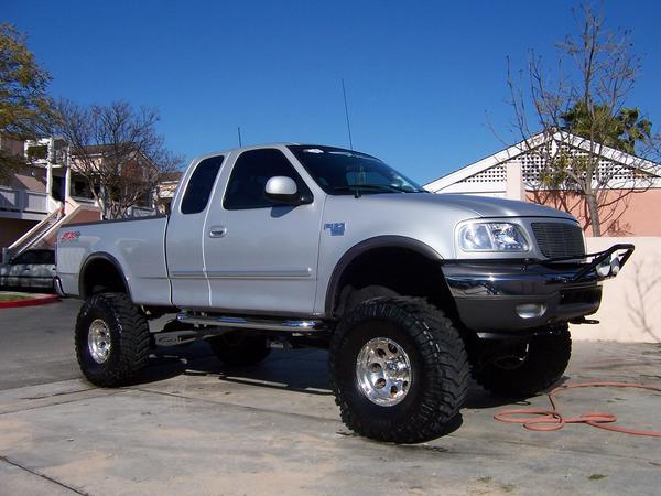

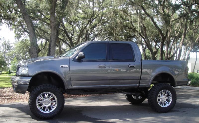

9" on 38's - Courtesy of JASON'S98S/C4X4 38's

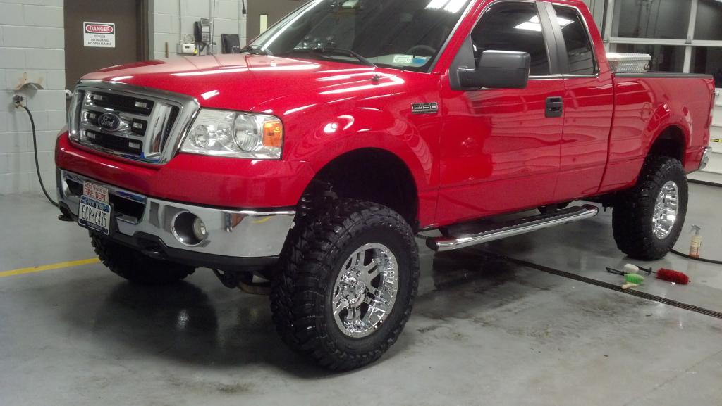

04-08 4x2
Leveled 2.5" - Courtesy of BMWTech

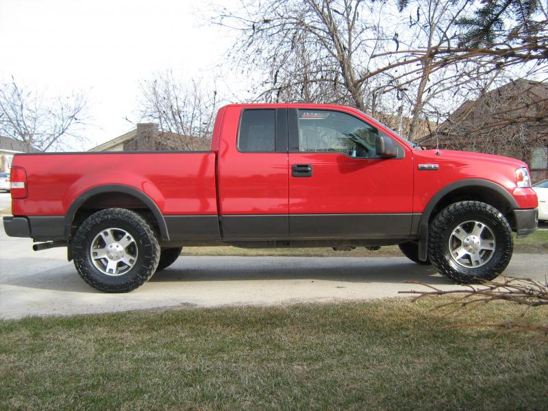

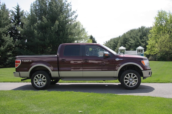

04-08 4x4
Leveled - Courtesy of MJG-FX4

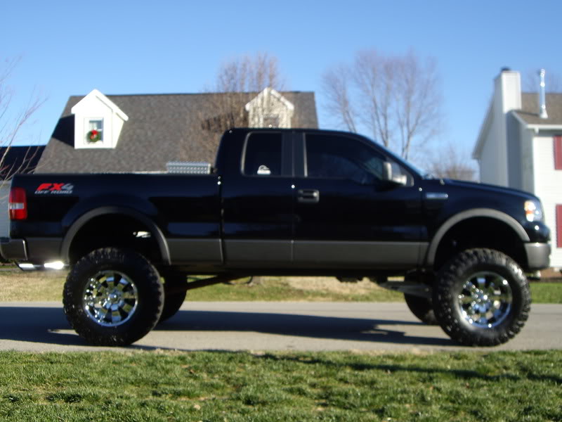

10" on 39.5's - Courtesy of Mark Mayes

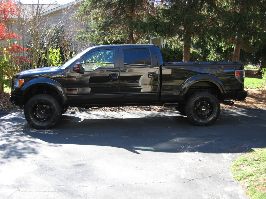

09-13 4x4
Leveled 2" - Courtesy of 2009KR
4" - Courtesy of Desert Dawg

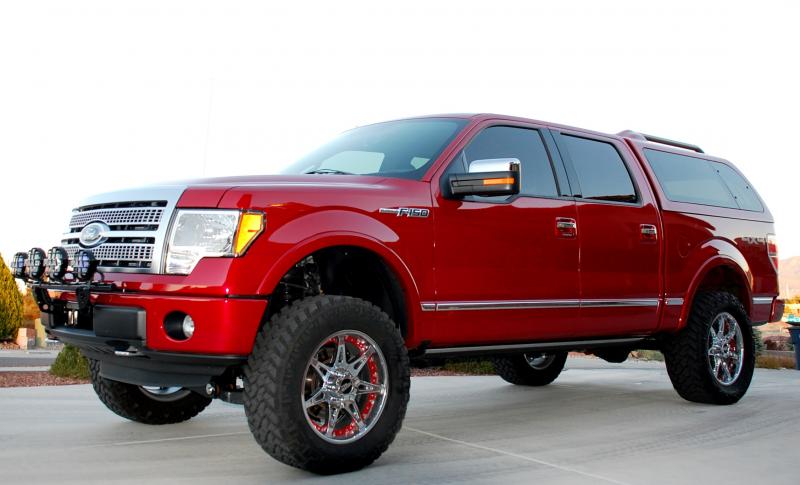

6" on 35's - Courtesy of TimeLessr1

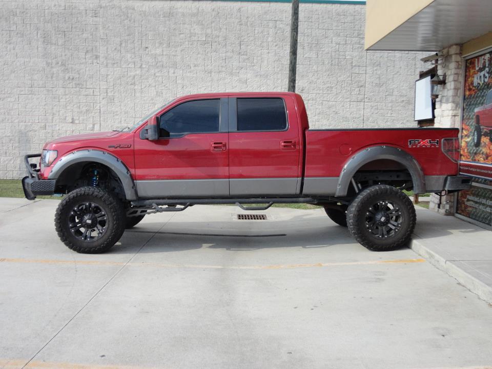

8" - Courtesy of
10" - Courtesy of fx4 for life 79
