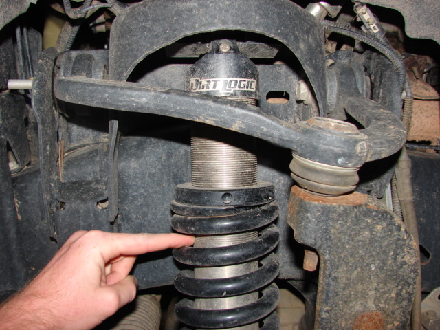

Long story, but I have redesigned coils Fabtech had made for me due to complications with the original ones. The new springs are a few inches shorter, so the cap on top of the spring is already tightened down. I don't think there's enough room to get close to 2" of lift out of them. And I learned the hard way that there's not a shop anywhere around here that can compress the springs and tighten or loosen the cap above the spring. I must have tried a dozen places. It was very frustrating. Here's a thread that explains what was wrong: https://www.f150online.com/forums/su...er-owners.html

They told me that I was the first one to identify this problem and to work with them to correct it. They finally sent me 2 new coil overs, new coils and shocks and everything. The new coil springs are much shorter than the original ones that kept rattling around. I have not adjusted the new ones at all, and they gave me the same amount of lift as the originals did. They are tightened down almost all the way. My finger is on the bottom of the threads. It looks like to me, if I attempt to crank them down to get more lift then I would only get 1/2" or so. From what they told me, all the future coilovers they make will be like mine. Did you read the thread I posted a link to?
