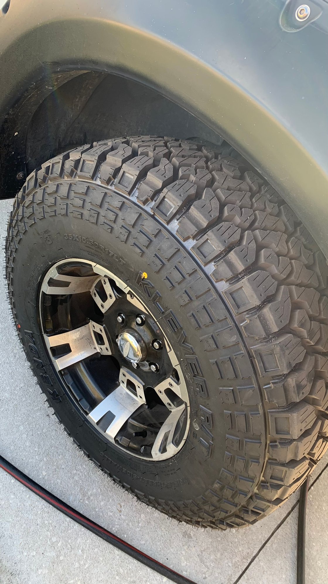

35 x 10.50 r 17 kenda klever rts, smooth quiet and pull amazing for an at
