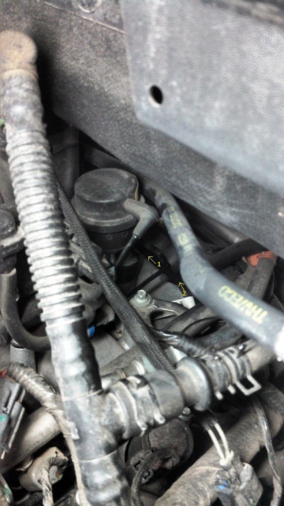

I had a hard time finding this info online and without pics or not having install the blower myself I had no idea where to hook/tap-in for a mechanical boost gauge. I tried to take a decent pick of where it's at but it's pretty far back there so I copy/pasted some of the pics from my Roush manual. If you have questions please ask and hopefully Google picks this thread up.

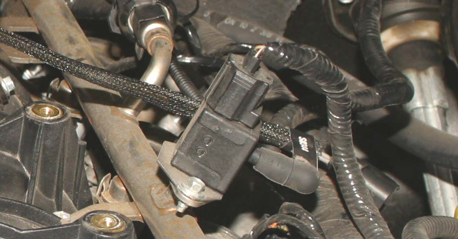

If you are starring from the front of the truck it's on the right side of the motor toward the very back and if you use the picture as reference you'll see the area you need to be around. In the BOTTOM picture #1 is the vacuum line for my gauge already hooked up but you should have a rubber cap placed over it as shown in the second picture. Either way there should be two connectors with the #2 connector already being in use by the IPTS sensor which is also shown in the second picture.
Here is the IPTS Sensor in all its glory. You can trace the side connector to where you need to be for vacuum line access.

Here is the best shot by far without the blower on. The pink/light red color is the IPTS cable and toward the back of the intake is the connection you need. It's capped off in the photo but this ladies and gents is your vacuum line connection for a mechanical boost gauge.

And finally a photo of a finished and very crowded install. It's not that hard to slip your hand back there and attach a line so you shouldn't have to disconnect the cable completely unless you want to.
Hopefully this helps put everything in perspective with multiple shots. Now if you want to know how to get that vacuum line from the engine bay and through the firewall that's my other thread located here: https://www.f150online.com/forums/20...iver-side.html

Right. Do you see the fuel pressure sensor in the first pic? See the 120* elbow that pushes onto the FRPS? Follow it behind the head unit, you should see a 90 going into the manifold? Ontop of the elbow there's a Vac cap. That's the place to tap in. Alternatively you will need to replace that hose with flexy silicone and tap into it mid length.
Edit: I think it's the hard line with the white label R07040028.
I secured the brass barb to the vac lines with lug clips (Propane connectors)
But there's no need as 8 - 12 psi won't blow it off.
I'm sorry I don't know what is what when I look at this picture, if you have time I'd love that you use paint like I did with a red arrow to show me where lol

ok I think I've located the cable you mentioned, let me know if it is good, also how do you secure the gauge tubing? with heat? it can come off easily, scary..
Old Oct 27, 2013 | 07:07 PM
Ross-FX4's Avatar
Joined: Apr 2008
Posts: 1,053
From: BC, Canada
Ha Ha Ha you nailed it.

well good news it worked! any newbie like me that wants to plug a boost gauge on a roush blower this is the right place!

sorry about that. I added the pics back but glad to see you got it working...sort of.
