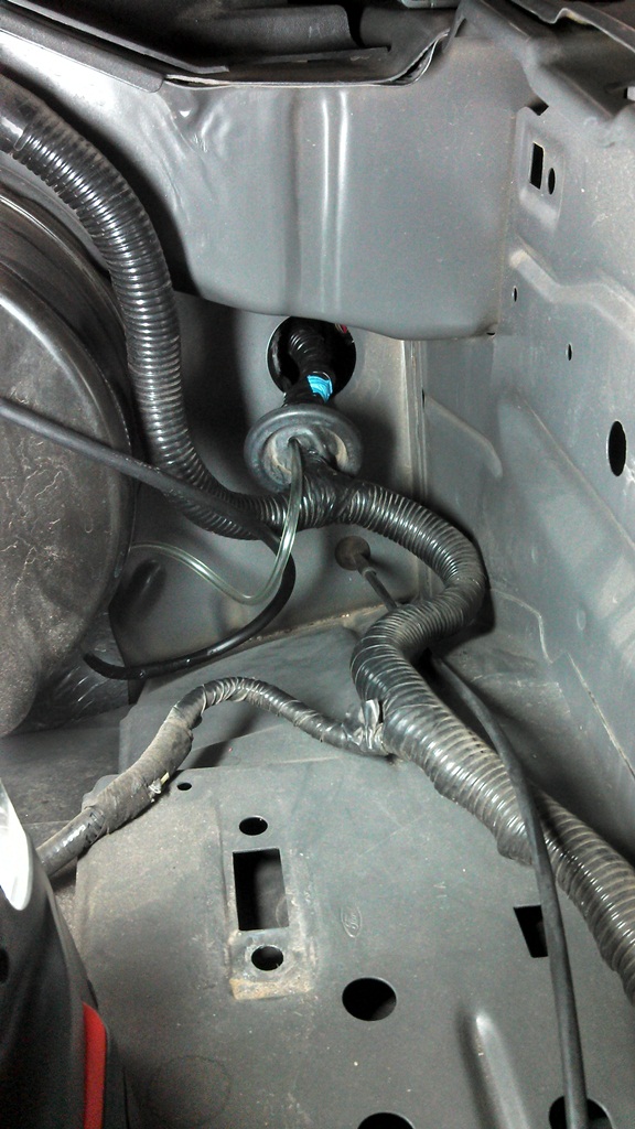

Finally got into the grommet behind the coolant reservoir. Easiest way was to take my air intake off then once I unbolted the two bolts on the reservoir it was more manageable. Once that's done get underneath the dash and look for the corresponding grommet which is behind and above the parking brake where the thicker harness is. Push out and there you go.
Now getting a vacuum hose through it was a little difficult but if you grab a decent sized flat head screwdriver and use it as a pry tool by wedging it between the grommet and harness then run your tube/wire through it was pretty easy, I also used a tad bit of brake cleaner to make it easier for the line to go through. If you have any questions ask and I'm not sure why this was such hard info to figure out cause Google doesn't show jack for this topic.
