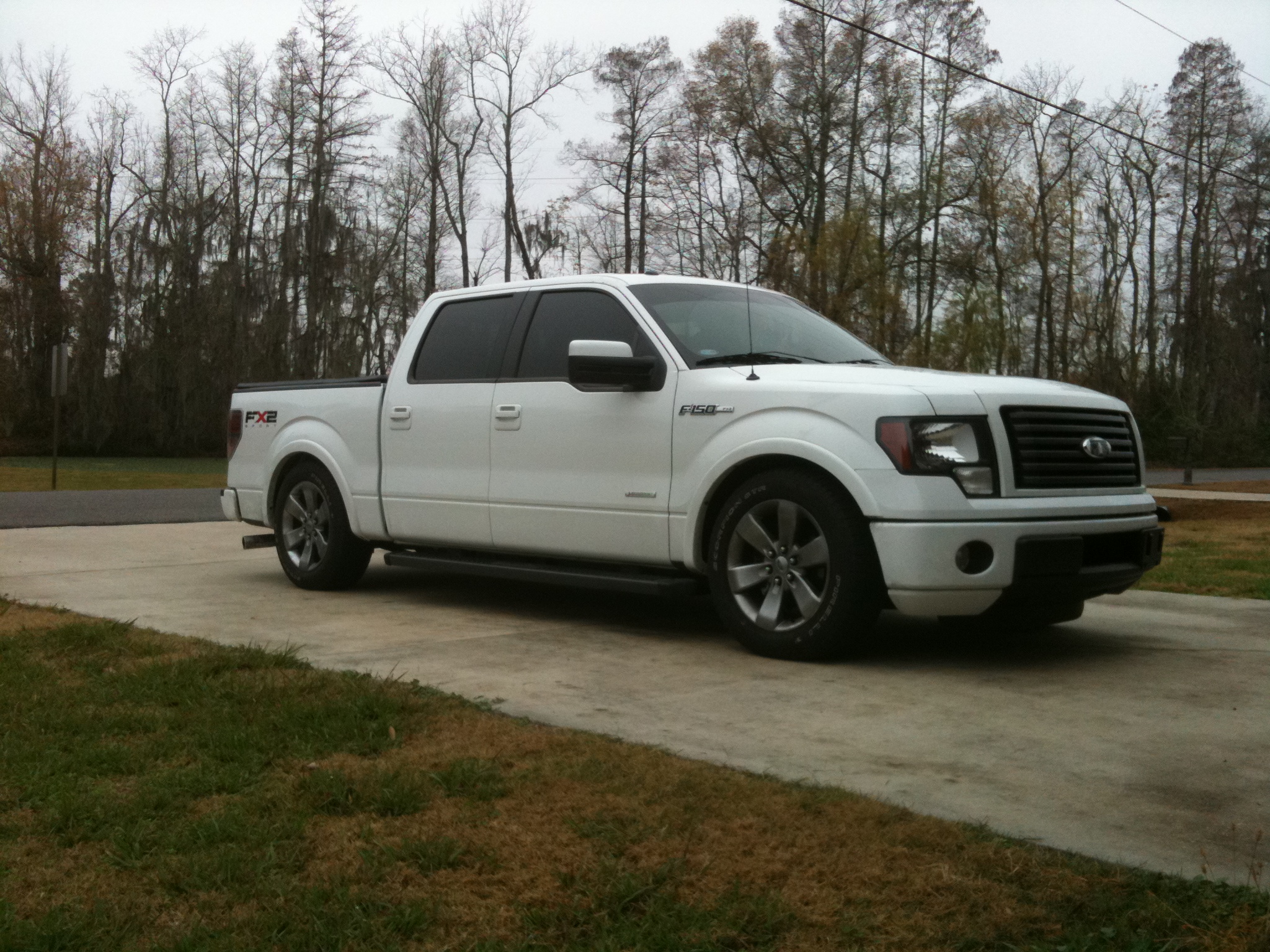

Did you go to my user profile page? I have 4 pics.
I'm at 17 front rear

Looks good...You said you used the smaller spacer in the front??...I used the thicker of the spacers and it gives me 19 in the front....Do you get bottoming out in the rear??...Your truck is EXACTLY like mine except for the year (mines a '10)...That was a Beltech 3/5??.....
Also..looks like your front headlights are tinted..How did you do that??

Yea 3/5 belltech. I used smallest ring spacer.
I did cut the plate under the bed. And that spacer said I needed to use Iy according to directions but I left it out. My buddy is going to make some shims to try and we will modify that spacer to see what happens. I have very very very small vibration on a hard throttle from a stop.
My headlights are like that on 2011 fx models. No bottoming out problems so far today, except pulling into a store with a high curb I turned in to fast.
