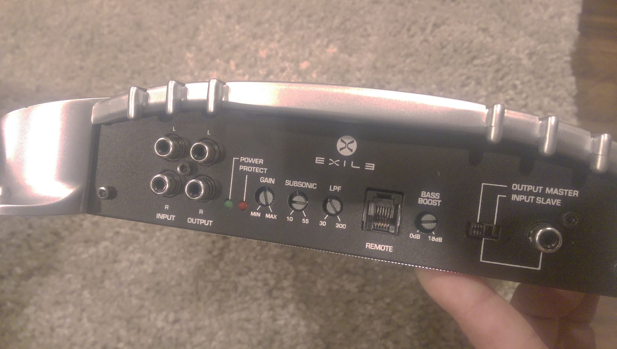

The Two amps I have are,
EXILE X1200.1 and
EXILE 600.4

Also whats the best way to wire this all up,
the amp is a bit overkill for my sub, will it be okay? should i add another type R 8"? sound better?
How could I wire up so that two subs where different channel on the mono amp.. if i got two subs..
