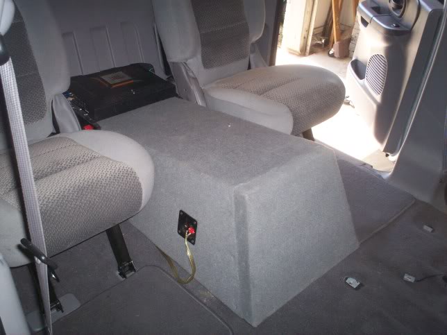

You can always put one behind the back seat like I did.
Theres more pics at the link below.

Mark-- That looks great, I like how you have it and you can't see a thing.

andy, very clean supercrew..definitely a nice set of rims, good choice...
mark, clean install, stealthly, unobtrusive and simple,

Mark, that looks great. I am planning something pretty much just like that. The only thing I think would look better is if the box was about 1-2" taller and your cut was up above the access panels so you didn't see the cutouts.
I have a Kicker SL7 8" that should fit right in the behind the seat. And I have a Kicker 550.2 I am gonna push it with.
I didn't want to do under the seat because of storage issues. So behind the seat where that panel is seems to be all wasted space anway. Great job guys

Hmm...That is very tempting but I'm hesitate to start cutting. Do you have any pictures of the installation with both seats all the way down? I'm wondering if I could get away with that setup with my 2 crazy dogs in the back (with the seat down)

I couldn't make the box any higher because the trucks frame gets in the way. When i get a little more time however, i will cut the access panels and glue them in. I bought the back panel from a junkyard for $60 so its a little scratched and, well, the wrong colour infact. My interior is dark grey and the panel is light grey(Only one in the city that wasen't tan). So ill probably end up painting it and putting in my old plugs for the screw holes from my other panel. When you do make yours however, make sure the box is atleast a quarter inch smaller than the open width-wise, thats what i did and after i put the carpet on its a hell of a tight fit. It takes two people and a couple of screws as handles to get the box out. Needless to say i'm not too concerned about a thief trying to steal it cause he'll have a hell of a time trying.
Also, there is a gap on both sides of the box at the bottom where the back panel flares out as it hits the floor of the truck. Makes a good handle and a good access point for reaching in and unplugging the wires.
I'll take one tomorrow if i remember, but with both seats down you could only install one of the two smaller panels that flip down with the seat. The bigger of the two panels that flip down would fit, but the sub is in the way for the smaller panel. Also i don't know how crazy your dogs are but they might end up wrecking the sub somehow.

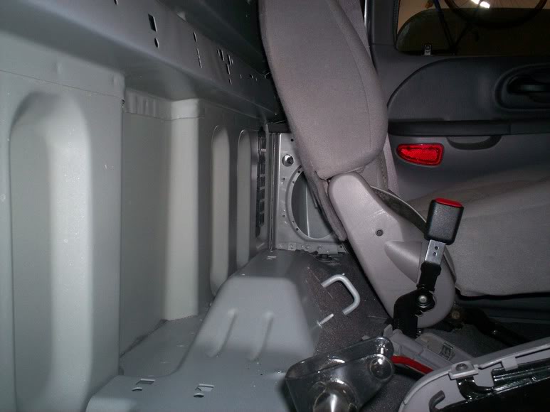

I made up my own approach to put two 12s in a supercrew back seat
(more pics in link in my sig)
Without front seats installed
With front seats, but interior is dirty
Oh and here is the frame work that mark was talking about
