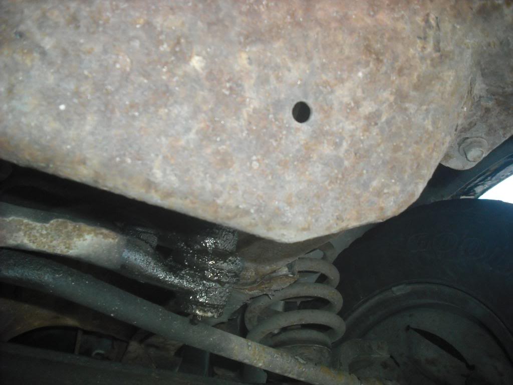

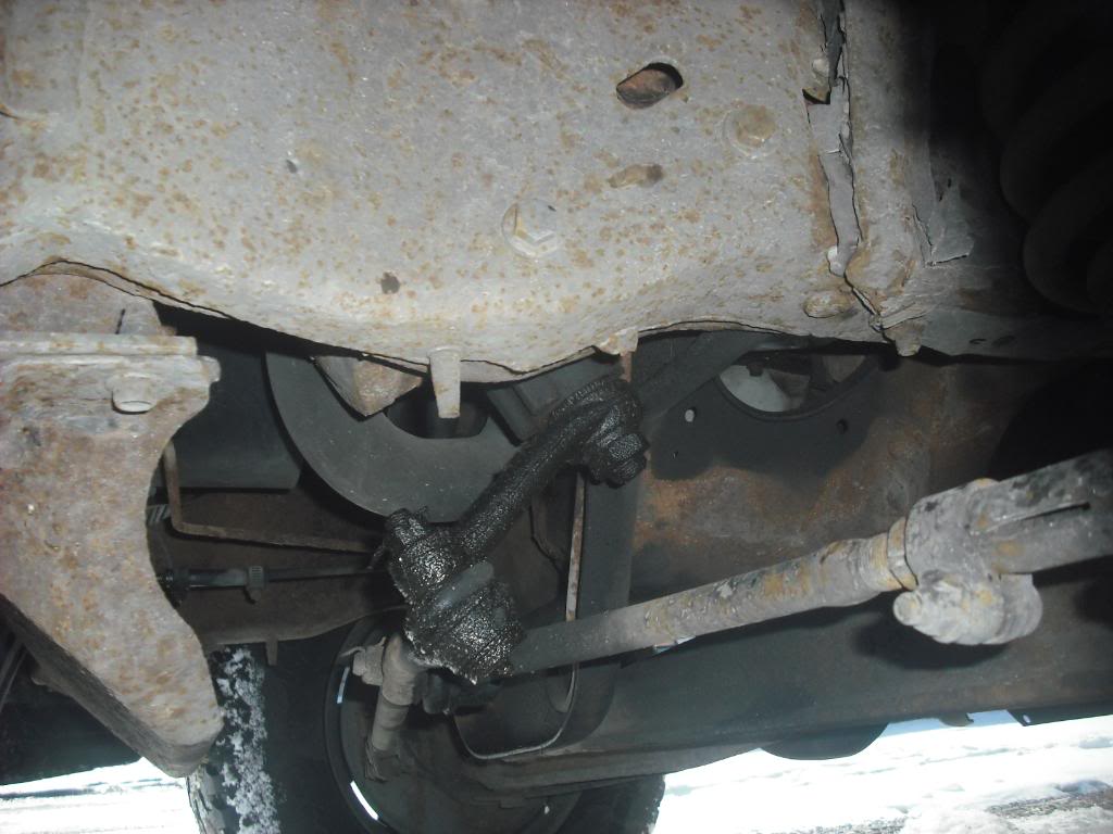

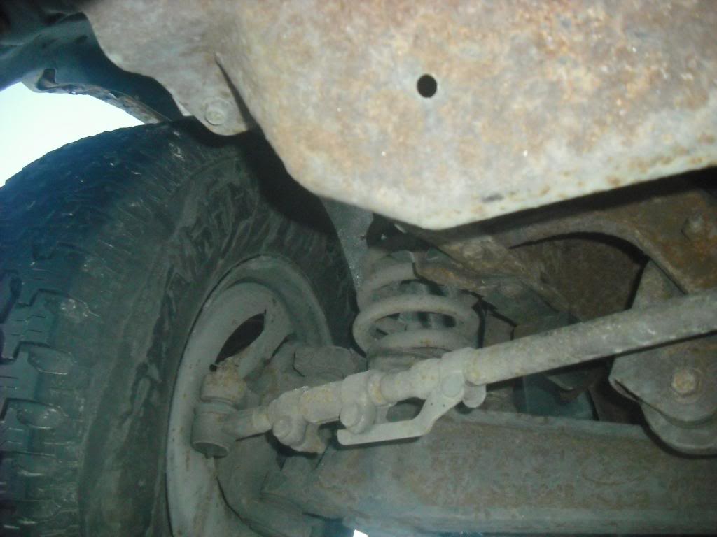

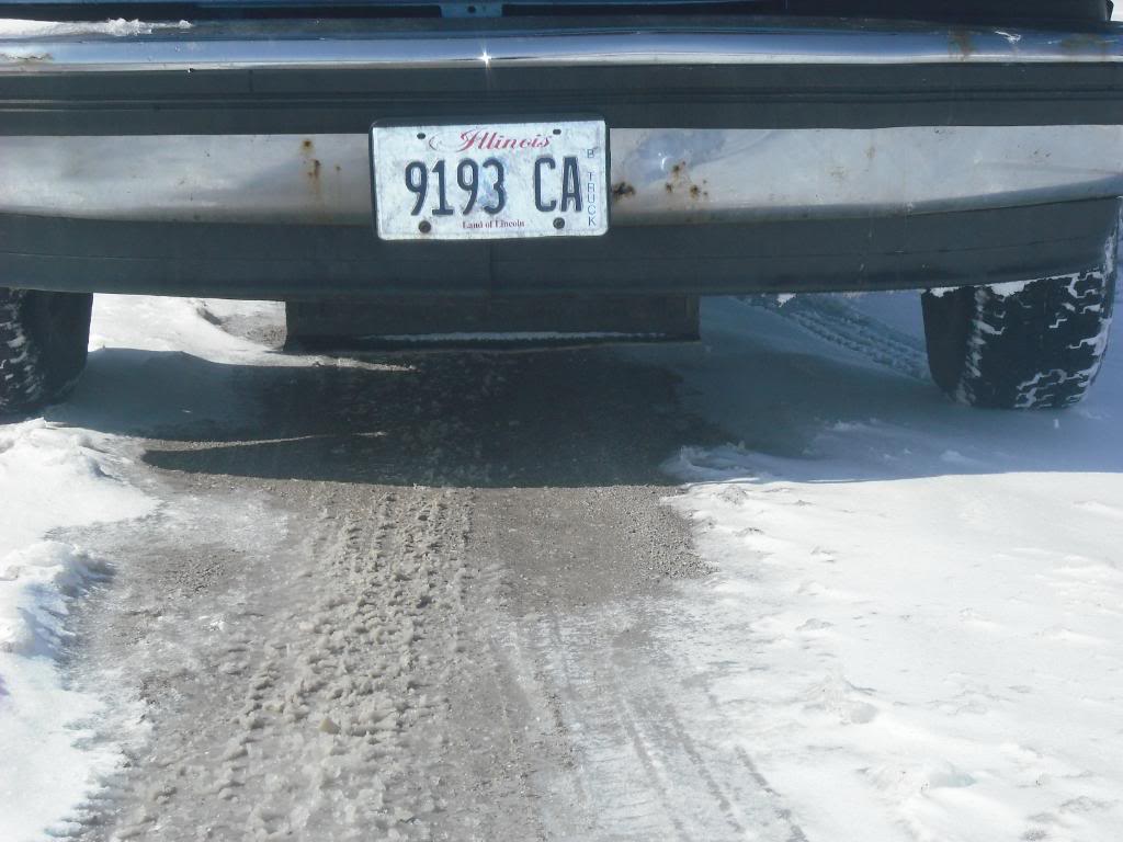

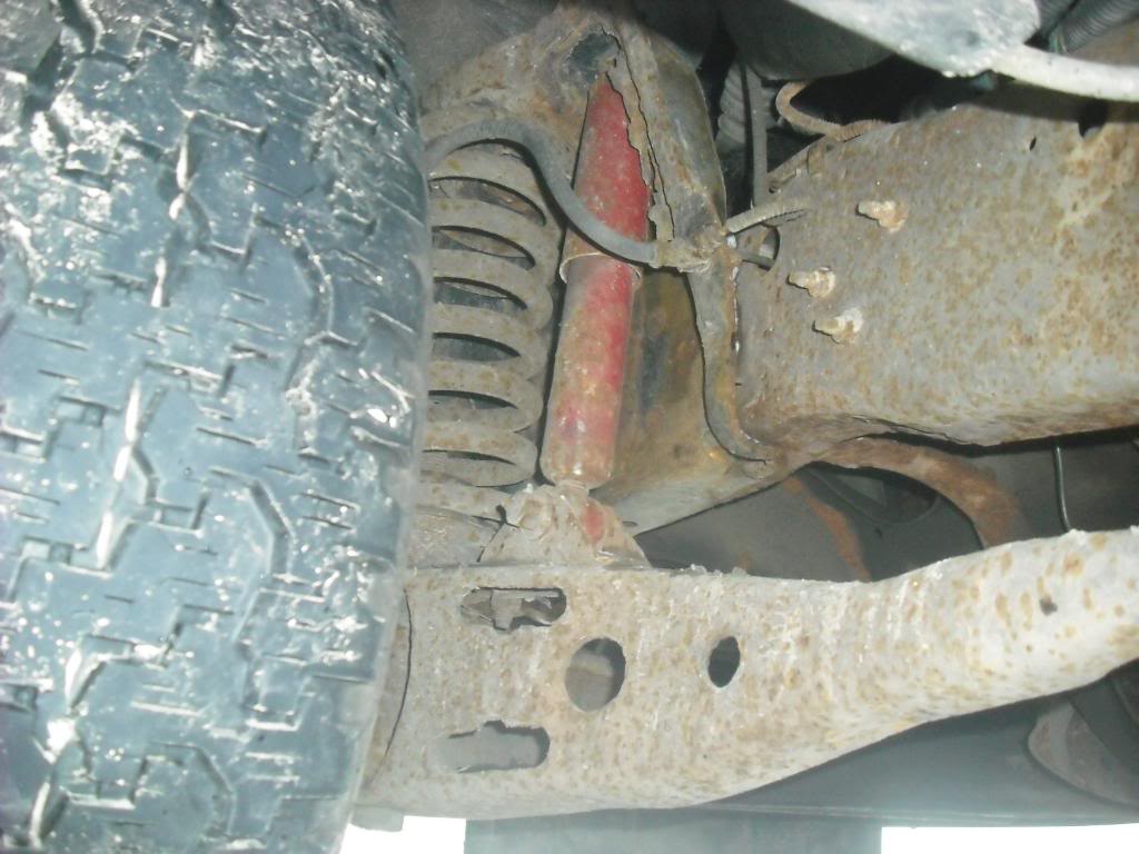

I couldn't get a really good picture of the front wheels bowing because I got it stuck trying to get it in the drive where it needs to be so my dad can get it :/ haha 93 2wd + 2ft. snow drift = stuck.... lol here are some pictures of the front end stuff linkage and what not.

I think maybe your I beam bushings are bad. In the bottom picture you posted, do you see the support bar your shock is mounted to. That is the radius support for the Ibeam. It stops the Ibeam from moving back and forth as you have described. At the other end of it where it mounts to the frame it has rubber bushings in it. That is what holds your Ibeam from moving back and forth, so it keeps the toe from changing. If those bushings are bad I'm sure there is a lot of noise coming from the front end. If it has been that way for a long time the bushings may even have fallen out. But on the other end you will see a threaded stud, that goes through a cup on the frame. There should be a bushing on each side of each one.

It's a very common problem and a pretty cheap fix. But I'll bet you it is the problem. Also notice where your hub mounts to the Ibeam, there are no ball joints. It has King pin that goes all the way from top to bottom. A completely different system than any other trucks. Ford used the system well into the 90s. When ever you here someone bad mouthing old Ford front ends wearing out, it is because those busings I described wearing out and breaking off.
