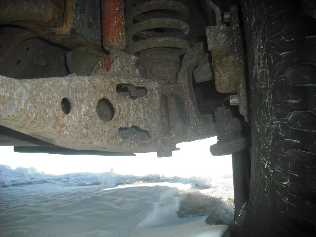

Originally Posted by Tumba
I think maybe your I beam bushings are bad. In the bottom picture you posted, do you see the support bar your shock is mounted to. That is the radius support for the Ibeam. It stops the Ibeam from moving back and forth as you have described. At the other end of it where it mounts to the frame it has rubber bushings in it. That is what holds your Ibeam from moving back and forth, so it keeps the toe from changing. If those bushings are bad I'm sure there is a lot of noise coming from the front end. If it has been that way for a long time the bushings may even have fallen out. But on the other end you will see a threaded stud, that goes through a cup on the frame. There should be a bushing on each side of each one.
I crawled under it today and it has 1 black pushing on the front end side of the truck and 1 white on the back side where the nut threads in, and What do you mean I have no ball joints do you mean where the Radius are connects, Theres a big bolt going from the bottom all the way to the bottom of the coil spring is that what your talking about? does it have bushing that can go bad?

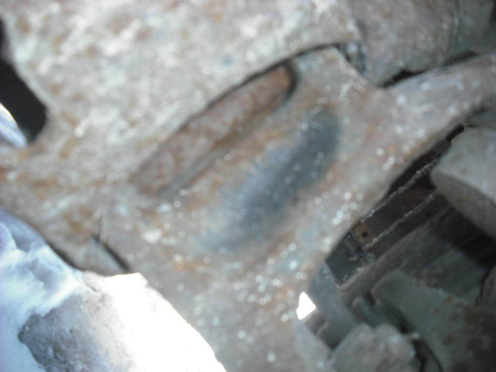

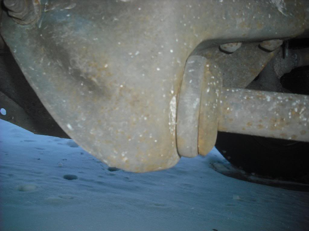

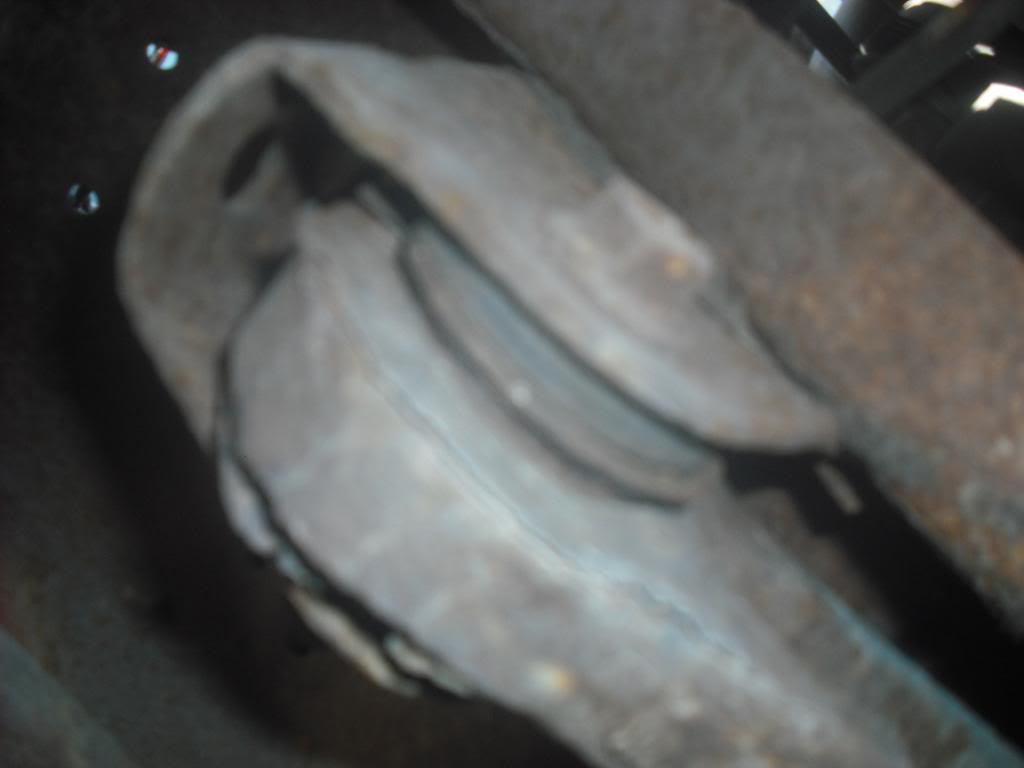

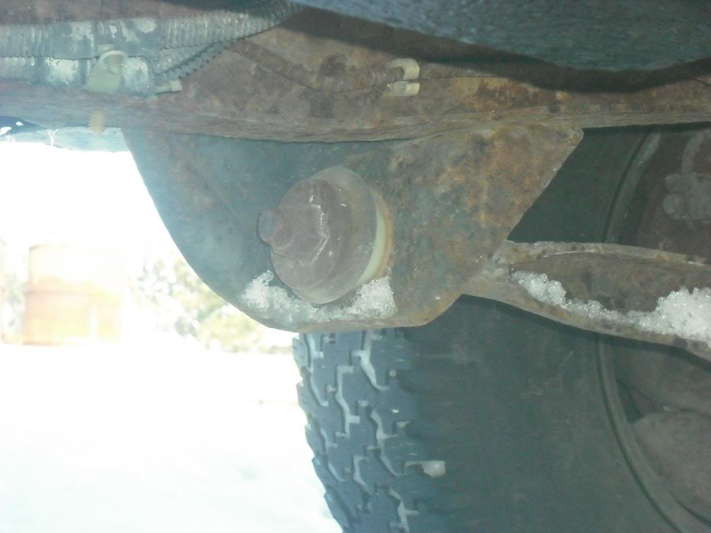

Tannerf150's Avatar
Joined: Feb 2010
Posts: 90
From: Illinois
The front bushing on the passenger side.
the back bushing on the drivers side
where it all connects into the ibeam
Ball joints on the far right and the kingpin on the left.

The radius arm bushings do seem to look OK. Is there any slack when you push forward or backward on the IBeams? That is where I thought the slack maybe coming from.
If you have no slack in the tie rods, drag link, or Ibeams, you should be able to get an alignment that will stop wearing your tires. But you stated your toe in changes depending on the direction you are going. There would have to be slack in on of the above listed parts.
How about where th Ibeams mount to the frame, are the bushings there in good shape? I've never seen them go bad , but I guess it could happen.
The hubs don't have ball joints. Those are just pins, that allow it to pivot. But you said your Father couldn't get any slack while working the tire up and down while on a jack. So there shouldn't be a problem there.

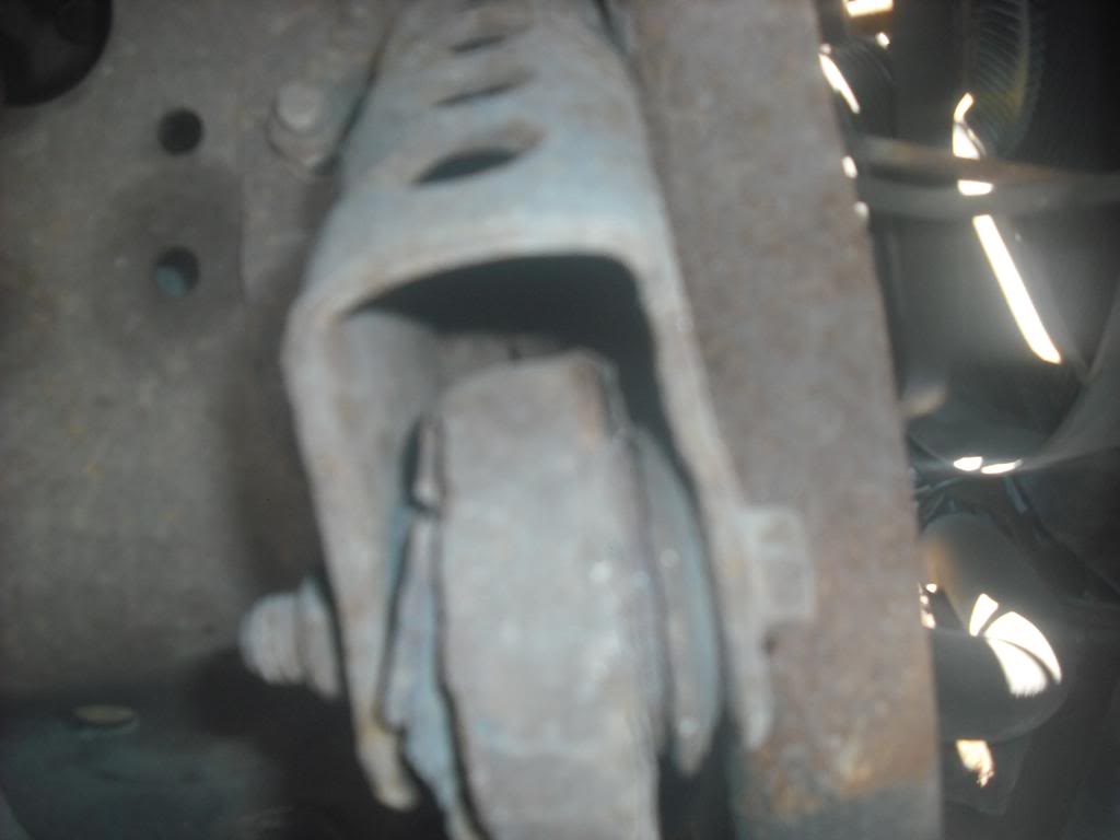

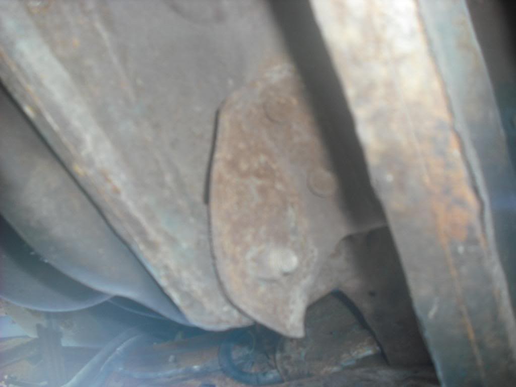

Old Mar 4, 2010 | 01:48 PM
Tannerf150's Avatar
Joined: Feb 2010
Posts: 90
From: Illinois
Here are some pictures of the I-beam bushings where the connect into the frame bracket.... There pretty nasty looking in my opinion.

Well my bushings look fine everywhere, And I have a feeling the 2' lift coil spring inner tie rod and an alignment will fix my problem but any others think different please tell
