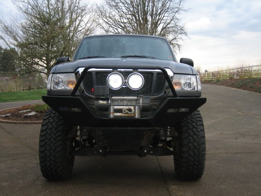

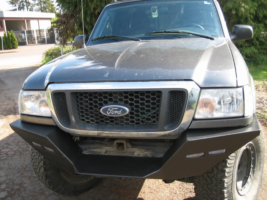

Add a hidden hitch in the front then mount the winch on a hitch so you can move it from front to rear depending on where you need it. That's what I did with my ranger and it worked awesome. I did make a bumper though to house the winch on the hitch, but I'm sure you could mount the hitch in a place that would work to have the winch behind the front bumper.
Without the winch or light bar.
