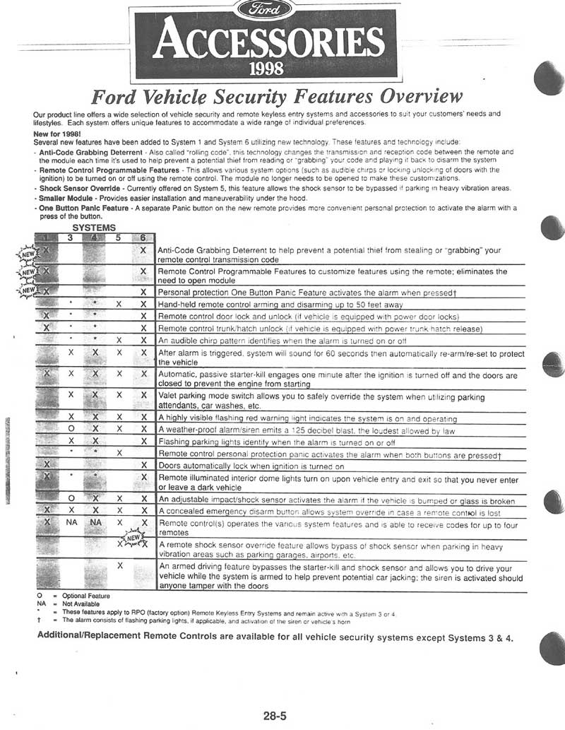

If nothing changes for 2001(from 1999&2000), than an easy and inexpensive alarm solution is at your local Ford dealer.
Since our lightnings already have "keyless entry", we simply need to add the "System 3 upgrade" part #F3AZ-19A361-D(about $90(no shock sensor(part #F3AZ-19A361-F)about $30 or siren(uses horn)) or "System 4 upgrade" (part #F3AZ-19A361-C)about $140(includes shock sensor and siren).
These use the original remotes,RAP Module,door switches,etc.. and turns it into a complete alarm(stater kill, lights flashing, chirps or honk(can be silenced, etc...). This is what the dealer tries to sell you for $400-$600. Obviously they don't tell you this is what they do.
Instructions are great, tells color of wires and where located. Takes about 1 hour to install. The dealer will install(1 hour labor) it if your not handy with tools and a DVM. I've installed one. It's covered by Ford for 12mnth/12Kmiles or the remainder of new vehicle warrenty (whichever is longer!)

Here are links to system upgrades page from Ford catalog. It shows the options in each system.
High Bandwidth version =300k
http://www.svtlightnings.com/svt/how-to/fordsystem2.jpg
Lower bandwidth lower quality version = 100 k
http://www.svtlightnings.com/svt/how-to/fordsystem3.jpg
Dealer gave me price of $151 for System 4
