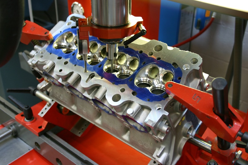

We run a P/S motor in Comp and get about 15 runs out of the frightfully expensive valve springs (close to 5k per set!!). A competitive p/s car turns about 1000rpm higher than we do now, so 3-5 runs per set of springs is probably right. Racing is just a game of who can spend money faster, and if changing springs every single run makes you faster than the p/s guys will do it. Ever hear of Greg Anderson?
By the way, this is a Serdi.
